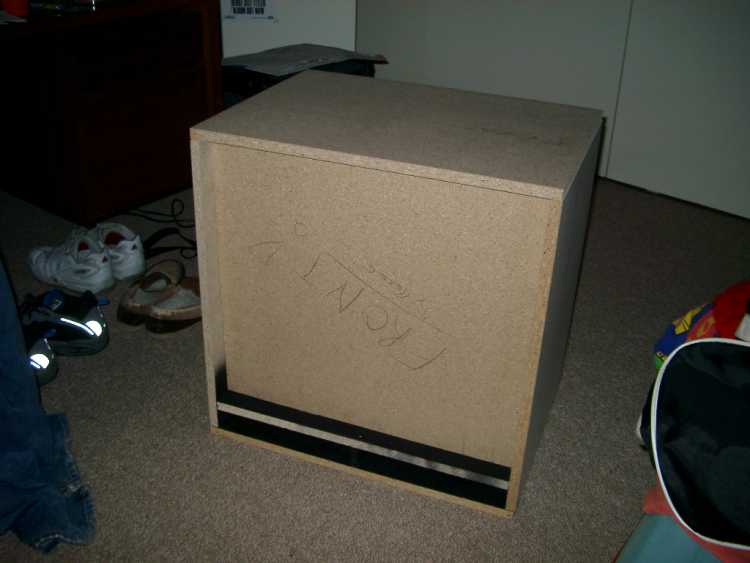

Yeah thanks sangram..... looks like this tweeter shouldn't be too bad after all.... a bit of tweaking will be necessary but shouldn't be too much drama...... I'll defiantly let you guys know how they go. will take a little while for me to complete them as I spend a heap of time with basketball commitments.... but now that I got the cutting out of the way I’ll be able to do some work during the week.... but to finish them completely will take a while.... I like to take my time so things are right and look pro.... I spent ages on my ht sub to get it not just sounding nice but looking awesome too...

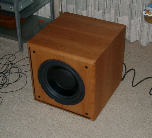

I got a dig cam so I’ll post a pic or two of them when I complete them on here and let you guys know how they went.... probably revive this post by the time they are complete...
o I’ll stick a pic of my ht sub on here too.... just because I’m wrapped with how it finished up and pretty proud of it.... yeah its only a sealed sub but it was my first go at a speaker box of any type and I’m wrapped with what I got.... maybe one day when I not living at home and wont have people complaining about the space I'll pull out the Shiva driver and build a ported enclosure...
Thanks again all...
