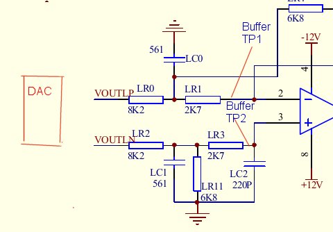

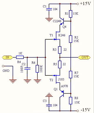

I want to add this buffer to the WM8741 but unsure of the best take off point for the buffer perhaps at the Voutrp at LR1resistor 2.7k and Voutrl RR3 can anyone advice me on the best take of point

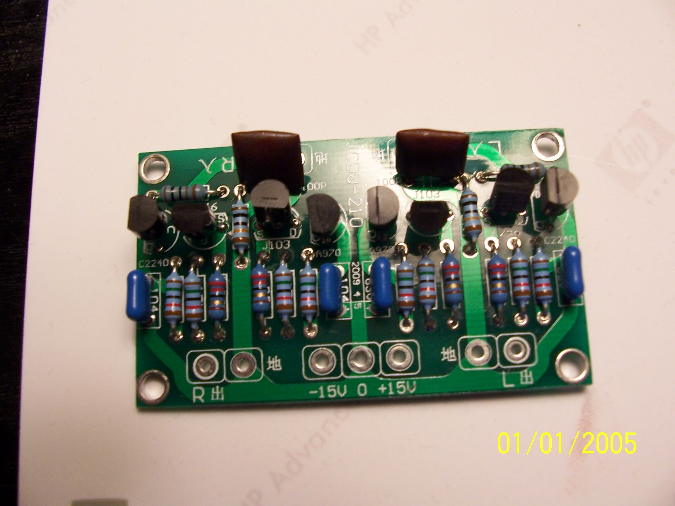

The buffer is this one
hi Colin,
I would get it from the opamp out because the Vouts l&r are balanced at those points and you could at the opamp out point add a volume control,

yes balanced to single ended but unsure of the best place for the take off point if Vout directly off the dac pins or from the 2.7k resistors as showing in the schematic

yes I use this buffer with the AK4396 DAC into a my 6SL7/KT88 SE works very well in my view even with my SS pre amp i am just using a 15volt LM317/337 regulator supply at the moment but plan on something better for the psu

I was just going to take the outputs of the input L/R +/- side of first resistors or first RC filters +/- balanced outputs to fet single ended out
perhaps a quick sketch may help if pos

Broskie Unbalancer
or
Broskie Unbalancer 6n16b-v {google and translate}
Unbalancer needs no input caps, it ignores the mid-rail DC on the DAC pins and takes differential in and spits out SE, with gain, you may have to pad it back doww?
