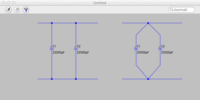

Ok I think I am struggling to get my very basic question across. An easier example: two capacitors in parallel. Look at the below as physical wiring (rather than a schematic - I just used LTSpice to draw because it was faster). Is there a difference between these two physical wirings?

Is there a difference... no. Why ? Because LTSpice has "perfect" conductors. Built for real and they are different because there is resistance and inductance of the wiring and print to consider.

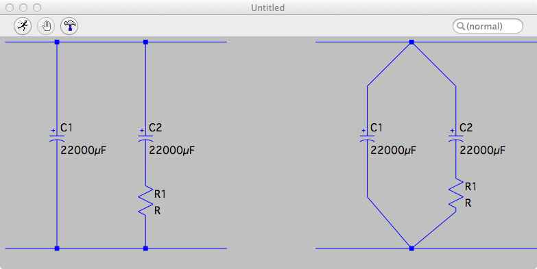

Forget about LTspice. I used it to sketch only. An alternative sketch is provided below.
I have my transformer, I've used Quasimodo (with a scope) to optimise the value of the snubber resistor, I've soldered the appropriate resistor and second cap together, and now have everything laid out on the table before me with my chosen wire for point to point wiring. I need to connect (a) the first cap across the secondaries and (b) the second cap and resistor (in series) across the secondaries. Do I need to place short pieces of wire to space (b) from (a)?
These are small parts. I'm not constrained by a circuit board. I can wire them as either A or B below.
A has 4 solder joints and 6 pieces of wire. B has two solder joints and 4 pieces of wire. In A, the wires I have marked in red can be short or long. As they get shorter, A approaches B. Where physically possible, would one wire as B? Or would one take the time to solder the intervening wires (marked in red)?

I guess the only problem" I am trying to solve is "what is 'good practice' point to point wiring?" If the only difference between these options is the resistance and inductance of the wiring, my presumption is that wherever possible one should minimise wire runs. Physical constraints dictate most things, e.g. the size of the large 22k uF caps and the size of the diodes. When it comes to fitting the snubber parts it seems there are several options. I was wondering if there were guidelines as to cleanest, best practice.
With rapid transients (where the rise time is fast) and with RF interference and oscillation, good practice doesn't always mean what you might think. I'll give you one extreme example. Take an old analogue TV and aerial system. You would think that applying a shorting link from coax lead inner to outer would remove all the signal. It doesn't. On some channels in the band the signal amplitude increases dramatically, on others it falls. Thats an extreme and perhaps not very relevant example but what I'm trying to say is that the cleanest supply might not result from what you think is the best way of wiring it all up if any spike or interference happen to fall within a "band" where your particular layout renders the filter ineffective.
Lets be practical... with an RC snubber on each diode and an RC filter across the secondary you are 98% sure to cover most issues. Also the ca values you are showing are applicable to the reservoir caps (22000uf) rather than snubbers and filters which are normall in the 0.1uf region)

Correct re capacitor values. What I mean is that the sheer size of a 22,000 uF capacitor requires that two in parallel be installed with connective wire - wiring the respective pairs of pins together directly isn't practical. The snubber components - a 0.01uF capacitor, a 0.15uF capacitor and a resistor are small enough to provide for different options (spaced, pins connected directly, on separate platform, over the two diodes where the secondaries attach to the diode bridge etc). As with most things in life, there are many ways to skin a cat but some are considered more practical, more elegant, more effective and more efficient than others.
I thought we were talking all snubbers (post #78)
22000uf reservoir caps... you don't add any series resistor to those. Because the charging currents are so large (tens of amps) with 22k caps I would wire both separately back to the rectifiers. It would also do no harm to add a 0.1 + resistor across the rails as well as the large caps.

So in your diagram post #83 I would go for the one on the right to minimise interaction of the charge current of the caps.
Thanks a lot. I'm still trying to understand how the configuration on the right "minimises interaction of the charge current of the caps."
