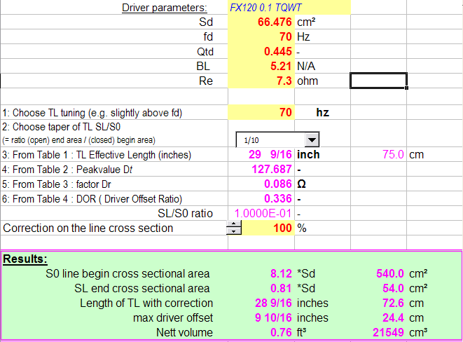

No I have not resolved the issues. If you remember one of the post where I asked about the dimensions I was getting. I got them from the excel work sheet. Then you said you where getting different measurements. That issue still exists. I have no clue as to why they are so off. I expect height to give one the TL length needed not fatness as that will only give you volume. The original design I am basing mine off of are about 14 inch depth and 3 1/2 ft high which seems right to me and I am getting nothing like that. Instead I am getting a very square type box. No GOOD.
OK, which Excel WS? Henkjan's or the one on MJK's site?
Regardless, not having worked out the Seas's TQWT average reverse taper, here's an example of a 70 Hz 1/10 taper (AKA 0.1 in MJK 'speak') using the FX120's published and necessary derived specs and hopefully when you input these values you'll get the same results. If not, then the SS is corrupted.
From this we see that the 'as built' axial line length is 28.56" with a theoretically ideal driver offset from (SO) of 9.625". The top closed area (SO) is 540 cm^2 and the open end 'vent' area is 1/10 this or 54 cm^2. Using CONVERT or other conversion program, this equates to SO = ~83.7"^2/SL = ~8.37"^2, so strictly for purposes of example, making its cross sectional area (CSA) initially square, its width/depth = ~ SQRT 83.7 = ~9.15". I prefer to use either the golden or one of the acoustic ratios for cosmetic reasons, but being well damped to smooth out the pipe's upper harmonics it doesn't matter like it does in large vented, sealed cabs. The main thing is not to make width:depth a very high aspect ratio (> 9:1) due to potentially rolling off its LF output too much when combined with stuffing.

Seems my knowledge is very limited. I have just about the same thing you just posted, but the other points you make are where my knowledge ends. I will post what I have. Now, where my confusion is the second page where it is suggesting measurements. The values are a square box. TO see what I am talking about look at cabinet measurements. Anyway, I will look into what you have written and come up with my own measurements.
Thank You
OK, your differing dims on pg. 1 are due to your rounding up of Sd, so not an issue.
WRT pg. 2, I forgot there was one or I would have used the same aspect ratio for my example to make it less confusing. Sorry about that.
Regardless, as you can see, with such a short line there's no way to get even close to the proportions of the Seas pipe, though it will at least have a similar one if you don't fold it. Just fill the leftover rear cavity with damping to keep it from resonating.

you mean in my Excel sheet? simply the length times the average cross section of the line (using the values just above it in the green results box)(not sure how the listed 0.76 ft^3 Vb was calculated)
Thanks, understood (now), but at the time I'd forgotten about pg. 2/folded in my haste to move on, so calc'd just the net unfolded pipe Vb........
Regardless, both Vbs sim close enough to identical, so it's academic.

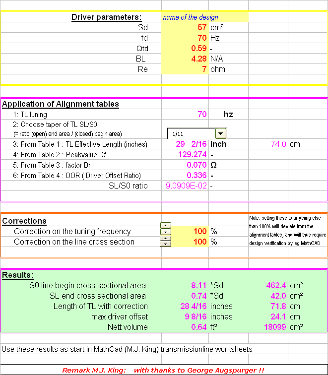

I have updated the sheet with the corrections in a separate box and default tuning=fd

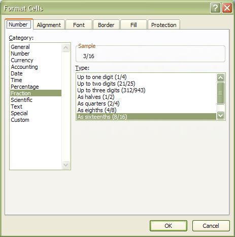

O and you can easily have excel do 1/16. I have uploaded pic to show.
Also not that one can do a custom format and use "# ??/32" for 32 or "# ??/16"(same as what pic has only custom done). So for 48th as GM asked for one would need to use custom and use "# ??/48". Plz, note that this will always do it in what ever denominator picked and will not do any reducing for example 8/16 = 1/2, but will show up as 8/16. There is no easy way around this, but it is not a big deal anyway. It just might bug some people. Let them get over it.

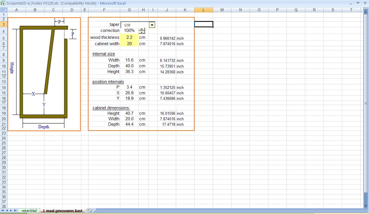

Hello,Seems my knowledge is very limited. I have just about the same thing you just posted, but the other points you make are where my knowledge ends. I will post what I have. Now, where my confusion is the second page where it is suggesting measurements. The values are a square box. TO see what I am talking about look at cabinet measurements. Anyway, I will look into what you have written and come up with my own measurements.
Thank You
how did you invert the box shape on the second page of the Sheet as you have shown In the second figure.
