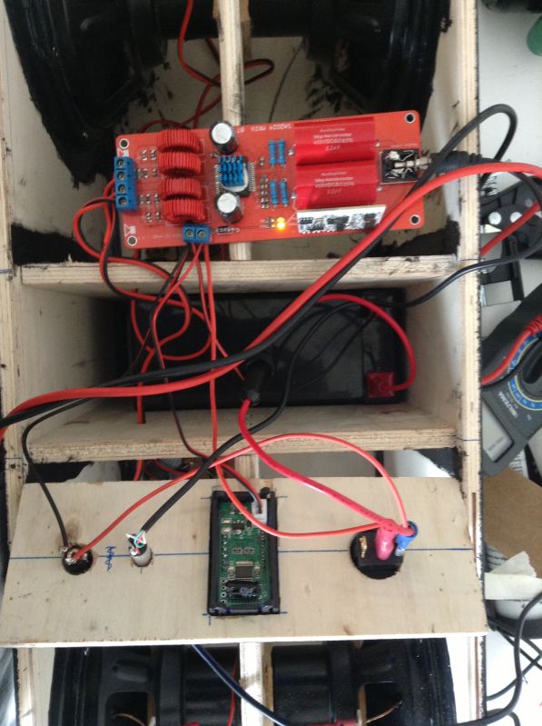

I had this exact same problem! My solution to the problem was to actually block the springs inside the 3,5mm jack using some small pieces of metal and solder. This way, the bluetooth connection and the minijack are actually paralleled all the time. I had some doubts as to whether it would function properly, but after one month of use I haven't stumled onto any problems! I use the bluetooth and minijack interchangeably. When bluetooth is on but I plug a minijack in the external connector, the signal drops instantly (you can hear the bluetooth music continue, but at a very low level). I then just disconnect from bluetooth on the source unit. There is no interference from the bluetooth (that I can hear) when using minijack. The bluetooth however has a lot of noise, so it's only suitable for loud listening levels which covers it up. Some might call my solution a bit "unsophisticated", but without proper soldering tools or skills, this was my only option.
Take a look at the minijack in this picture and see if you can spot the solder.

Wouldn't it have been easier to solder the pins together on the opposite side? Or have drilled a hole in the electronics compartment matching where the amp is mounted and avoid the whole problem (pun intended). As I recall the amp can be mounted vertically next to the battery so the hole would have to be in the top, or horizontally so the hole is in the side.

As I mentioned on the Boominator thread, soldering the pins worked fine. The audio cable is now permanently connected to the amp (on the other end, it is terminated on the dish using a 3.5mm input socket), and that no longer has any impact on Bluetooth, which is always active now (it takes precedence over the input from the audio cable).
Thanks for your suggestions.
