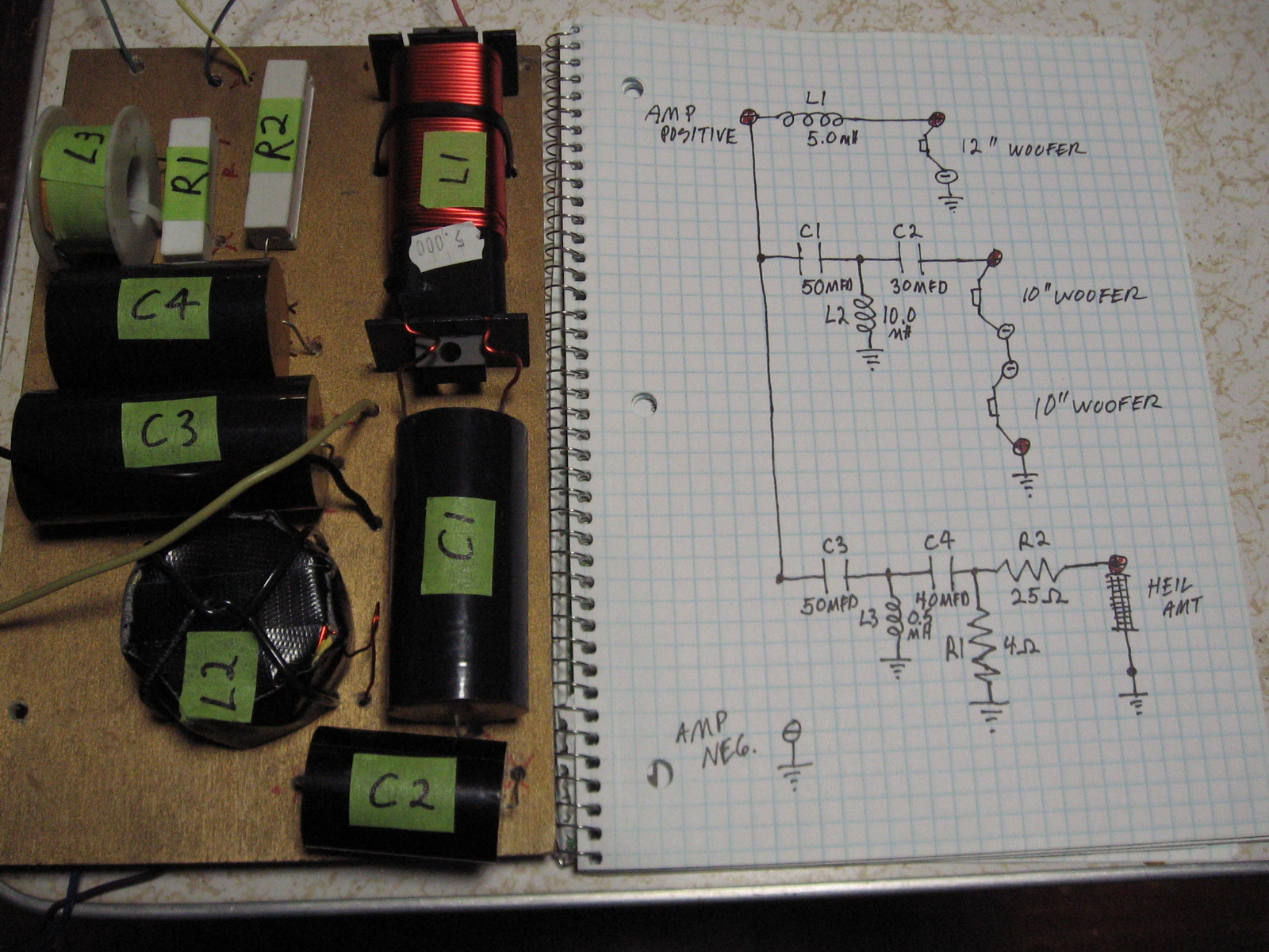

For now I am only considering passive crossovers. The 12" woofer is a 4 ohm unit with a single 5.0 mH coil wired in series.
An advantage of the higher impedance series connection is I can use much smaller capacitors where needed. The bass of the system is much better without a cap in line with the 10s. The problem is that I also play records often and sometimes loud, and the 10s respond to the subsonics. Even with a 200 mfd cap, the resultant response produces a dip in the 180hz region, and there is a slight peak at about 300hz.
For the Heil amt, I used series resistances to match output levels and the higher impedance of the 10s. The high pass section is a scaled up version of the original ESS Heil amt1, so it uses smaller caps and a larger coil, with an additional series cap to touch up the response.

Where have you set the crossover between the SEAS 10 and the Heil?
Sent from my Nexus 6 using Tapatalk
The latest version crosses over at about 180hz from 12" woofer to the two 10" woofers, (1st order low-pass, 3rd order high-pass); then at about 1khz for the cross to the amt (3rd order high-pass, natural roll-off on the SEAS 10s).
I also put a section of 3" high density foam in the center of the 10" woofer boxes with a 1" layer of polyester in back of each driver.
I went back to 4 ohm loading of the tweeter for now, it seems to blend better with the 10s at the crossover point. R1 gets pretty hot at high volumes, though.
Sound is really good now, though I was hoping for more sensitivity in the low bass. So possibly dual poly 10s or 12s would work better here.
--Greg

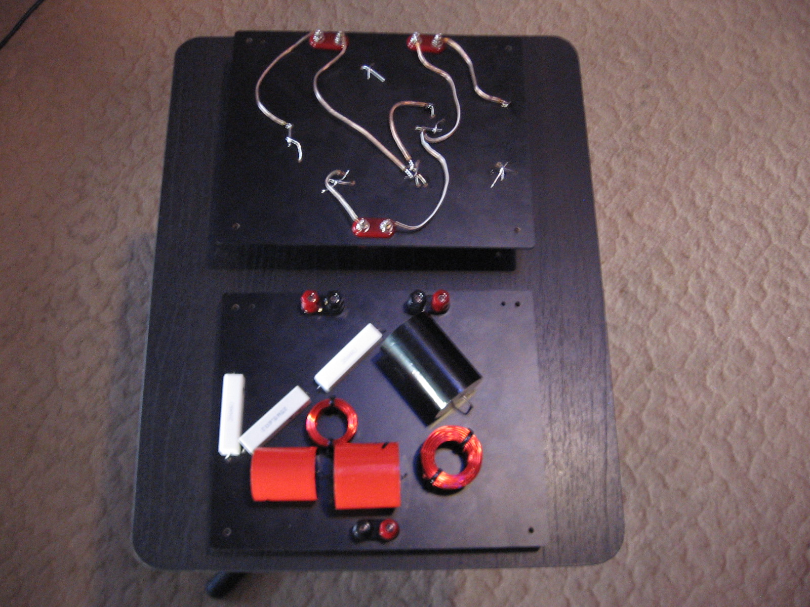

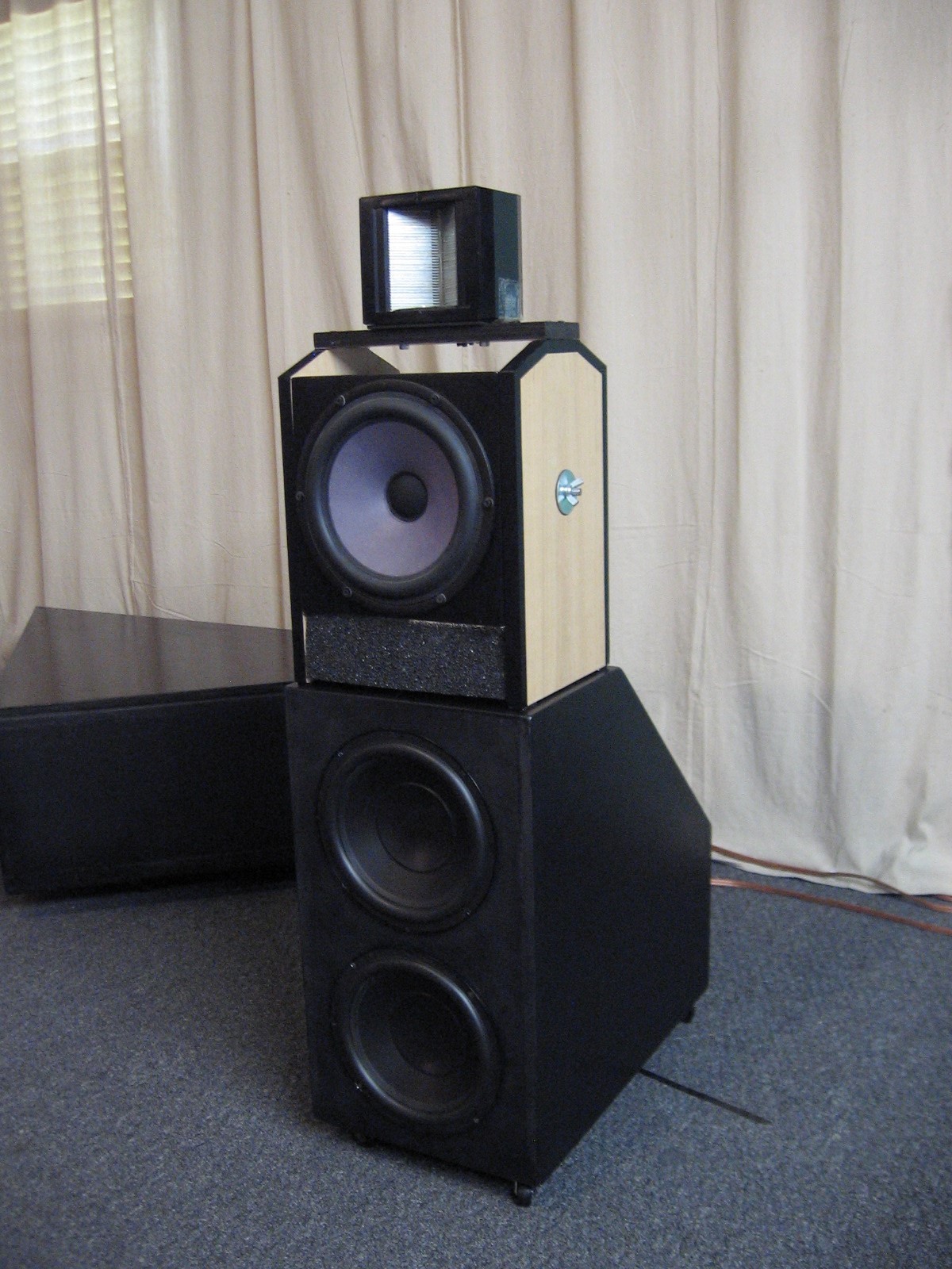

New bass enclosures
I went with dual poly 10s, 3 cu. ft. vented box. The crossover is now back to one similar to the AMT 1, with a 2nd order low pass in line with the two SEAS woofs, now wired in parallel. The two Misco poly 10s are wired in parallel, with a 2.5 mH iron core coil in line. The SEAS 10s are now allowed to roll off without a high pass filter for the initial listening tests.
Still working on 'em...
SEAS woofs rolling off naturally on the low end, 1.0 mh coil, 70 mfd cap + 4 ohm resistor for low pass
2.5 mh coil (not shown) in line w/lower bass units...
