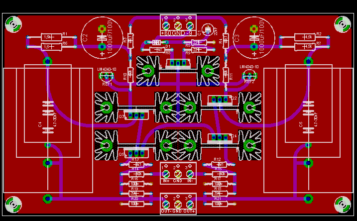

Here's a pic of the boz pcb. I just need to process it in CAM350 for a final check and add the last text to the silkscreen.
BOM:
R1,R2,R6,R7: 1,5k 3W
R3,R4: 22
R5,R9,R12,R13: 221
R8: 27
R10,R11: 50k
R14,R15: 10k
R16,R17,R20,R21: 100k
R19,R18: 39k
Q1,Q2,Q3,Q4,Q5: IRF610
REF1,REF2: LM4040-10 or any other 10V voltagereference
C1: 22uF
C2,C3: 1000uF/100V
C4,C5: any polyprop cap between 4,7-30uF, pick what't you think is best
D1: 1N5235B
If you choose not to cascode you can omit R10,R11,REF1,REF2,Q2,Q3. You also need to short Q2,Q3 D and S.
/Kari

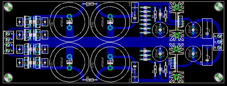

And here's the pwr pcb.
BOM:
D1,D2,D3,D4,D5,D6,D7,D8: Choose whatever you think is best. There is room for ex. 1N4004 and also for TO220 diodes.
C1,C2,C3,C4,C5,C6,C7,C8: Snubber caps, rm 5mm, you can leave these out. Here you could use for ex. 100n caps.
C9,C10,C11,C12: 4700uF/100V snapin type, also here you can choose some other value, as this is snapin type almost any value can be used.
C13,C14: 0,1uF, rm10mm or 15mm pitch
C15,C16,C17,C18: 220uF/100V
C19,C20: 1uF, 15mm pitch
R1,R2: 27/2W
R3,R4: 1,5k
R5,R6: 221
Z1-Z7: 9.1V Zener
Z8-Z10: ~4,5V Zener (Choose so the total would be ~14V
Q1: IRF9610
Q2: IRF610
/Kari

And boy, I like that pic Cant wait to see how it looks with those big fat 30uF polyprops on it, and loads of big Fischer heatsinks. That is one cool preampHere's a pic of the boz pcb
Steen.
Re: volume
Actually the BOSOZ design does not have any pots in it. The potentiometer on the front end and back end are input and output attenuators and are not part of the circuit per se. The Potentiometer at the P5 is an averall gain adjustment that can be replaced with a jumper and changing the fixed vale of R15 which is in series with P5 and fixed at 150R. I found that a 430R resistor works bext here for about 12dB gain, just like NP suggested in the orignal design.
For a volume contol a 5K stereo stepped ladder attenuator on the output is best and is what I will use in Kari's design.
Regards
Anthony
lgreen said:I hate to be a pain but...uh.... where's the vol control go? My bosoz has like 5 pots in it, and this one doesn't appear to have any.
Regards
Anthony
