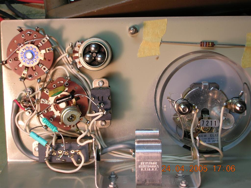

Back on topic, I measured the current through the emitter of one of the KSA992's and it was 3.8 mA. So not even close to 1 mA. :(
Administrator
Joined 2004
Hi sonidos,
Time to begin looking at resistor values and connections. It's entirely possible that an error was made in the 1970s and the meter wasn't much used as a result. Now, this same issue rears it's ugly head again.
The major difference is that you now know where the problem manifests itself. That means you can look over the schematic and figure out what might cause such a thing. I have included a picture of what my meter looks like inside. No, I didn't build this one, in fact I find the use of a single colour for wiring a bit confusing. Having had to trace many items in order to find a fault, I generally do use multiple different colours of wire.
I hope the photo helps you find a problem.
Joined 2007
Super!
Anatech,
A picture is worth a 1000 words. Mine is wired backwards too! We're almost batting a 1000 here. BTW, I paid $40 for mine. Yes, I've got plain vanilla white wire running throughout the unit, so I'll see if anything needs to be rewired. I won't be excessive on changes, of course.

Right on! I'm really glad that helped you out. With any luck, others with problems can sort them out by looking at the picture.

Folks - I'll let you know about how my IT-18 works after turning that switch around.

Thanks for the tips! I turned the switch around, got everything wired right and the values are falling into the right range. I tested some small signal transistors, drivers, and power transistors. Looks good! I still need to check that everything is working fine internally, but at least I'm on the field now.
One thing that this unit told me is that a couple of power transistors I tested are probably fakes. I bought them from another source (MCM) and the silk screen is different from the ones I purchased from an authorized distributor.
