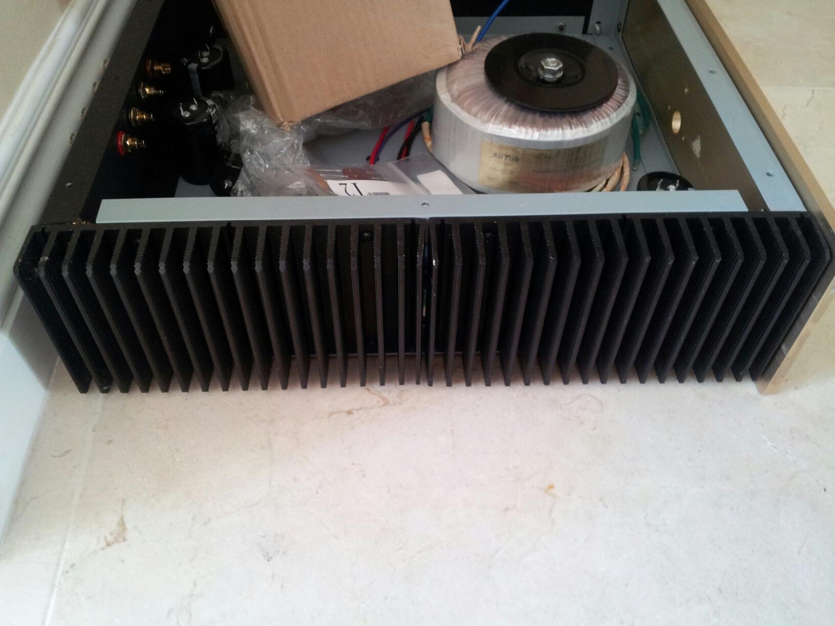

Dear All,
I am in the process building Aleph 30
So far I have lying around chassis with heath sink size 15x4x1.5 inch
I calculate using Elliot Sound product come out .2123 c/w
I believe this req .25 c/w
Do you think is enough? if not, what is the actual size needed
tks
The heat sink size is for one side
This will be for stereo
Any input please.... tks a lot
