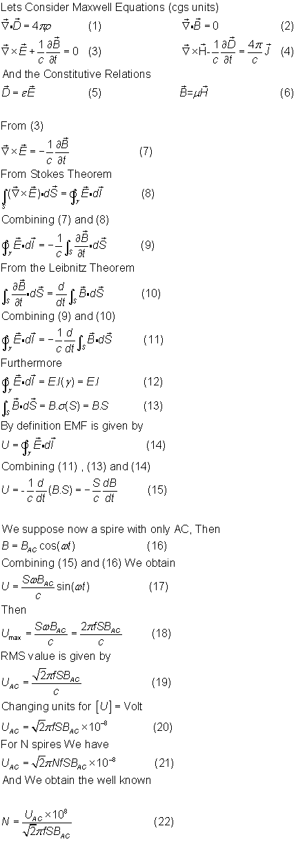

It depends on frequency. At 60Hz the magnetic field created by an AC voltage is very small. At 60MHz it is a million times bigger, because the magnetic field comes from the time differential of the voltage.
Hi DF96
B(AC) = [ U(AC) x 10^8 ] / [ sqr (2) * (Pi) * S * f ]
If U(AC) is fixed, I would say it is the other way around.
I hope it's a typo.
Best regards
Johann
Any current generates a magnetic field, both AC and DC. So an AC current generates an AC field. In addition, an AC voltage generates an AC magnetic field.
Can you explain better, I think slowly and still do not understand.
With math, please, we are talking about physics, not philosophy.
In post # 36 I took the trouble to do all the calculations, and I'm just a TV repairman, I can not expect less from you, having a Ph.D. degree.
If you're right I will apologize, as appropriate between gentlemen.
Best regards
Johann

You do not know even write correctly Maxwell's equations.LOL
Where did you study physics?
That's not what I asked, the equation you mention is one of Maxwell's equations, but badly written, the magnetic field is H, not B, and the electric field is D, not E, J is current density, not current.
If the medium is not "homogeneous and isotropic", you can not treat epsilon and mu as in high school.
If by "time differential" you mean "time derivative" is also incorrect, because that is a partial time derivative.
See Eq (4) in the attachment, there is well written.
Oh! BTW, mind you, just in case that curl ( ) = [nabla operator] x ( )
div ( ) = [nabla operator] . ( )
Change in system of units is irrelevant.
I think you must use another more serious reference than Wikipedia.
I can understand that you confuse E and D, B and H, is quite common, even in textbooks, but I can not believe that you confuse derivative with differential.
Where did you study mathematics? or is the language barrier?
As I said, the magnetic field has two 'sources': current and rate of change of voltage with time. I say 'sources' rather than sources because Maxwell's equations do not specify causality but merely equate things.
Again WRONG, see te attachment, Eq(4), what you call current, is the current density J, and what you call rate of change of voltage with time, is the displacement current: partial time derivative of D.
Voltage, not rate of change of voltage with time, is implicit in Eq(3), as I showed in Eq(7)...Eq(20)
