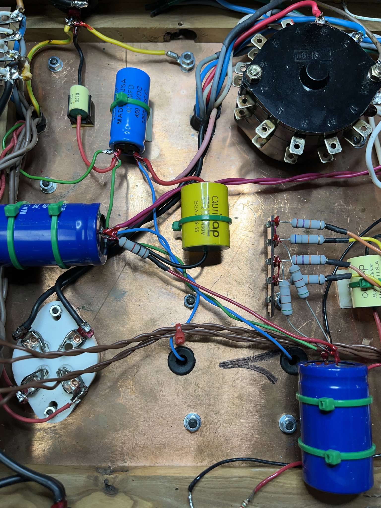

I bought an amp a couple weeks ago. Heard it played through a pair of VERY pricey Tannoy speakers (99dB sensitivity), no noise, just bliss.
TEKTRON TK2 2A3/50I-S(ET). It was - after some emailing to Don Corby of Corbysaudio.com and his query to the factory rep - a dealer DEMO model, probably 20 years old. NO schematic available. I’ve looked at dozens of schematics, found one VERY close to TEKTRON’s (Don did get me a copy of one from the factory dated 2015, which, while CLOSE, has some major differences from the prototype).
This seemed like a bargain at the time, and it IS/WAS. With a NEW set of EML 300b tubes courtesy Scott Bierfeldt of Verdantaudio and financing it sounds even better than it did with the 21 year old Sophia 300b/2.5v tubes it came with but…
there’s STILL a little bit of residual hum despite bias adjustment. Not enough that it’s noticeable with music playing, but JUST enough to annoy me. It’s 120 Hz (definitely, did a sound sweep with an analyzer and then a tone generator, it’s exactly that).
So, I’m contemplating running the 300b filaments as DC but… the cathode bypass cap on the tube(s) now (defunct Tech-Cap) is polarized

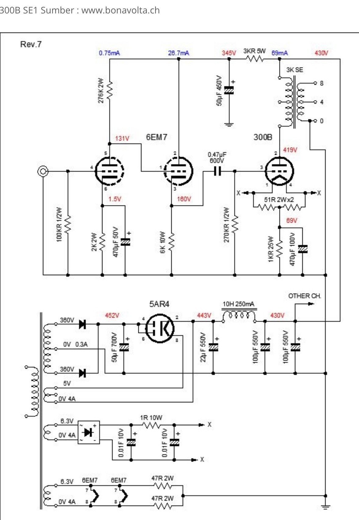

As you can see from this schematic - and many more - the bypass caps are usually shown as bipolar. IF, changing ONE thing at a time, I were to add in a DC filtering circuit like this:

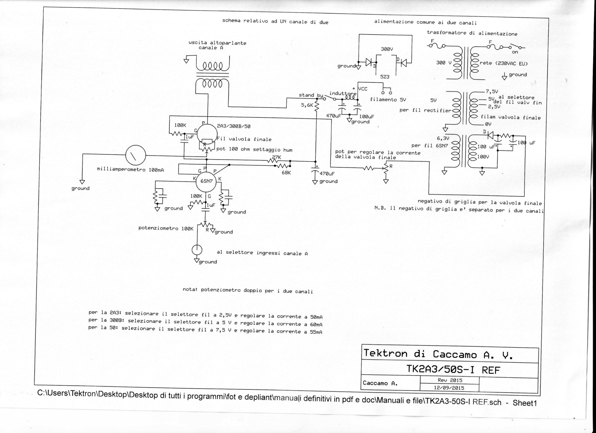

vs. schema originale /OEM factory schematic:
Differences in my amp: no meter, NO negative grid circuit through potentiometer as shown bottom right, no standby circuit. For orientation, smack dab in the middle of the drawing is the 470 uF electrolytic less the 1k 25W panel mount resistor.
QUESTION:

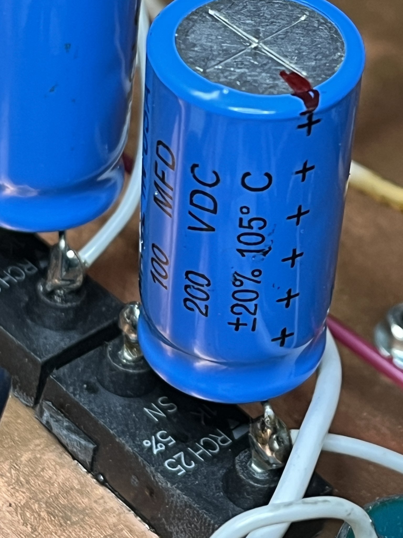

1- Does the polarity of “X, X” matter with respect to the bypass capacitor’s + terminal pointed to the heater bias pot (ground is ground)?
Meaning, for now, I leave the ORIGINAL caps in place, add the DC heater circuit, and see what changes?

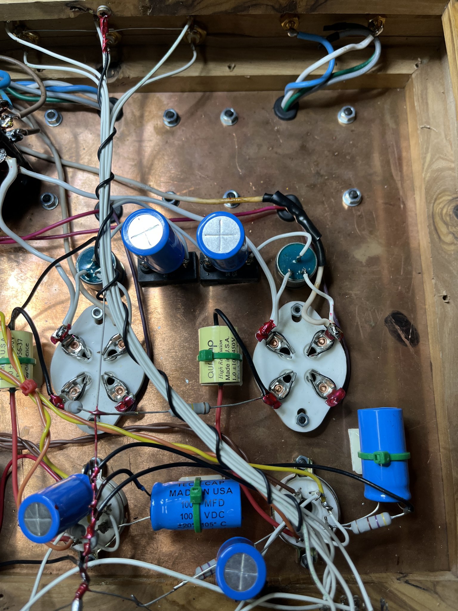

BEFORE doing this, I will recheck wiring, twist the AC pairs a bit more, reroute as necessary, but even though the EML’s cut the hum about 3dB (still audible at 3 feet), the possibility of reducing it to zero intrigues me.
Thanks in advance.
Norm

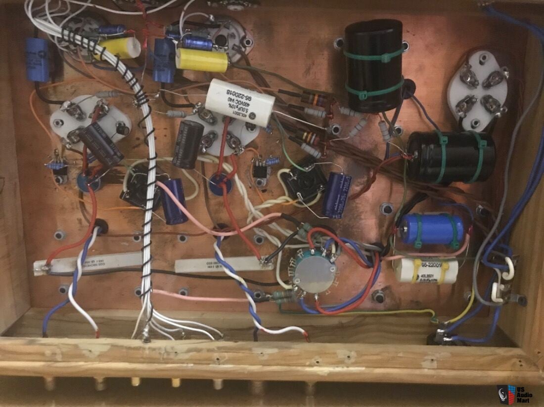

One last photo, this from an extensive websearch for the amp I came across last night.
Looks like this HAS been done to THIS model amplifier, but there’s some loss of detail, and the capacitor between the filament and the grid is curiouser and curiouser.
I wonder how well this worked out.
