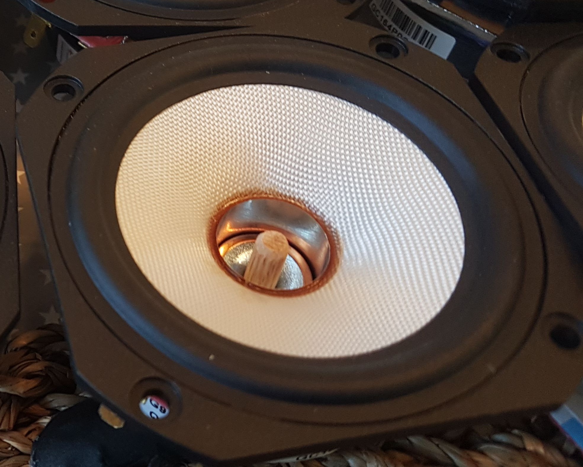

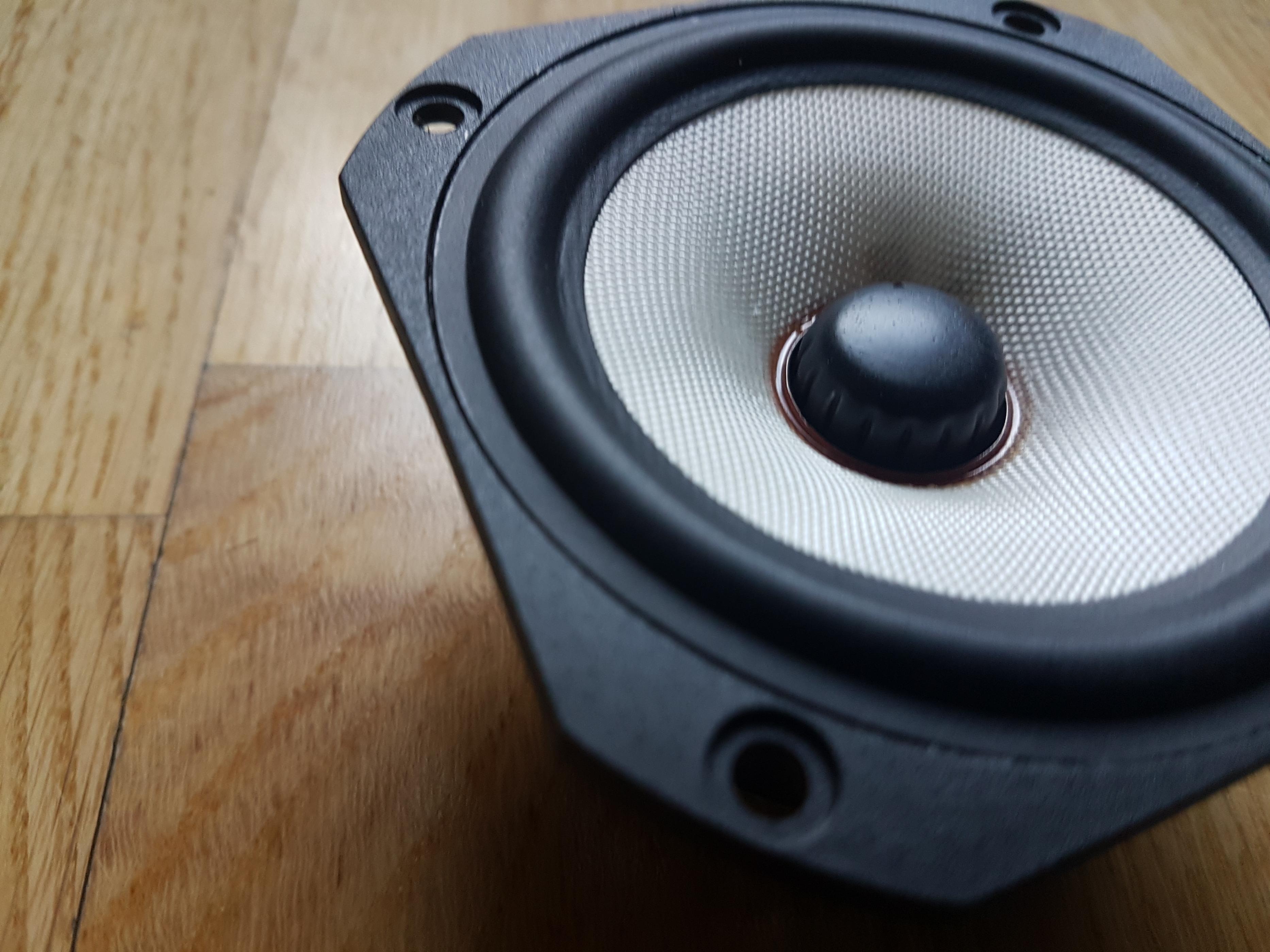

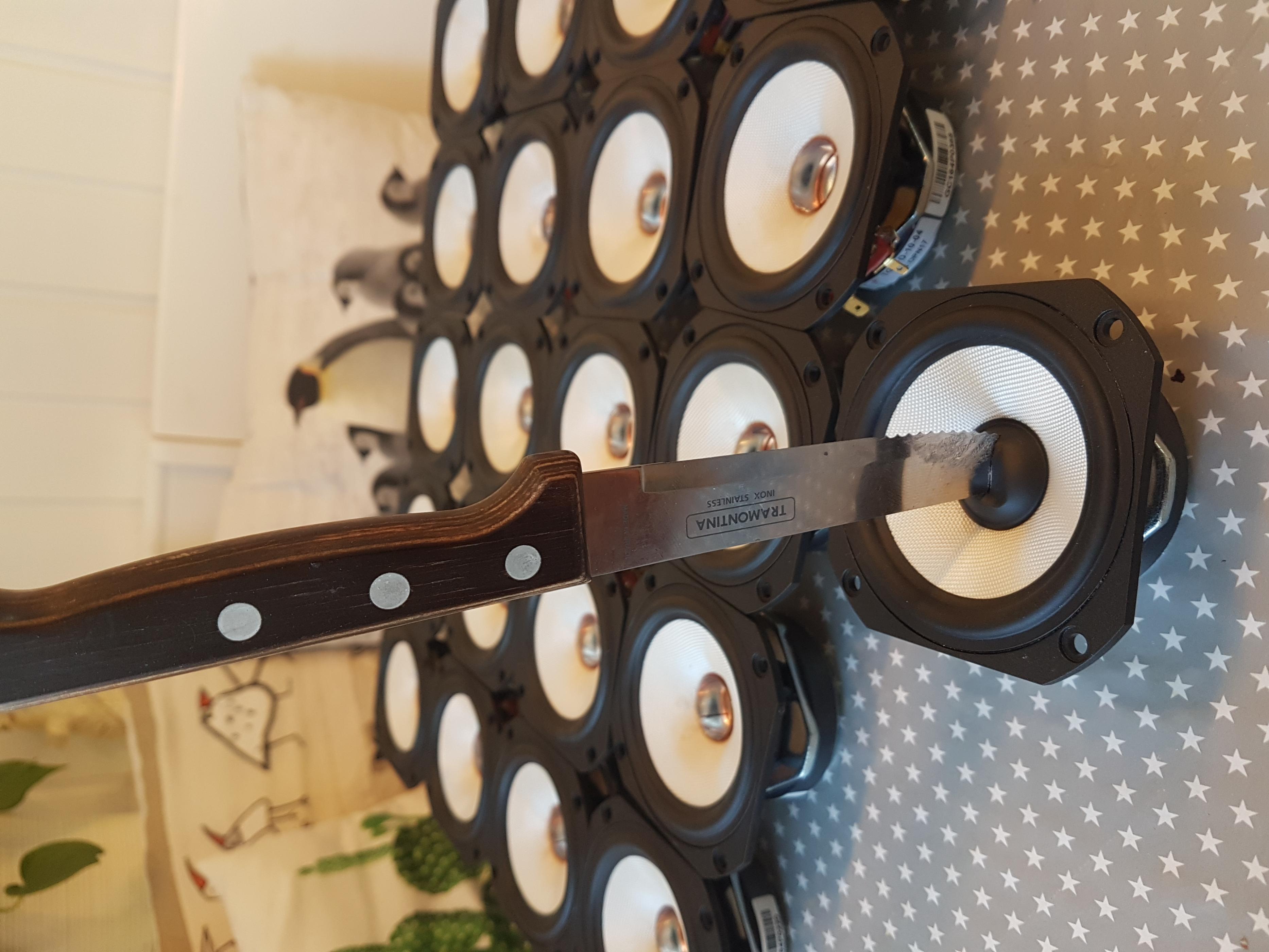

Member "5th element" generously shared his impressions, tweaks and measurements with me regarding TG9. Hence, I bought 50 from Madisound for my next line arrays.
3d. and 5th harmonic distortion raise quite a lot from 500 hz and down. The void under the cap is a relative big chamber in front of the 6mm "pipe". The cure was to add phase plugs. How could I ever collecting bags of patience cutting 50 wooden plugs by knife, hours and beer? Nope.
The solution was some guitar volum knobs spray painted by Plasti-Skin (same as PlastiDip) and 30x 6mm wooden spline dowels and a drop of glue, just to secure. Luckily, both the knobs and dowels dias are 6mm, fitting the hole in pole piece precisely. In other words: Mostly Lego. Knobs are plastic, not disturbing any field. Warning: Scary pictures !
