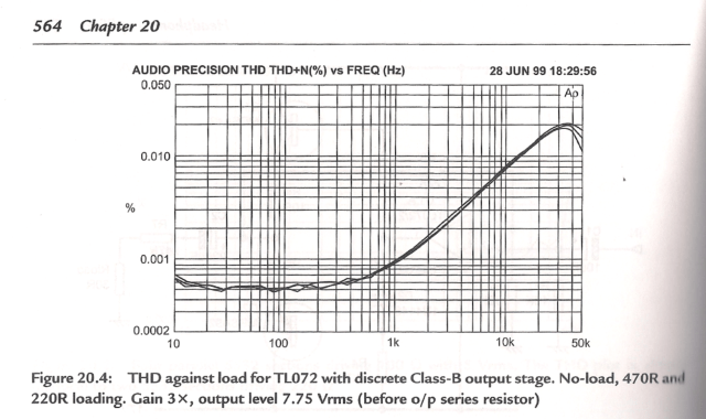

The schematic from Rod Elliott works, but it certainly is not "what some of the better headphone solutions are these days". It seems to have been around forever and published many times, including by Douglas Self in his Small Signal Design Handbook. Mr. Self actually measured the distortion of it:
The 20dB/decade rise of distortion is a manifestation of the loop gain falling with frequency, and of not-so-linear output stage in that loop. With an NE5532 instead of the TL072, it would a few dB better. This kind of distortion has a sonic signature: unnaturally tight and punchy bass. glassy mids and highs, and amplified sibilants.
In his book, Mr. Self also demonstrated how to make it a bit better. But, if you want something really simple, just use an OPA1688 - with a 70mA output current limit, it may be a little challenged with low impedance IEMs, but 32ohm and above should be ok. Otherwise, it probably will work the same as Elliott's, without the complexity and with a much wider power supply range.

The ESP circuits were some of the first I tried in audio more 15 years ago...At the time my best audio equipment was a crappy radio cassette player...but anything I tried at the time from ESP was at the same quality level as the proffessional equipment some of my recording engineer friends had in their rigs as I could get to check it on their studio quality headphones and speakers.Today's proffessional soundcards still have simillar if not worse headphones amplifiers than this simple circuit.Yes adding some current sources to bias the output trz may improve the circuit a little bit, having faster transistors or op amps, using much more complex topologies can technically do it, but hearing that improvement is a different topic entirely.
Even though a lot has changed over the last 15 years, plenty of people are still arguing that there would be no audible benefit to lower distortion. To verify that claim, you just need to try it yourself. It is an interesting experience, and you may be surprised. Just make sure that the distortion actually measures low across the whole audio spectrum, not just at 1kHz.
