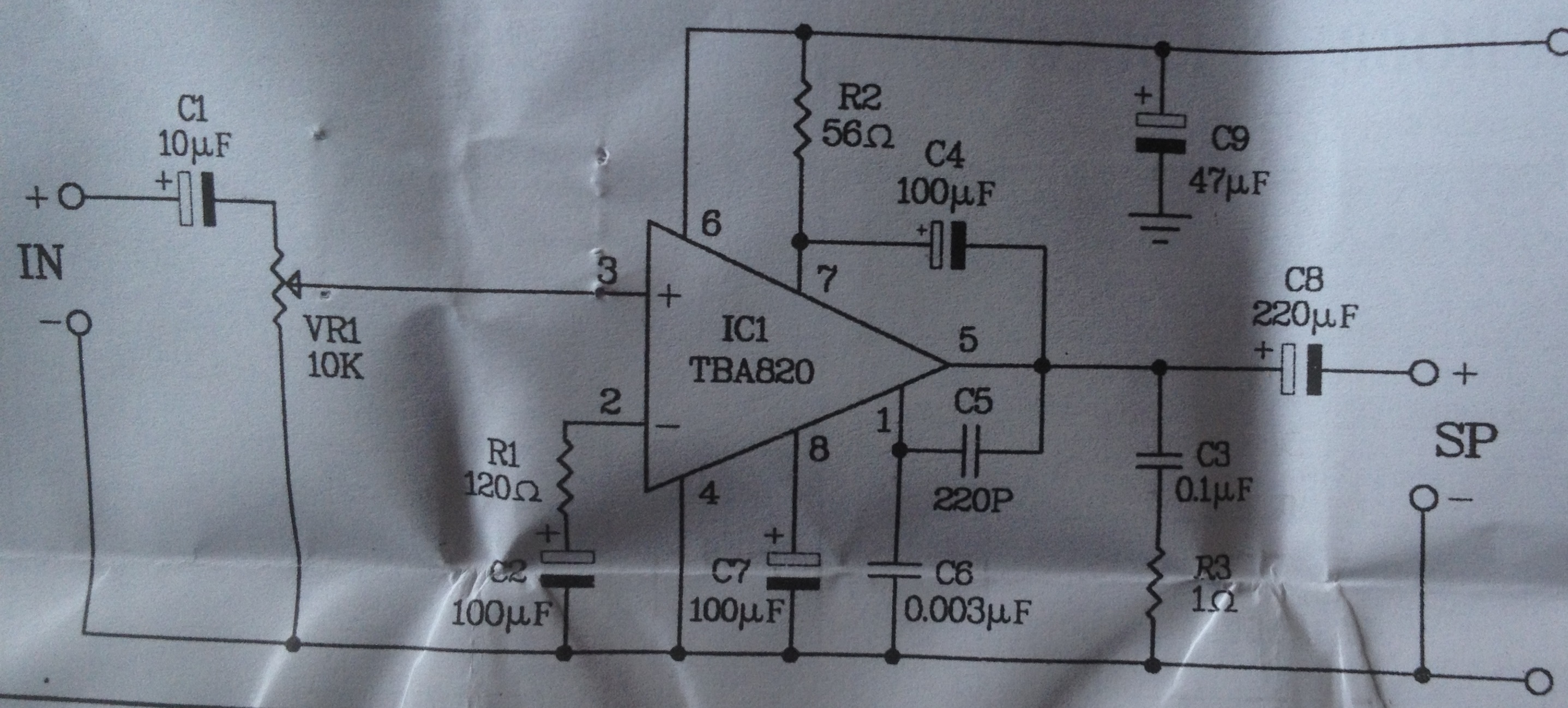

Use an opamp/transistor voltage buffer on the output after the DC blocking output capacitor to increase the impedance and you can get away with a MUCH smaller and better film cap. You can probably make a buffer smaller than a 1000uF capacitor...
