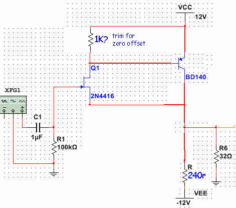

Personally I have 32 Ohms headphones. When impedance is 32 Ohm and lower, there is really no need of voltage gain. This is why I suggest a buffer, a voltage follower.
My circuit is such a follower.
There is no feedback loop. It is only current gain. P1 is used to set the output at 0.0 volt. For no DC-offset.
The output is one current source. There is the possibility to increase the current in output stage. By adjusting the R4 resistor. For my 32 Ohms headphones it is not necessary. 50mA is enough. But we can use for example MJE15030-31 in the output.
BF245B was chosen for the availability. And low price. Can be used for 30V. So, maximal power supply should be 2x15VDC. Regulated is recommended. For example use LM317T/LM337T.

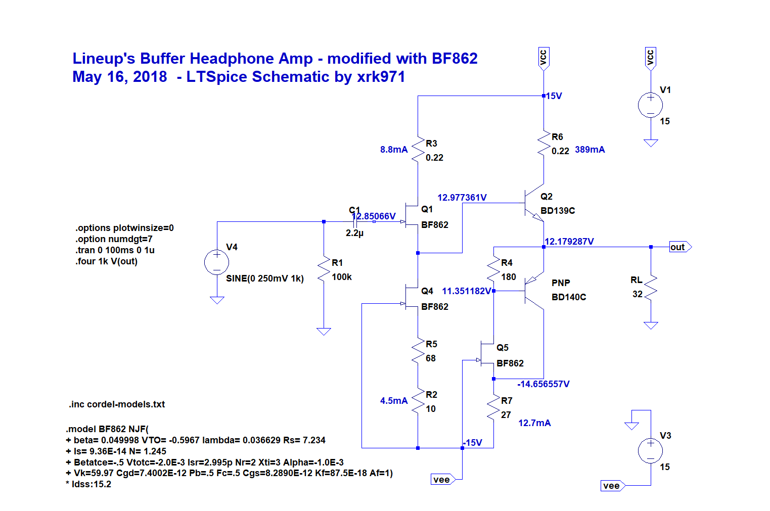

I sim’d this circuit in LTSpice and it has large 12v offset at output. Although done with BF862, I don’t think that should change DC setpoints that much. Thd AC performance looks nice though as expected for a SE Class A design. Have you run your own sim yet?
You should use a dual supply.
+/-12 or +/-15 Volt.

LTSpice Schematic
Hi Lineup,
Here is the 12v DC offset at the output that I was talking about. Changing the pot doesn't do anything. I think you need to apply a voltage divider from the +ve rail (filtered with say 47uF) and apply correct bias to Gate of Q1 in order to get the correct bias on the input and output stage.
I don't think change in type of JFET changes the fundamental DC setpoint behavior.
attachment.php

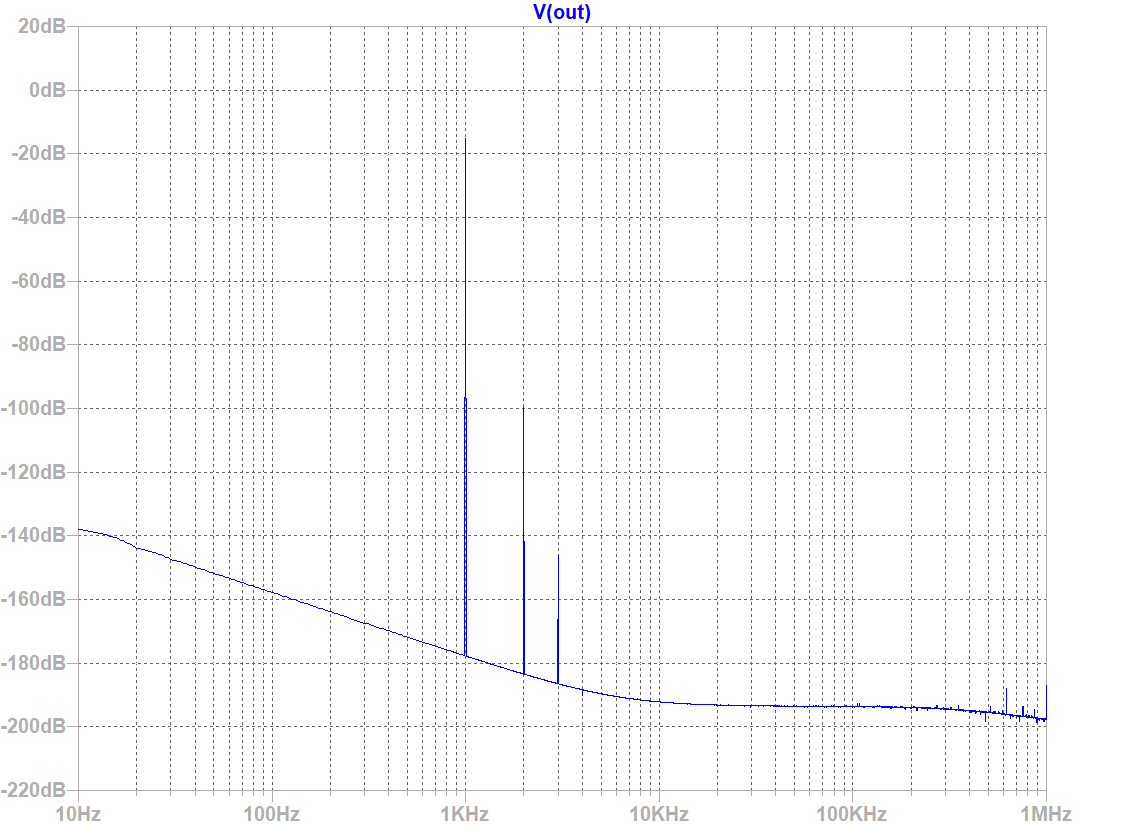

Even with DC, offset, the THD is indeed low and the profile is nice H2 and descending higher orders:
Harmonic Frequency Fourier Normalized Phase Normalized
Number [Hz] Component Component [degree] Phase [deg]
1 1.000e+03 2.431e-01 1.000e+00 -0.01° 0.00°
2 2.000e+03 1.458e-05 5.995e-05 93.38° 93.39°
3 3.000e+03 6.961e-08 2.863e-07 9.07° 9.08°
4 4.000e+03 1.921e-10 7.901e-10 -168.65° -168.65°
5 5.000e+03 1.575e-10 6.479e-10 -178.44° -178.44°
6 6.000e+03 5.456e-11 2.244e-10 -177.89° -177.88°
7 7.000e+03 2.971e-11 1.222e-10 -2.57° -2.57°
8 8.000e+03 1.031e-10 4.239e-10 -0.33° -0.33°
9 9.000e+03 1.693e-10 6.962e-10 0.09° 0.09°
Total Harmonic Distortion: 0.005995%(0.005854%)
FFT with 500mVpp into 32ohms:
attachment.php

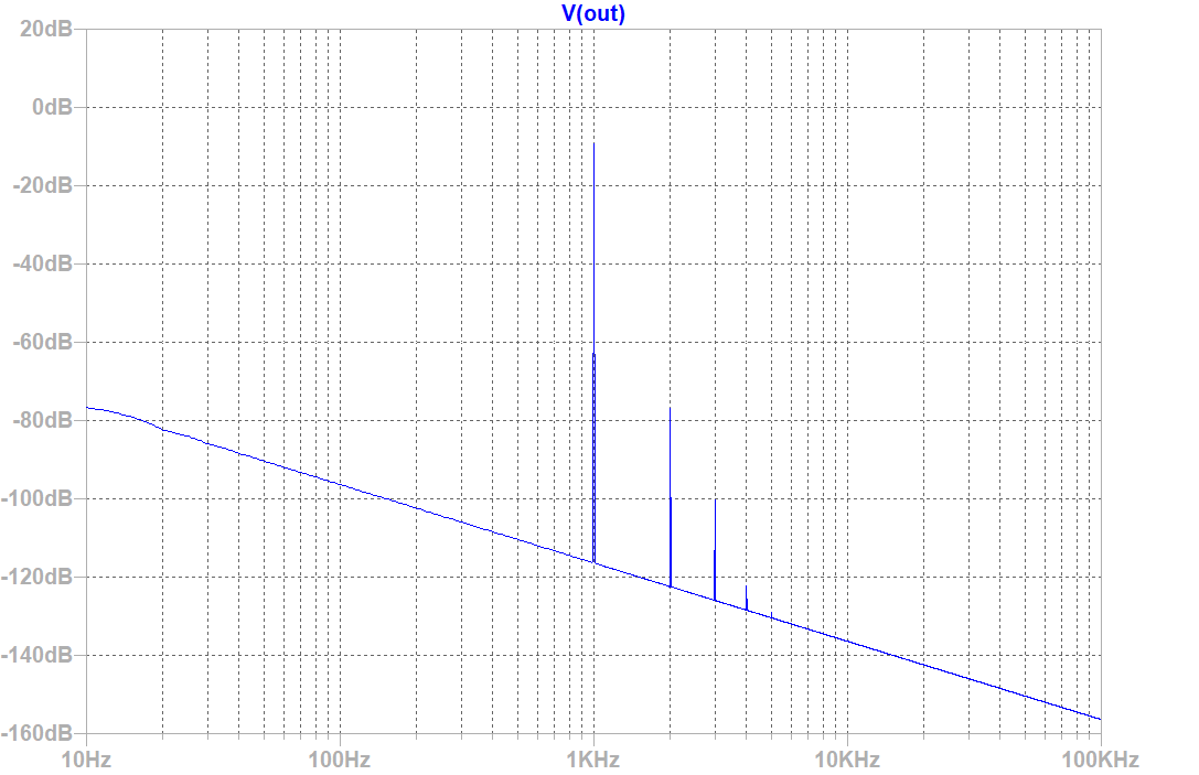

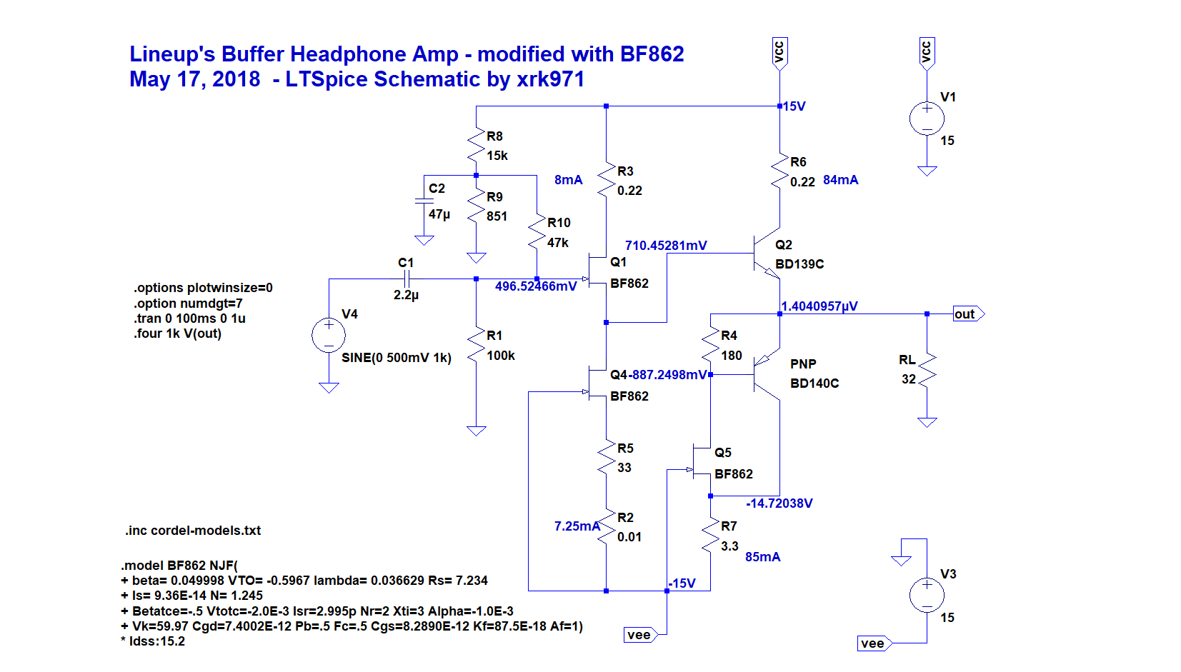

Changing that error did not fix problem in that the circuit clipped badly on negative side. The only way to fix was to add a voltage divider in order to bias the gate of Q1 properly. This sets the DC offset as well as sets the bias current in Q1. With this, the performance for 1vpp gives THD of 0.04% which is no better than my circuits which use a plain resistor vs CCS's.
New schematic:
attachment.php
FFT:
attachment.php
Distortion driving 32ohm load 1vpp:
1 1.000e+03 4.863e-01 1.000e+00 0.13° 0.00°
2 2.000e+03 2.011e-04 4.135e-04 -89.86° -89.98°
3 3.000e+03 1.390e-05 2.858e-05 0.45° 0.32°
4 4.000e+03 9.866e-07 2.029e-06 104.66° 104.53°
5 5.000e+03 2.621e-07 5.390e-07 -179.82° -179.95°
6 6.000e+03 1.605e-07 3.300e-07 -178.12° -178.25°
7 7.000e+03 1.370e-07 2.817e-07 -180.00° -180.12°
8 8.000e+03 1.201e-07 2.469e-07 179.99° 179.86°
9 9.000e+03 1.066e-07 2.192e-07 -179.99° -180.12°
Total Harmonic Distortion: 0.041454%(0.041434%)
But, driving 270ohm load 1vpp give very low THD of 0.0008%:
1 1.000e+03 4.955e-01 1.000e+00 0.09° 0.00°
2 2.000e+03 4.216e-06 8.509e-06 89.14° 89.06°
3 3.000e+03 9.456e-09 1.908e-08 169.62° 169.54°
4 4.000e+03 9.982e-08 2.015e-07 179.83° 179.74°
5 5.000e+03 7.973e-08 1.609e-07 -179.98° -180.07°
6 6.000e+03 6.628e-08 1.338e-07 -179.99° -180.07°
7 7.000e+03 5.666e-08 1.144e-07 -179.99° -180.08°
8 8.000e+03 4.942e-08 9.974e-08 -179.99° -180.08°
9 9.000e+03 4.377e-08 8.834e-08 -180.00° -180.08°
Total Harmonic Distortion: 0.000852%(0.000000%)
This would indeed sound exceptionally clean with higher impedance phones - but they need more voltage gain, so a preamp is needed.
Note, I moved the R1 100k to the left of the cap C1 and it did not make any difference (THD) other than reset the pot R9 to 590R to zero DC offset.
With 6vpp into 270ohms, I was still getting THD of 0.005%, an excellent follower.

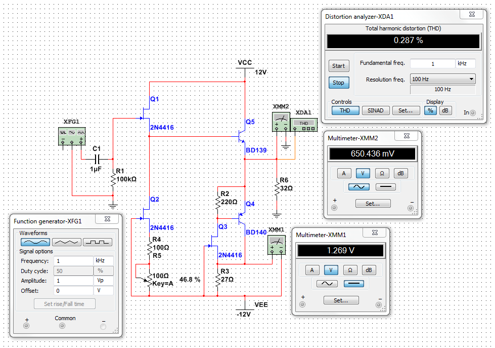

But I am sorry to say it does not work good.
My testing shows 1Vpeak gives 0.92Vpeak out. With load 32 Ohm.
But the THD distortion is not nice - THD 0.287% is not acceptable.
I dont know how you, xrk971, have done your testing.
But I think my numbers are closer to the truth.
Unfortunately Multisim SPICE for BF245 is not working.
So I did my testing with 2N4416 JFET.

...My testing shows 1Vpeak gives 0.92Vpeak out. With load 32 Ohm.
But the THD distortion is not nice - THD 0.287% is not acceptable.....
How bad does 0.3% THD really sound?
47mA peak in 32 Ohms is 1.5V peak 1.06Vrms at clipping.
The current is swinging from near-zero to 94mA.
At this point, a collector-loaded amp would be near 26% THD.
Emitter follower has NFB and THD will be lower. 47mA suggests re (hie) is about 0.55 Ohms. Relative to load, about 57:1 NFB. So 26%/57 is about 0.45% THD. Your level is about 2/3rd of clipping, so THD may be ~~2/3rd, about 0.3%.
If I can back-figure your results on a matchbook, then you can look-at how I did that and figure what to change for higher performance.
BTW: that complex current source could be replaced with a 255 Ohm resistor, very little difference when loaded with 32 Ohms.
