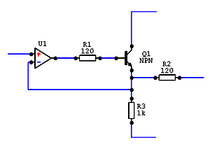

I think you have two options if you want to keep it simple:
## Remove the 470 ohm resistors, and place a pair of 100 ohm inside the feedback loop instead. This protects the outputs and still maintains a good voltage swing.
## Class A-driver voltage follower output. You need three resistors and a NPN transistor (image)
120 ohm is a standard output impedance for headphones. 1 kohm gives 15 mA idle current. For most modern headphones this is enough. If you want more you must use a heatsink on the transistor.
I have tried both and they works. But don't expect a faboulus sound from 5532/34. It should be a tight and controlled image. If you want a more open and clear image try LT1497, it is absolutly amazing!
Question: why a pre-stage?
