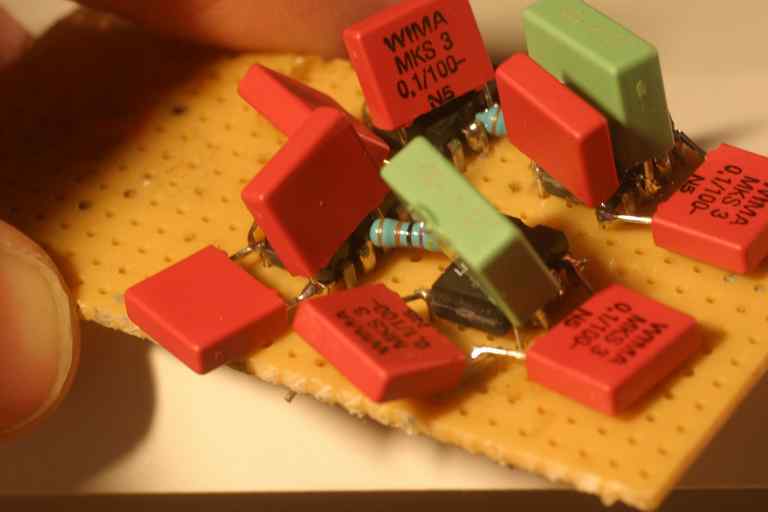

If you going for the pimeta i would suggest you to do better with the caps, n00ber and i have been pushing the caps as close as possible to the OP's supply pins
http://www.diyaudio.com/forums/attachment.php?s=&postid=643518&stamp=1116272644
http://www.ettnet.se/~tobias/diy/opabuf/opabufwoic.jpg
I can't say that i've tried it but the PCB is on it's way soon, but common sense says that it "should" be good to have the caps as close as possible. In that Pimeta board they are not close
If you were thinking of powering a pimeta like headphone amplifier from a regulated mains supply, it would definatley be a good idea to try and rework the design to get the decoupling caps closer to the supply pins.(you could even solder them directly from the pad to the pin)

However if you plan on using batteries to provide the power to your amp, I don't think the decoupling caps have to be so close. As there will be very little ripple from the batteries during normal operation.
They will of course prove more usuful, closer to the supply pins, when the battery output drops below the recomended minimum voltage for the opamp.
If you read posts over at head-fi , there is alot of people that hold the pimeta in high regard as an amplifer, and the next step up is considered to be the PPA or the M3, which is quite a jump in terms of sound quality.
But if your going to DIY I personally would move the caps closer.

n00beR said:However if you plan on using batteries to provide the power to your amp, I don't think the decoupling caps have to be so close. As there will be very little ripple from the batteries during normal operation.
Wrong.
The caps must always be at the chips' pins.
No matter what the PSU.

Lovan said:Robselina: If your going to use 2x12V batteries just skip tle2426 and use the batteries to get +-12V directly.
And DO put the caps directly on the chippins! See attachment.
Agreed on the caps, but why do you suggest using the batteries to make the virtual ground? Just convenience? current capacity?
I'm concerned about DC offset on the output but maybe I don't need to be....
