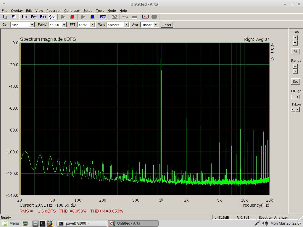

Balanced-balanced closed-loop performance:
I installed wineHQ (but would run in regular wine too). Runs bitperfect at up to 192/24 directly to Juli. Juli is disabled in pavucontrol to avoid being taken by pulseaudio.You have ARTA running on Linux?
Yeah, I was pleased to learn this by testing. It is actually its fundamental feature why I used it here - I need single-ended outputs to feed the amps (most have only SE inputs) and balanced inputs to measure the speaker output properly.I did not realize the balanced and unbalanced i/o's on the Juli@ card were both live at the same time.

Yeah, Juli's codecs are not on par with the latest development, the card is already over 10 yrs old. But for this particular use I appreciate the single-ended and balanced inputs/outputs working simultaneously. Typically DUT would be fed with the SE output and measured with the balanced input.

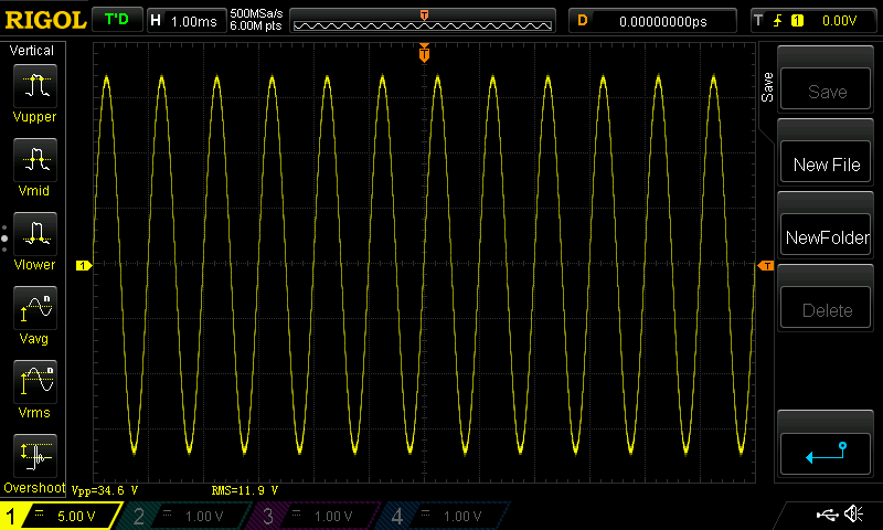

I analysed maximum measurement range and was surprised to learn the total usable range at balanced input without any external voltage dividers is 40Vpp. That is great for measuring apms since no dividers are needed up to 20W/8ohm.
Here is 18W/8ohm (34.6Vpp) measured with no attenuation, still -1.6dBFS headroom. It is a dirt-cheap TPA3116 amp inside a thin client PC, fed by internal soundcard of the PC and powered directly by power adapter of the PC, I will post results in the digital amps section.
