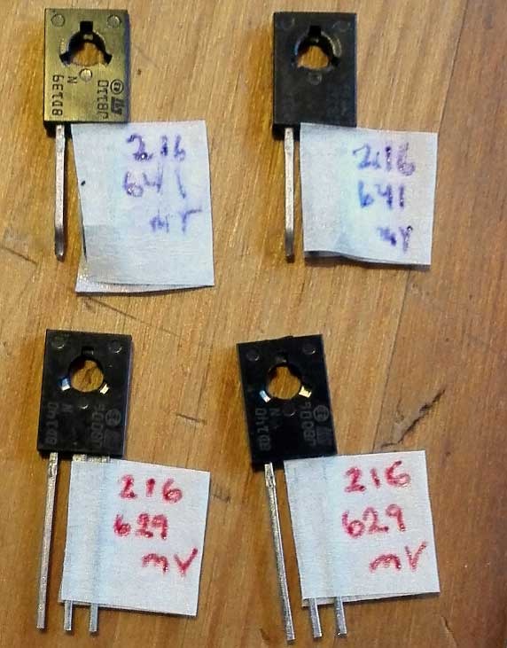

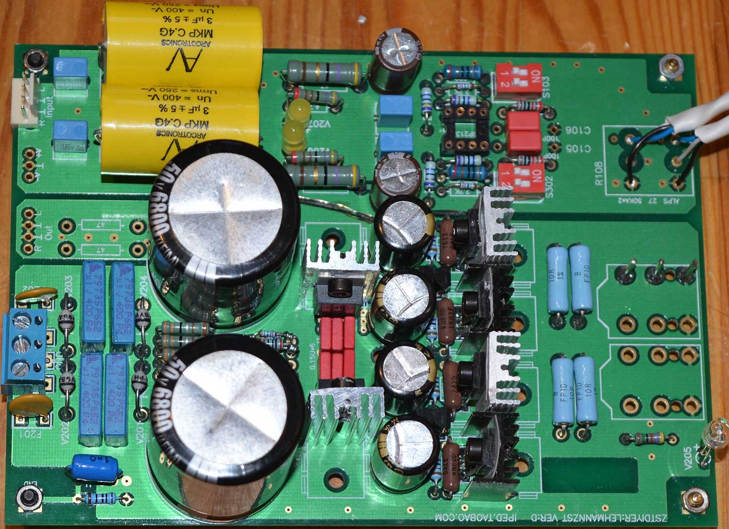

I've solder in the BC550C & BC560C.
Though it may look very close, there are no shorts around the BJT's.
Closest match I could get out of the 75 pairs.
I used slightly larger heatsinks than the ones marked on the silkscreen.
I'll use the same, modified, heatsinks for the BD139's/BD140's.
I'm waiting for more of the above transistors to arrive so that I can get a close matches as possible. Also waiting for the missing resistors.

Small update.
I've more or less completed the PCB.
Still need to go over it all a few times with the DMM.
Got decent matches for the BD139/140 as well though not 100%.

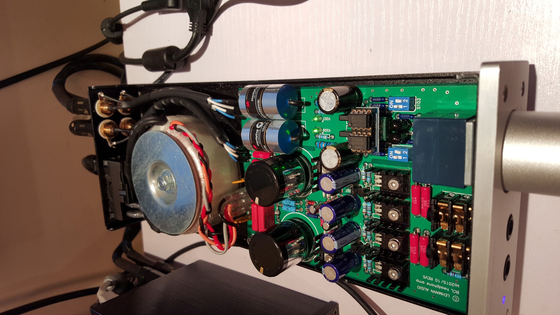

Wiring is a bit sloppy, I'll tidy that up and I still need to wire in the HP jack and insert an opamp.
Don't know what kind of wood it is, got it for free from a local hardware store's scrap-bin.

I did the final wiring, popped in an OPA1652 and flicked the switch.
No problems at start-up.
With no source connected and no load, DC offset stabilized at around 15mVdc/channel.
A bit on the high side imho.
Resistors, transistors etc are all matched.
Could be the OPA1652 I guess, I'll try later with an OPA2134.

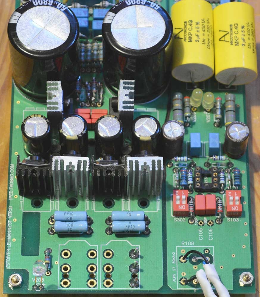

Something that struck me though was that the heatsinks got hotter and hotter until I didn't feel comfortable with it after about 20min or so.
At first I thought it could be oscillating opamp (OPA1652AIDR), but that would not explain the vreg heatsinks being just as hot.
I've used heatsinks that are bigger than the ones on the silkscreen.
Measured input voltage (AC), about 17Vac from my 0-15vac 0-15vac 1A toroid transformer from Velleman.
A few pics to show the heatsinks etc.
Any ideas as to why the vreg and transistor heatsinks gets so hot?
I can't have made a mistake when "center-tapping" the dual secondary toroidal transformer as that would have given wastly different measurements.

Make sure the heatsinks of the voltage regs are isolated from the ground! I had a problem with a voltage regulator in my DAC project. Turned out to be a short of the heatsink with the ground.. that way it will just pull current through.. they do get quite warm under load in my setup too but when I stop playing music they cool down a bit again. I can touch the heatsinks. I see your heatsinks touching or almost touching the capacitors! That's a big No No!
The heatsinks are, very, close to the caps but not touching them.
I can hold a finger on the heatsinks, as per the old rule so to speak, without it being painful/burning.
With the "silkscreen" heatsinks, the PCB takes some of the heat away, that could explain why these heatsinks feel warmer.
I have no shortage of heatsinks so I could go bigger...
