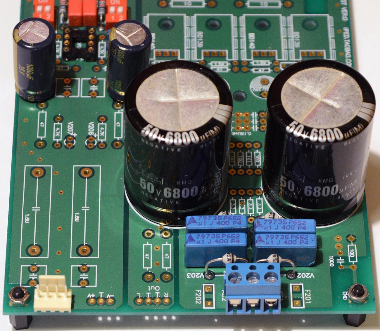

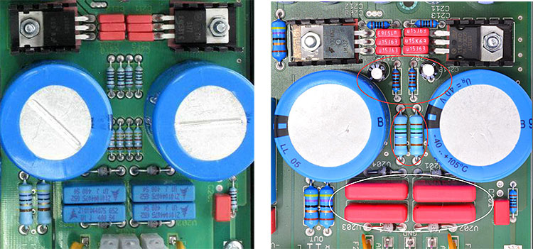

My previous model had 2x2 MSR25 3.3R resistors in parallel in between the big power caps. This means roughly 3 ohm and 1.2W if I am not mistaken.
The 2 positions on the board are not big enough to fit 2W resistors nicely like the seller of the board advised. The 2W 3R resistors are hard to get anyway. I did find some wirewound black dales in this size (which are practically to big).
Also found some 3.01R Vishay Dale 1W metal film resistors which fit perfectly and fit the bill better. I think the 0.6W resistors on this board are overkill anyway because I replaced most of them with 1/4 versions.
Sooo anyone that can give me a calculation ande explanation on whether a 1W resistor would be sufficient to replace the two smaller 3.3R 0.6W resistors of the original model.

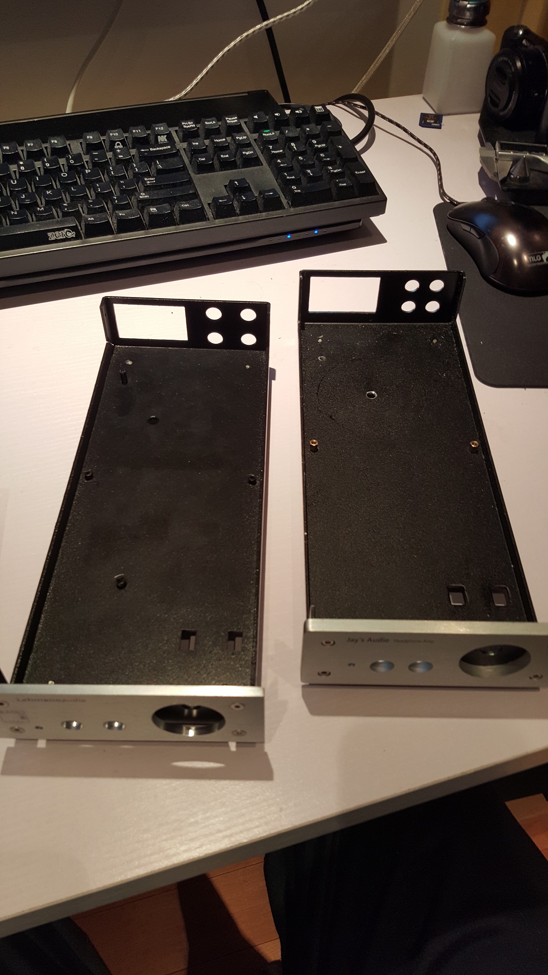

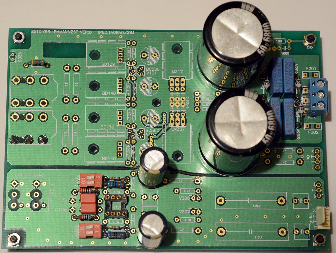

Also had a little setback. My new case came in.. and it was a LOT smaller than my previous one from Jays audio. The quality was also lower. Thiner and smaller frontplate. Inferior and very rough paint. Volume knob painted wait to shiny and rough. Inner housing not painted. Letters on front panel of poor quality (even though they say Lehmann audio). But this was the only case the PCB I chose would fit in nicely so these things could be overcome. What I could not overcome was that my 60VA Block transformer wouldn't fit! Not by FAR! So this would mean my expensively (from Europe to China) imported 60VA transformer would be useless and I would have to use a 40VA Block transformer that I still have lying around. Probably the 40VA high quality transformer would do the job fine but this will be a ultimate build with most components maxed out so I can see where the limits of this circuit lay.
I will save the case for another build later, but for now I will customize the PCB and case a bit to fit together. This won't be a huge problem but I would have liked a solid PRO build without to much customizing everything.. I don't want it to be a scrapyard build. Must be clean and PRO for daily use.
Still waiting for some resistors, mundorf 4700uf 40V (63V didn't fit! not even in the big case) and some smaller 10uf caps.
I hope everything will come in this weekend! So I can get it running and start fine tuning with different caps and opamps.

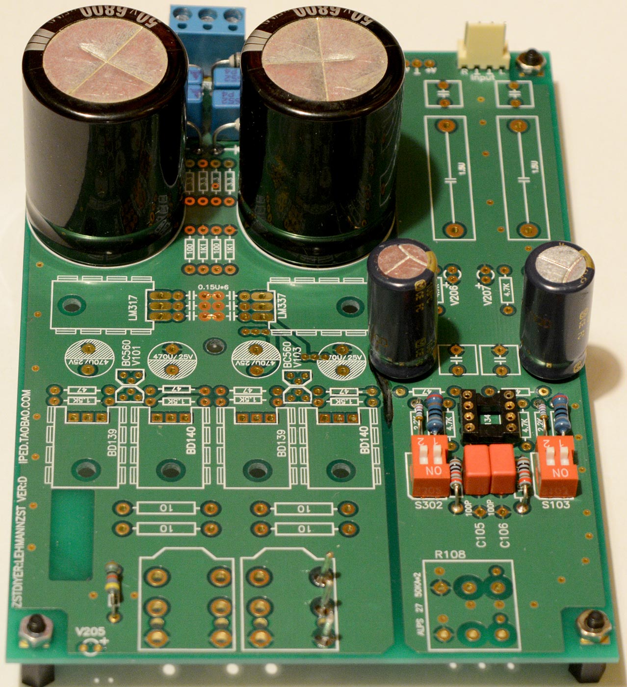

This I pulled of one of the Taobao shops. I got my PCB from him.. really arrogant bastard. Doesn't want to explain anything. Doesn't want to sell the rev7 pcb only when I am buying a full device. I bought the Rev5 PCB, asked about what resistors he uses in between the 2 power caps, and got an answer not to disturb him.
Well he's an ***.. that's for sure.. but he is doing quite some interesting stuff. I think it's based on the latest revision of the original Lehmann. Actually I think it is the real Lehmann in the picture with the blue transformer because he is using black closed ones.
I think the new design incorporates different resistor values and the use of a couple of 10uf caps.. It's a shame I can't see the backside of the pcb on this one..
It's interesting though. It's another version of the PSU mod everybody is already doing. I think Lehmann evolved too..

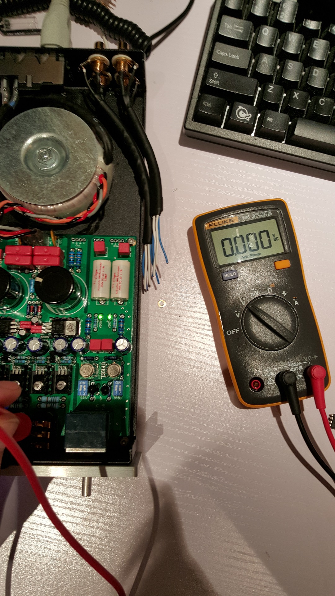

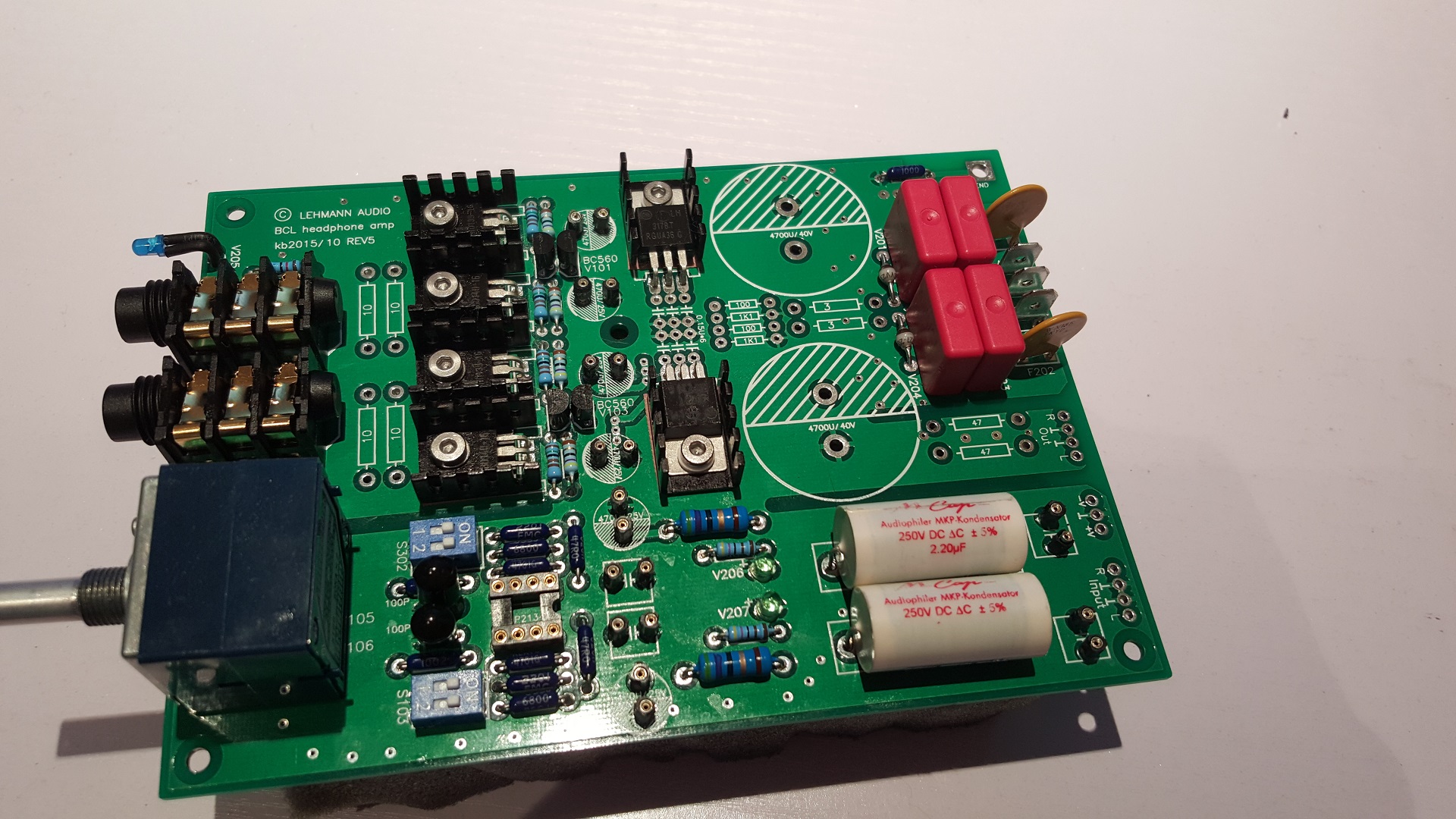

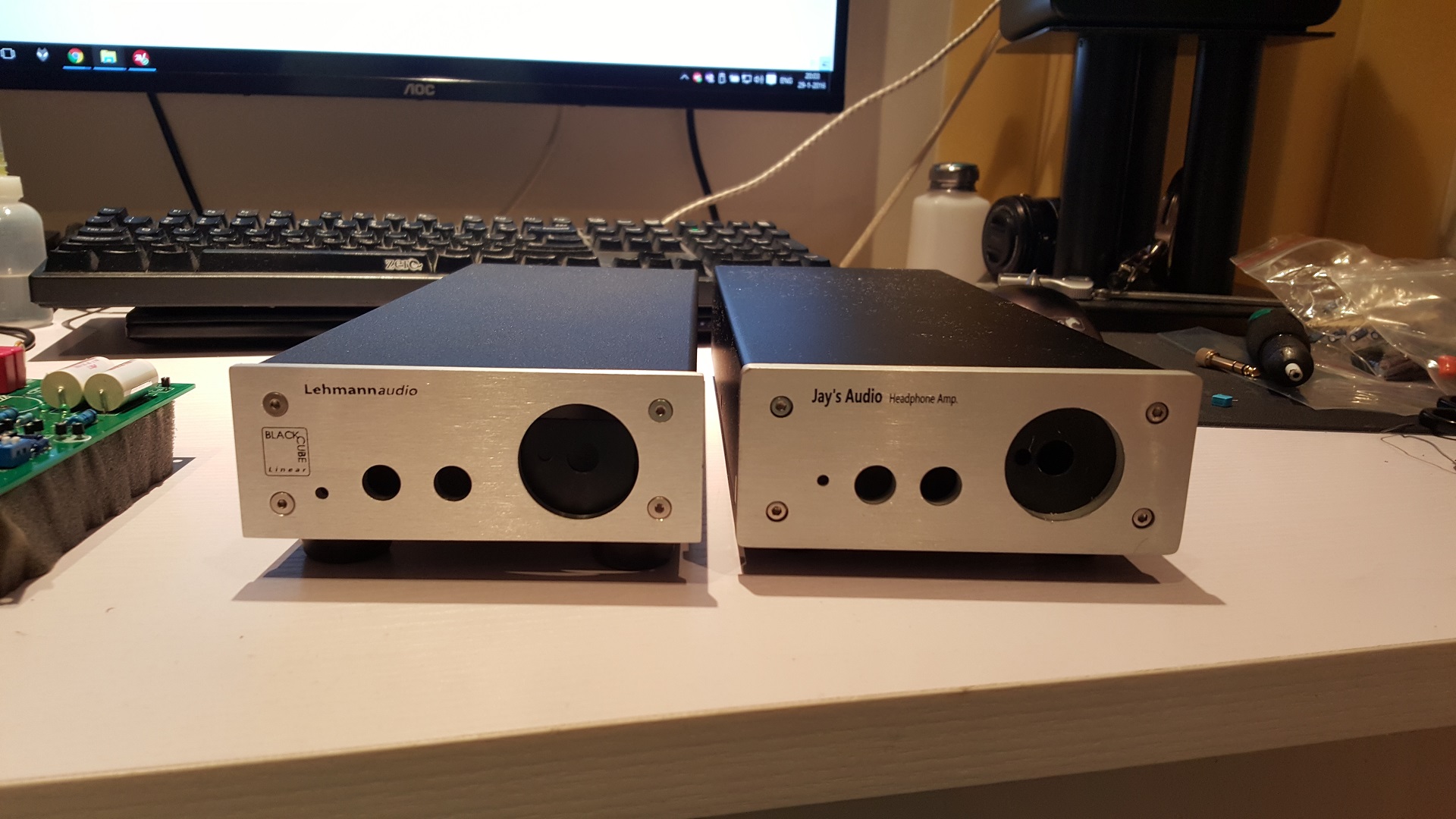

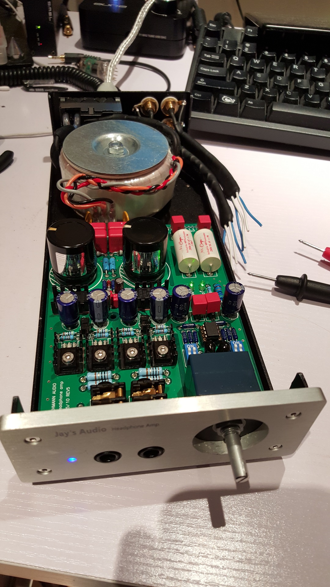

Regarding my own progress:

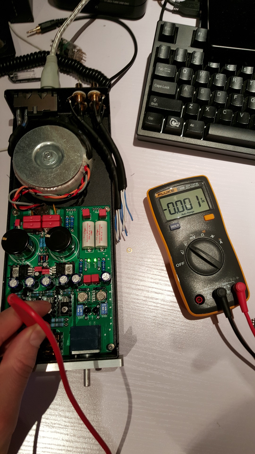

I've finished the base build! I use most original Lehmann parts and from there on I will test different parts and combinations in the sockets I've installed. I also still got some RA resistors incoming for the signal outputs.
First smoke test went fine. Turned it on with the standard OPA2134AP. good DC offset and parts didn't get to hot.
Then I dropped in my dual discrete OPA111VMs. DC offset = PERFECT!
Tried all other opamps and got no big excesses in DC offset.
Next step is to give the device some burn in time. Then solder the signal cables in and do some testing with some inexpensive IEMs and rechecking DC offset after a while.

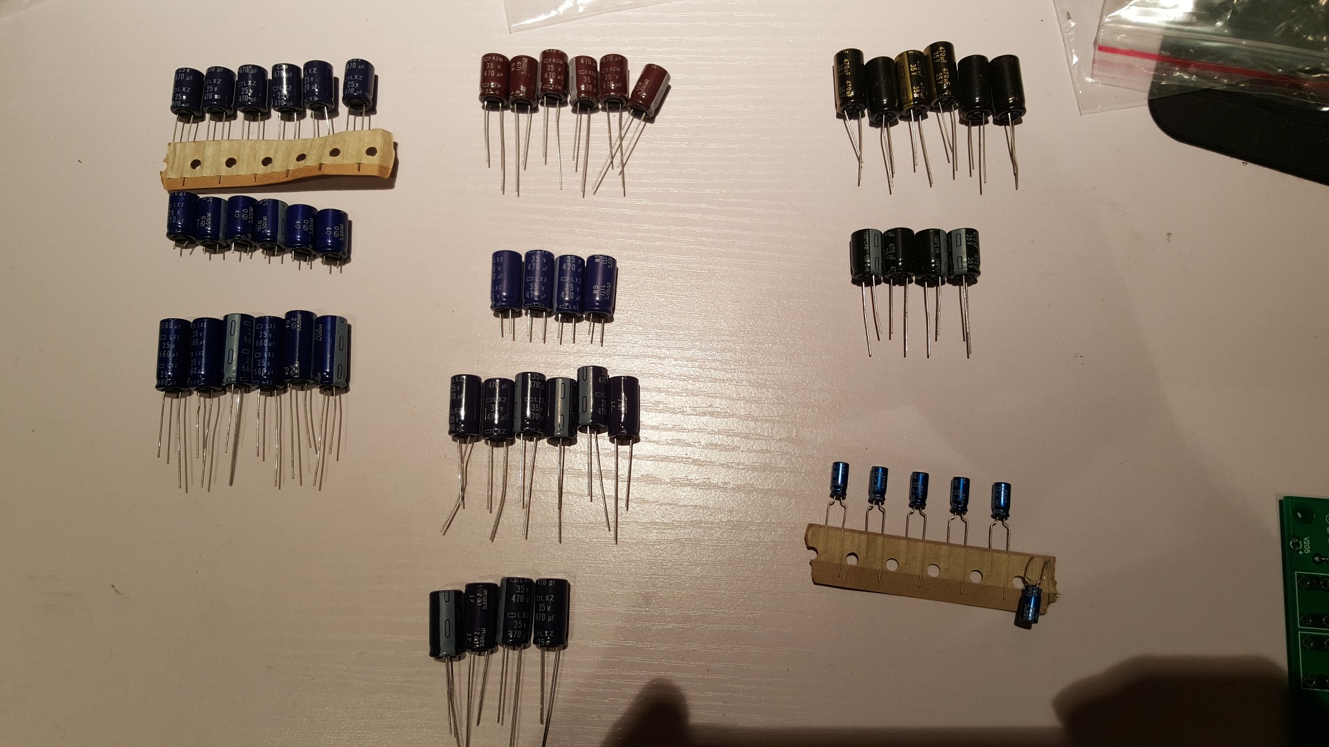

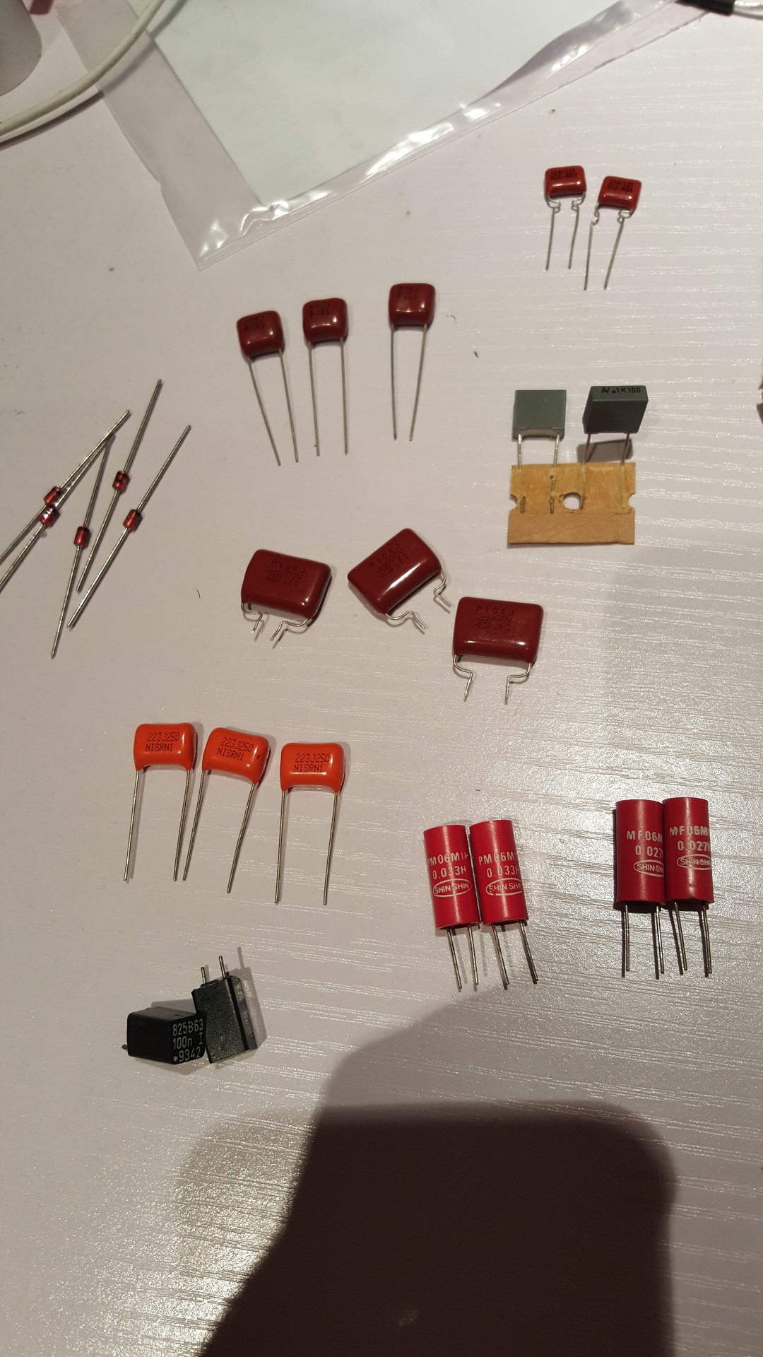

Then the fun can begin! The parts testing. I've got a good collection of caps to test for the device.
PSU output:
Nippon LXZ 470uf 25V (standard, they seem legit)
Nippon LXZ 470uf 35V (different colors and different batches)
Nippon LXZ 560uf 35V (same series as the 470uf 25V)
Nippon KZM 470uf 35V (same specs as Panasonic FR)
Panasonic FC 470uf 25V (good old trusted FC)
Panasonic FM 470uf 35V (near same specs as Nippon LXZ)
Panasonic FR 470uf 35V (some like em some don't, i've had good experiences with them)
For opamp:
Elna Silmic II 470uf 25V (black/gold)
Elna Silmic II 100uf 35V (black/gold)
Panasonic Pureism 470uf 25V (audio grade)
Panasonic Pureism 220uf 25V (audio grade)
Nippon ASF 470uf 50V (audio grade capacitor used in high-end brands)
Nippon ASF 470uf 25V (audio grade capacitor used in high-end brands)
Nippon AWJ 220uf 25V (REALLY big for their capacity and power rating. Like Silmic. Considered High-end audio capacitor by Nippon. From their catalog the best I could find.)
For the input bypass and opamp coupling positions:
Wima FKP4 0.022uf MKP
Shin Shin 0.027uf 50V Polystyrene
Shin Shin 0.033uf 50V Polystyrene
NIS 0.1uF 100nK 125vac MKP
NIS 0.022uF (22nJ) 250v MKP
AV R84 0.1uF 100v MKP
SOSHIN LCR825 0.1uf(100n) 63v MKP
ECQ-P 0.027uF (273J) 50v MKP
ECQ-P 0.1uF (104J) 100v MKP
Will be interesting to see how these influence the sound. I will change them at after all other capacitors.
And after that I have some RA 1W resistors to swap the Vishay MBEM0414s out. To see if this improves anything.
PSU output:
For opamp:

I've got the device up and running.
Impressions so far:
Good solid built! Still deciding on caps. PSU caps don't differ a lot except for the Panasonic FRs. They seem to be thinner but wider. I prefer a more natural sound. So I will probably stick with the Nippon LXZs.
I tried different caps as bypass caps with the input caps ranging from 0.022uf to 0.1uf.. NO! I also tried without them.. guess what.. NO difference. What will be the damage if I would remove them? Lehmann did it with the SE with the high-end mundorf input caps like I have..
Haven't decided on the opamp coupling caps yet. Right now I'm in favor of some smaller 47uf Elna Silmic IIs that still need to run in. So if they are already good now they will only get better. The Panasonic Pureisms seem to be a bit more detaild and wider. But I've noticed they get worse after burn in somehow.. Also got the Nippon audio caps left but the need to be soldered since their legs are to thick to fit in the sockets. I am thinking to try the 220uf AWJs.
The best improvement I got from changing the little caps in between the bigger opamp coupling caps. I run with the 0.033uf Shin Shins. They are really opening things up. Lifting some kind of veil.
When rolling opamps I am in favor of the OPA111VM with my Aune T1 tube DAC and the OPA627BP with my internal ESS Sabre ES9018K2M DAC (Which is actually more pleasant than the Aune T1, which is a bit harsh but more detailed.) Also tried the Sanskrit. Missing rythm and order. Its a good sounding device but the sound is messy and tiring.
I will keep swapping parts and testing untill I find the best combinations.

Removed all the caps at the red Wima FKP4 positions.. no change! Like the real Lehmann BCL SE.. I think Lehmann also found out they were not doing anything.. Maybe these positions were still in the PCB design from earlier versions with different parts choices.. The Mundorf MKP caps I use are really good anyway. Connected to Aune T1
