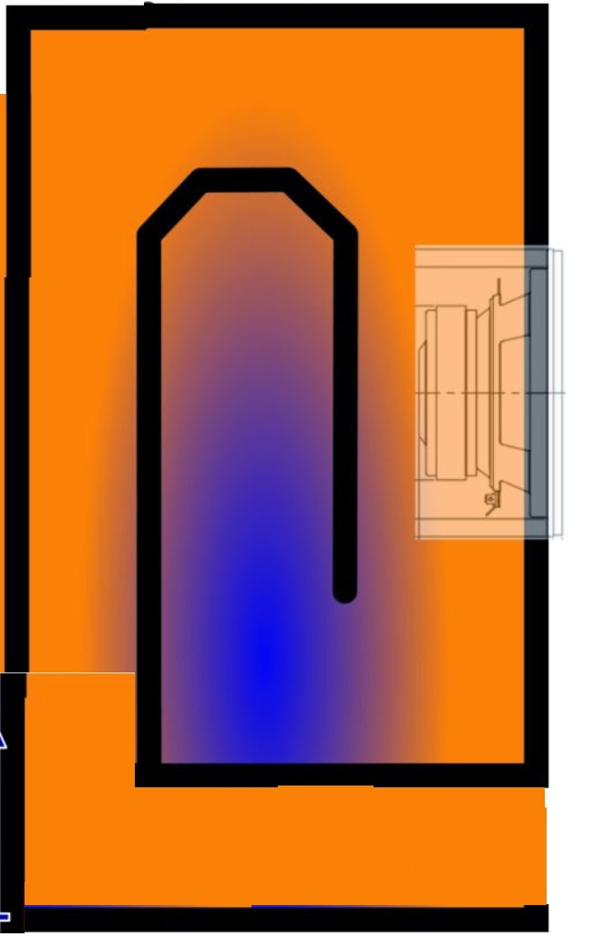

Brian, is it possible for you to post a Hornresp comparison (SPL/Displacement) of your POC6 against an standard vent box for the same driver? I'm curious to see the advantages.
The "transmission line" at your POC6 looks too short, so maybe you just changed the simulation and the port shape to calculate as TL, but the result could still be more close to standard vent. I could also be wrong due to me restricted knowledge.
Well, it is a 48 Hz (slightly lossy) MLTL, so it was going to be short any way you look at it .
When I did the vented box comparison, the output at the low end was similar (the MLTL's response was slightly better, if I remember correctly). The offset MLTL sim approach however allowed me to make sure that the 100 Hz ~ 200 Hz region was as smooth as possible, extending the usable passband of the build. A vented box with a vent this size and length will likely feature response aberrations in this region, the location and effect of these aberrations being somewhat unpredictable unless the sim program does a good job of matching the build's actual topology. And of course that extra internal panel does brace and reinforce the box somewhat .
All in all, for the cost of an extra panel in the box, I think it's a better approach.
