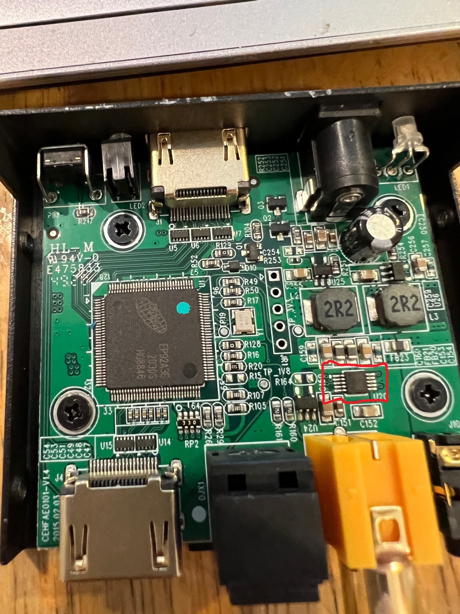

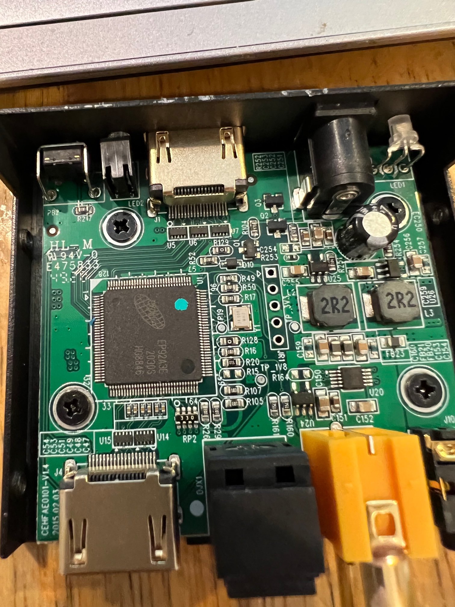

I'm looking to feed I2S from HDMI audio or specifically the ARC port of newer televisions to a Twisted Pear B3pro. After looking around a while I realized there's nothing out there (that I could find) diy wise that could do it. So I knew there were plenty of audio extractor boxes, most of them were toslink. If I was going to compromise I would use coax spdif out from one of these boxes. I had one of these from Amazon basics that cost $20 and it did the job well feeding my receiver for a few years. I decided to take the cover off and see what was inside
I looked up the chip inside and found out that it is made by this company
https://www.semiconn.com/ep92a3e
The cool thing is that is has I2S output but I could not locate a data sheet to see what and where those pins might be. I've sent an email to that company to see if they'll send me one. If someone knows where to find it please post it.

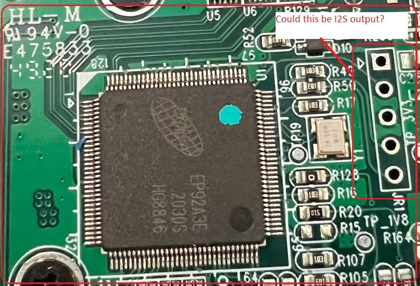

What's even better is this set of pads labeled JR1 has the right amount of pads for I2S. Could this be I2S? The unit in question is here
https://www.amazon.com/AmazonBasics...jbGlja1JlZGlyZWN0JmRvTm90TG9nQ2xpY2s9dHJ1ZQ==
I don't have the knowledge or tools to try and figure out what JR1 is. Does anyone have a schematic of this unit? I would think it's mass produced under several makers and models.
Any thoughts? Help?

I doubt its an I2S output for a number of reasons :
- The I2S output capability of the chip is 8 channels (4 pairs) which would require more pins than 5
- A typical I2S output would be 4 signal pins plus GND, here there only look to be 3 signal pins
- R49 and R50 look to be pull-ups, I2S has no reason to need pull-ups

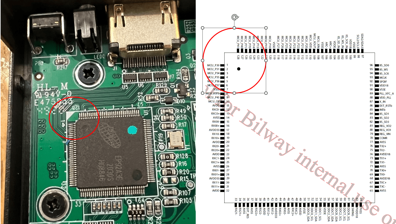

Good find - so if the 3E has the same pinout as the 2E then on the JR1 connector :
pin1 ??? Not used (maybe power?)
pin2 SCK
pin3 GND
pin4 SD
pin5 WS
This is making the assumption that the track disappearing under the IC goes to pin94. Definitely worth looking with a 'scope.

It certainly is worth looking at. I'd be happy to send one to someone who could look at it with a logic analyzer. I have no problem buying a cheap one and learning how to use it but I'm not sure someone could do it quicker and far better than me. Let me know, I'll ship one to someone in the US.

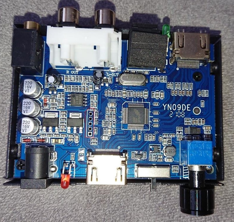

One of our electronics specialists gave me valuable tips on the topology of these chips. He indicated that there is a DAC on which the I2S signal is given. In my case, it is CS4344I'm looking to feed I2S from HDMI audio or specifically the ARC port of newer televisions to a Twisted Pear B3pro. After looking around a while I realized there's nothing out there (that I could find) diy wise that could do it. So I knew there were plenty of audio extractor boxes, most of them were toslink. If I was going to compromise I would use coax spdif out from one of these boxes. I had one of these from Amazon basics that cost $20 and it did the job well feeding my receiver for a few years. I decided to take the cover off and see what was inside View attachment 1084986

https://www.farnell.com/datasheets/88361.pdf
Everything seems to indicate that this is also the case in your case, marked with a red box

Interesting that the HDMI pairs appear to be going in to the part of the chip normally attributed to the MCU. Am I reading that wrong?
I tend to agree with abraxalito. JR1 doesn't appear to have enough pins. The middle pin seems to be labelled 3.3V unless that's an indicator for some other test point.
I only expect to use my extractor for stereo.
