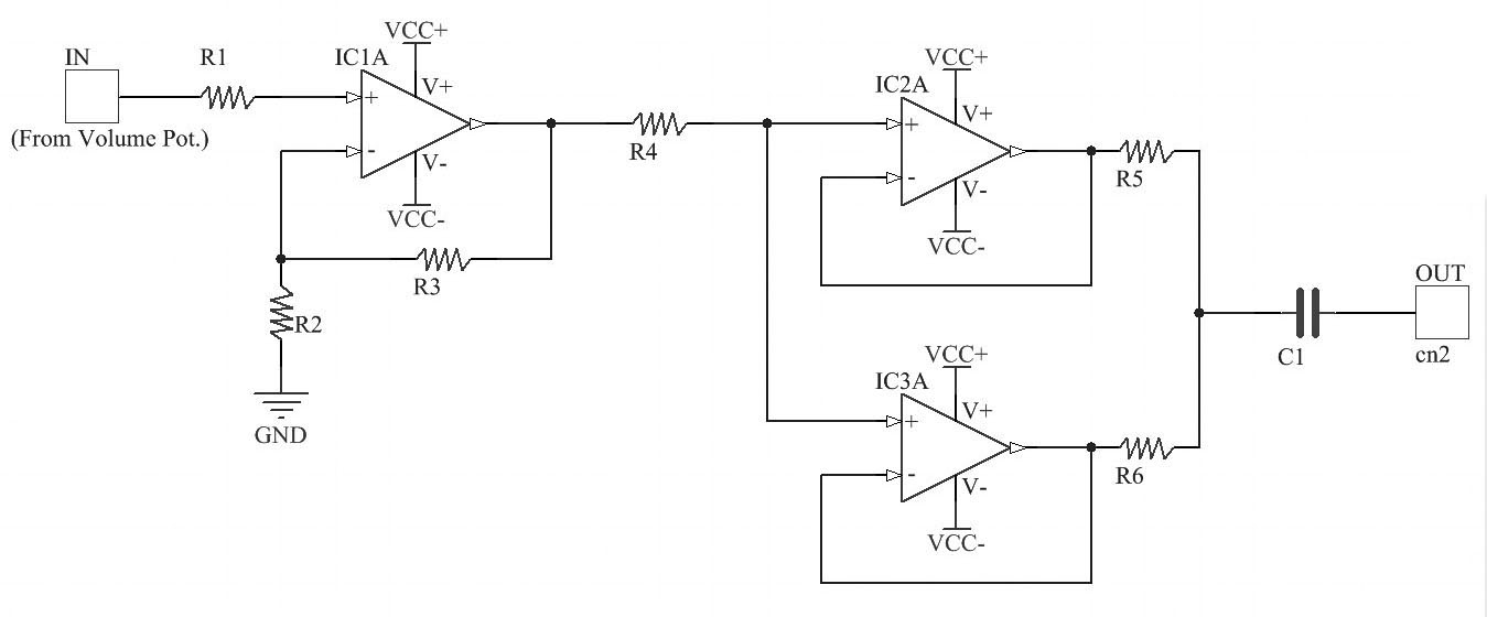

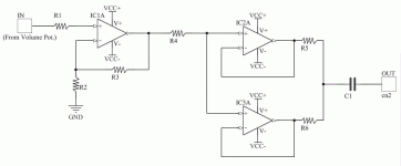

1) About the schematic, do you think that 2 buffers/ch. are enough?
2) I don't want to use a DC servo even because I don't know how to design it, so I've used
a good polyester capacitor 4.7mf Wima in the output. Do you think is a good idea or I must
use a DC servo?
3) How much gain may I use? Signal is direct from Cd player to volume pot. so I have about 2v.
Power supply is +-12V.

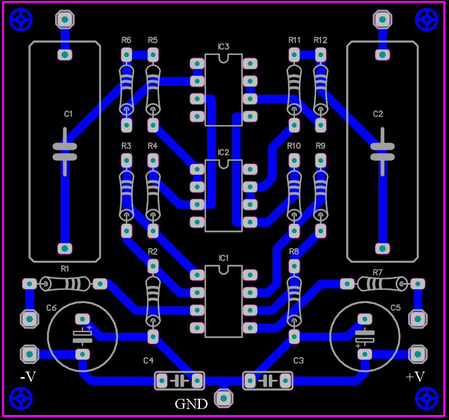

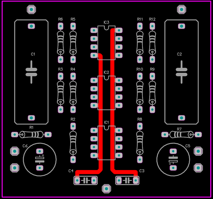

4) About PCB,it's not a dual layer, I connect the top layer (red) with small pieces of cable.
I will insert ceramic capacitor as DC filter for power supply directly in the IC pins.
I will use a single point GND and connect everything on it. Do you think is there some wrong?

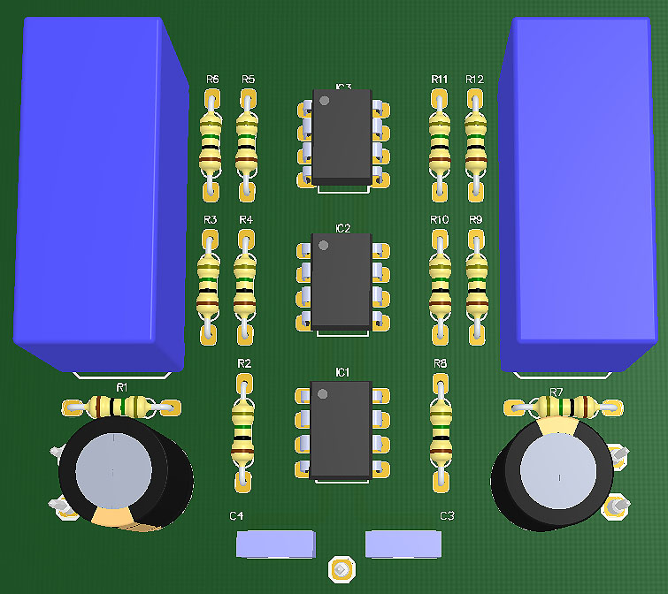

5) Ok, this isn't a really question but....I use Altium Designer and it permits to create our own
component, so, everything you see was designed by me... do you like it? 3D objects are downloaded
from 3dfactorycentral.

I don't think you'll need any gain, you'll probably need to drop some signal.
A current buffer still is a good idea, to lower the output resistance and unload the opamps in the CD-player, but a single opa2134 should be enough for those headphones. That way you can dump the current sharing resistors (that add to the output resistance) and the capacitor (no extra gain, so almost no DC amplification).

your headphone power calculator tell me for 120db spl I need 50ma, so, I think I can use only 1 buffer. I've always read that to drive 50ohm I need more and more current... I never studied electronics, only an hobbyst from more than 30 years.

if measurements are good, is good! But first I prefer good listening!!
In my experience, for good listening, a discrete output stage has worked better than opamps. I'm not totally sure why this is but it has something to do with power supply noise - classAB operation creates a lot of high frequency noise on the supply and it seems opamps are particularly susceptible to this.
Your schematic reminds me a lot of the O2 - which I built one of (from the published schematic, my own layout) and was totally underwhelmed by the sound. It sure does measure well though, according to its designer.
My suggestion then is to adopt a 'Lehmann' type of approach - use an opamp for gain but a diamond buffer for the output stage. I have been having very pleasing results with this - see my most recent blog posting.

HD598 50 Ohm, 97 dB re 1 mW (now given as 112 dB @1 V rms sensitivity) headphones only need 4 Vpk, 80 mA to reach >120 dB SPL
working from the distortion graphs it looks like the TPA can swing within ~2 V of its supply rails V before distortion rises
so you could use as low as +/-6 V supplies to keep wasted heat down if you really just want to drive 50 Ohm headphones
you could even use my push-pull Class A bias trick without overheating the chip, without soldering down the PowerPad on the underside with +/- 6V supply

You can't get 50 ma out of one OPA2134---only about 35 ma.
