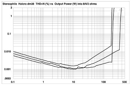

I am simulating halcro here:
http://www.diyaudio.com/forums/solid-state/6362-halcro-amplifier-4.html
hope they won't be angry for the results. Because they said ultra low distortion up to 20kHz full load. My sims result says increased in 10k+hertz and load.

Hi, Andrew.
Don't worry, I am selecting my transistors models carefully. Iam searcing by goog and found this link* 1st page line2.
There also some real measurements by people, and my sim results still showing better results than real test. It(sim) at least show increasing distortion for HF and load and we know what causing them.
Halcro THD spec is someting hard to achieve in 20khz full load with that topology, or probably halcro distortion spec is coming from simulation results from goodie models or someting.
Link: for goog: halcro distortion measurement result ,, page1 line2
Halcro dm38 power amplifier Measurements | Stereophile.com
Pict from link:
Pict from link:
