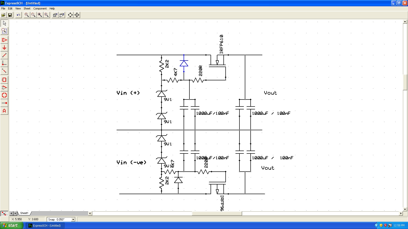

I am going to try the following: put instead of D1 and D5 zener diodes. Their rating should be more than 22V (38-16) and less the maximum rating of the regulator. If this will not solve the problem I am going to move to a simple zener with emitter follower solution and to hell with noise. Now I am going to do some orders from ebay
They will still do what they're intended to do as you describe, but they will also avoid to much voltage from input to output. If the reg will not climb fast enough, the zener will break and push it up faster until the output is high enough to so they get below their rated voltage.The purpose of D1 & D5 as I'm aware are for regulator protection when the input voltage falls faster than the output. I'm not sure what the purpose of your proposal is.
I see now, yes. Not sure that will work, but I see it. What about a eg 5V 1W zener in series with the vreg input? Or 2 vregs stepping down the voltage? The latter is probably what I would try... maybe that's a good reason not to

The latter I have seen in industrial designs before and works very well. You might adopt a two stage voltage regulator too. First stage drops +/-38 V to (e.g.) +/-27 V and the next to +/- 16 V.
It's just a matter of putting two regulator circuits in series. Drop R1/R4. The first stage doesn't need D2/D6 but keep them in the second stage. D1/D5 are across both regulators, i.e. kathode of D1 on the input of the first regulator and the anode on the output of the second regulator, vice versa for D5. With a lower Vin-Vout difference, the maximum rating cannot be exceeded.

The LM3x7s are near impossble to destroy if used correctly. I have a class A headphone amplifier that needs +/-25 V. I didn't bother with installing the protection diodes (D1/D2/D5/D6) but then the amp draws enough current to discharge the output of the psu quickly at power down. The heatsinks are barely adequate because of lack of space. Still, it has been working fine for the last 11 or 12 years... That's why I can only imagine you're destroying them by exceeding the max Vin-Vout voltage.
Putting a zener in series will not guarantee that vin - vout is kept bellow the max rating. As has been suggested in this forum, it could climb up to 76V. Putting the zeners from vin to vout (kathode to input and anode to output for lm317) will ensure that. I am going to try this now. I pray the the lm337 is still alive because I don't have any others. I will put 3x8.2V zeners in series and see what happens.

Guys, I am ashamed. I screwed up. There was a disconnected wire that caused a short circuit to the ground. Mostly it shorted the + rail and once it shorted the - rail. So far things look good. I connected my bass guitar and saw a nice signal at the output of the pre amplifier.
Thank you all for taking the time and helping. I learned a lot.
