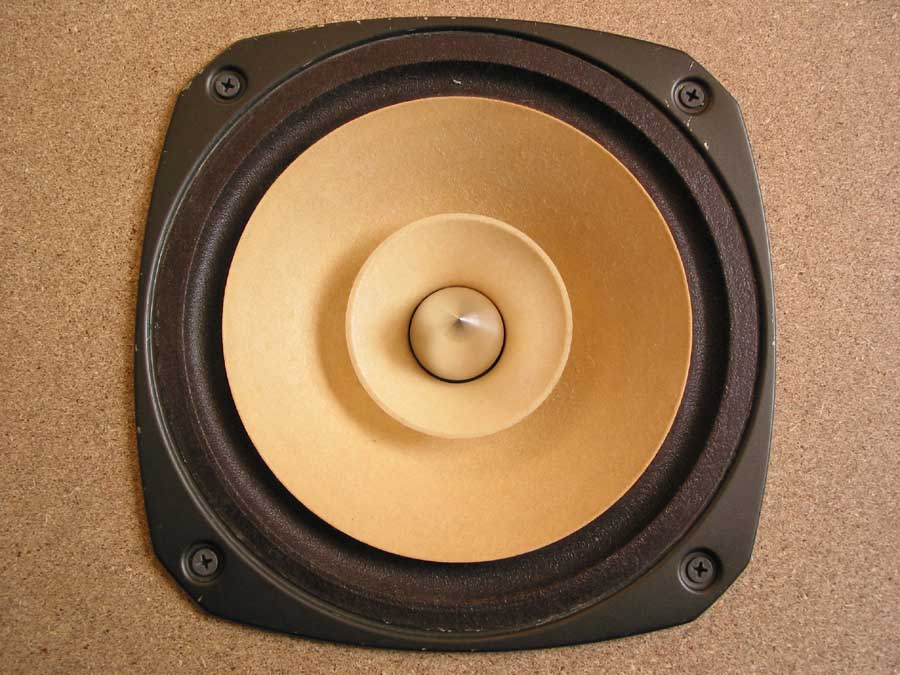

in these 2 drivers the VC sits proud of the cone leaving a nice V to fill up
I thought that the whizzer cone/ dust cap was rigidly fixed to the voice coil, but the main cone was connected to this assembly via a black rubbery compound, so that the whizzer cone could respond more freely to higher frequency signals without having the influence of the additional mass of the main cone to contend with.
Wouldn't filling this area stiffen this flexible coupling and modify the frequency response of the assembly? (de-sensitise the whizzer)
Correct me if this is not the case for these fostex drivers, as I only read this somewhere, and it may have been another type of driver.

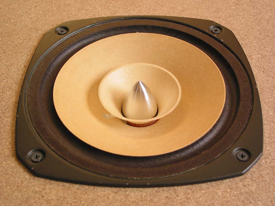

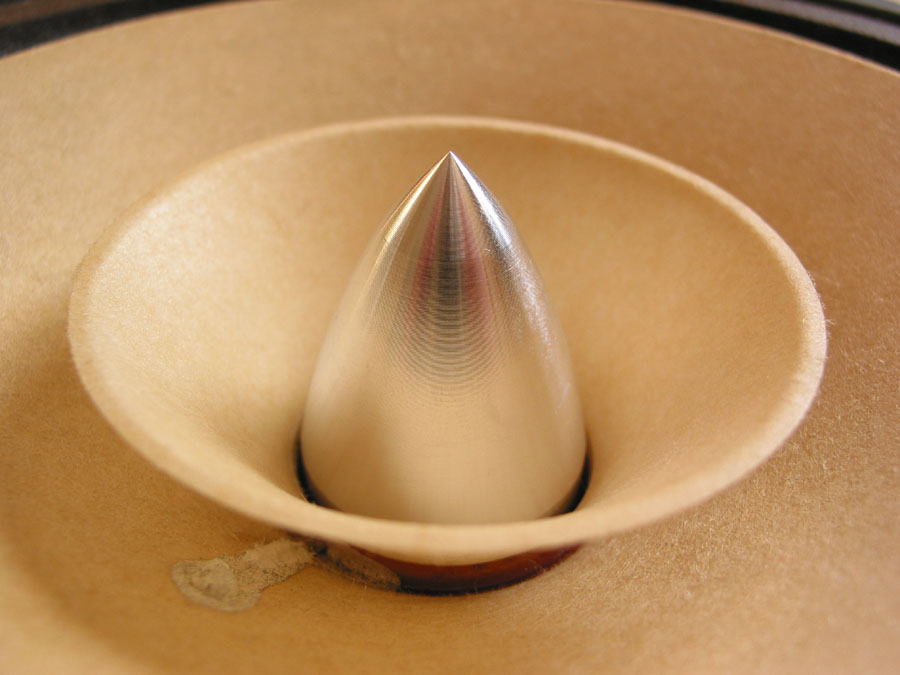

I made some phase plugs for my Fostex drivers. My friend is working with digital programable milling mashines and he did these for me out of aluminium. This is the first one. I want to try a couple of sheapes. There are much more highs and the sound is crystal clear with these fitted. Imaging and low level detail improved and the speakers are more smooth and relaxed. I will report how does it compare to diffrent shapes I'm going to try (maybe I will set a new thread about it). These are 33mm but it seems like 34mm would also fit. The height is 55mm.

zygibajt said:I made some phase plugs for my Fostex drivers. My friend is working with digital programable milling mashines and he did these for me out of aluminium. This is the first one. I want to try a couple of sheapes. There are much more highs and the sound is crystal clear with these fitted. Imaging and low level detail improved and the speakers are more smooth and relaxed. I will report how does it compare to diffrent shapes I'm going to try (maybe I will set a new thread about it). These are 33mm but it seems like 34mm would also fit. The height is 55mm.
Bartek
Looks like the shape is pretty optimized. What is the shape of the sides?
bobhayes said:Wouldn't filling this area stiffen this flexible coupling and modify the frequency response of the assembly? (de-sensitise the whizzer)
Neither of the 2 drivers i do this on have wizzer cones (variation on FE103)
I don't know if it's optimized. I will try a couple of diffrent shapes and will see which one I like better. I can't do any measurements becouse of lack of instruments, I will be examinating them only with my ears. The shape is straight 33mm untill some 2mm above the base of the whizzer.
how long should the tip of the phase plug extend? Should it be on the same level with the whizzer's outer surface?
I personally have no idea, but I don't think it should be much longer than Whizzer.
