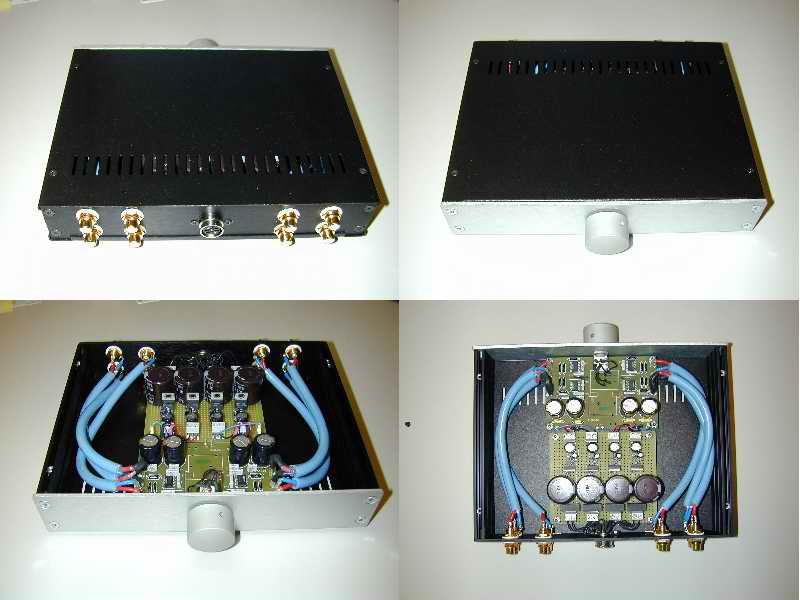

The first post asked if anybody had built it. I am happy to say that today the answer is yes. I am building an Aleph P but my PCBs are taking forever for me to finish. So, I built this one while waiting for myself. Seems to work perfectly. Resistors are Welwyn RC55Y and pot is Vishay/Sfernice P11. Local bypass is RIFA MMK. Sound is so far great and I'll use with my GCs mono blocks as my second system. PSU is 4 individual LM317 with adjust bypassing and a 10.000 uF filter cap each and then 47 uH plus 1200 uF Panasonic FC caps. This gives true mono build as PCB is galvanically separated sides. The transformer is in a separate box connected via 4 twisted pairs umbillical cord. Internal wiring is Supra EFF-1.

I have built the circuit omitting the first opamp and adding a simple push-pull outputstage taken from Walt Jungs book "Audio OP-Amp Applications". I have built the circuit on a small circuit card that fitted the Mark-Levinson JC-2 or ML-1 preamplifier with protruding pins. To replace defective line-modules.
Later I went completely discrete resulting in better sound but much greater complexety not fitting in the tight space of the ML preamp.
The opamp choice is very critical:
OPA 627 performs very well here, but also AD823 or AD744. It is all a matter of taste. With the AD744 sound was remarkably similar to the original modules.
