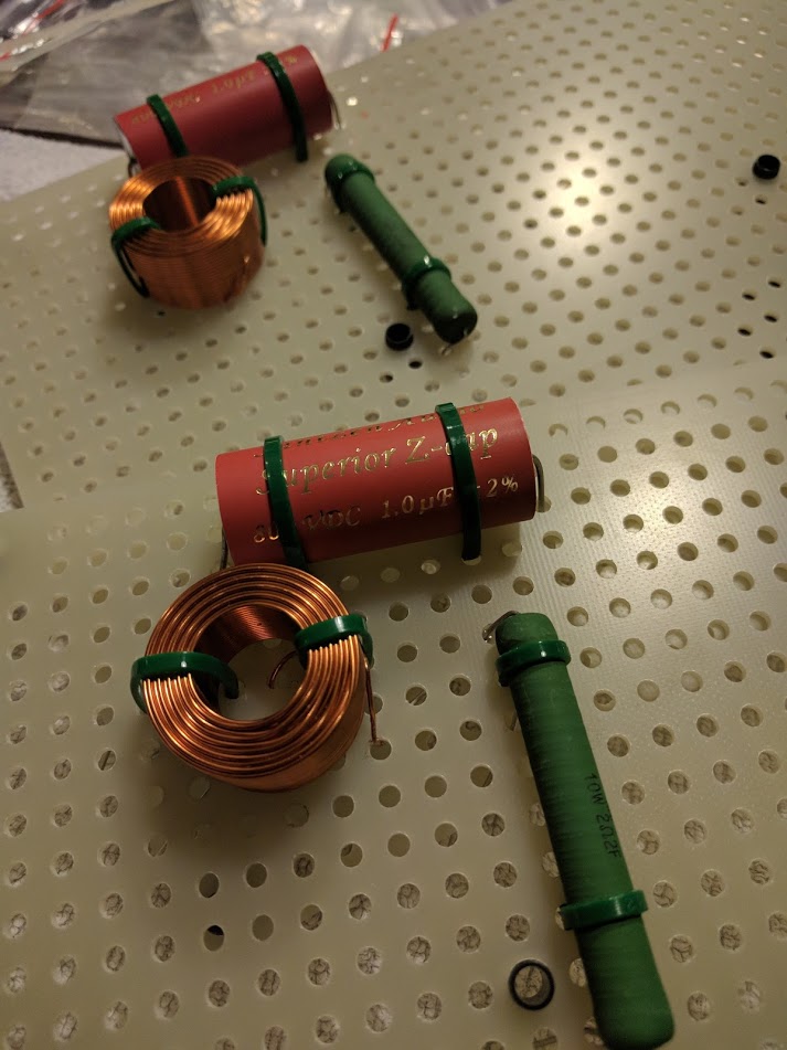

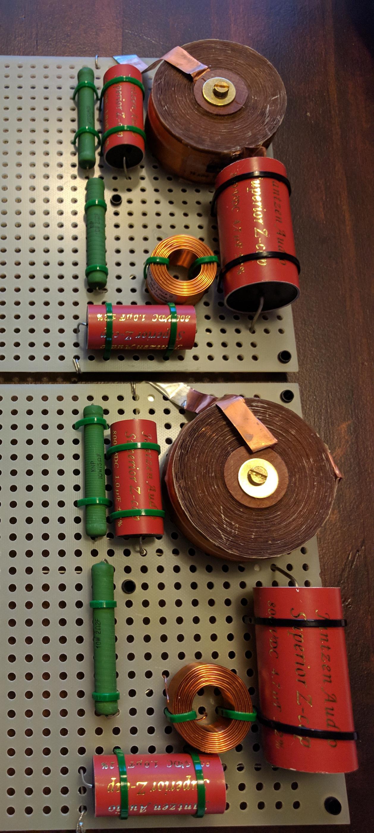

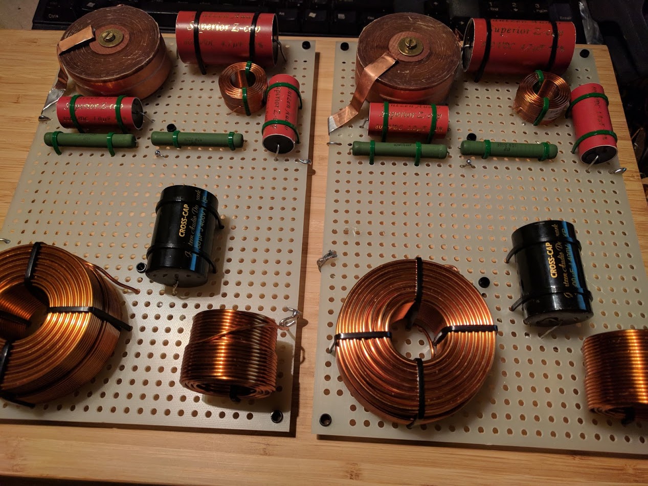

Ideally, You just need to get some measurements done to see If any tweaking to the crossover can Improve the sound. Or have you already done some measurements?
That would be ideal. But I have zero crossover tweaking experience...and/or measurement. That is the main reason I'm building the 18sound design exactly as designed.

I added a 1ohm resistor in front of the highs....and now it sounds much much better on the gainclone. Still to be tested on the valve amp.

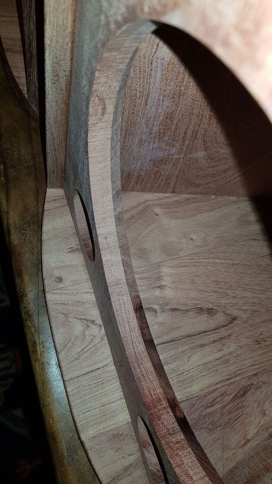

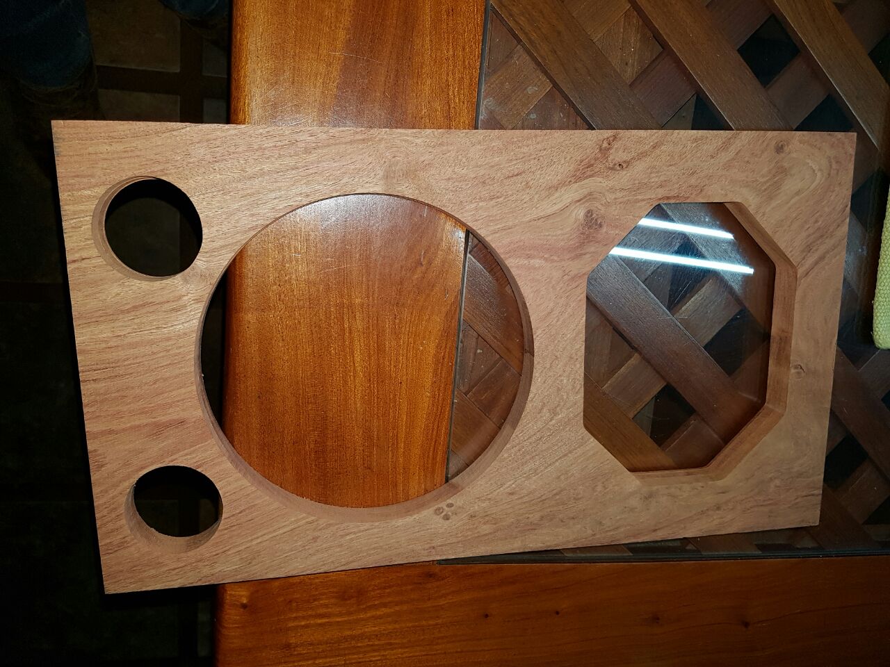

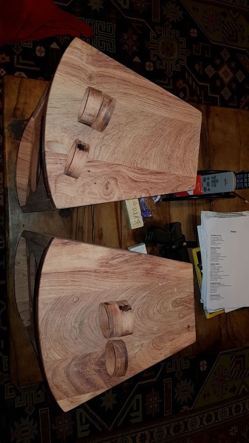

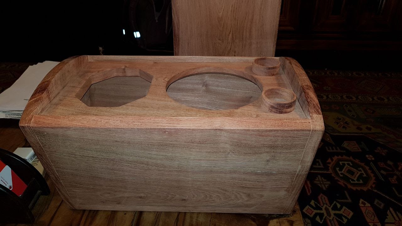

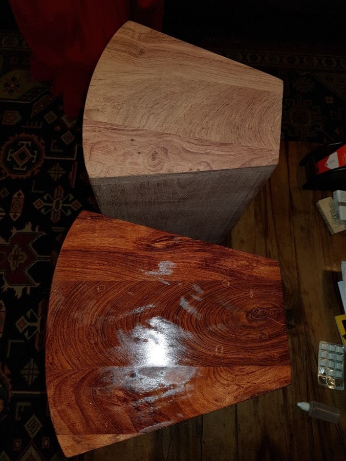

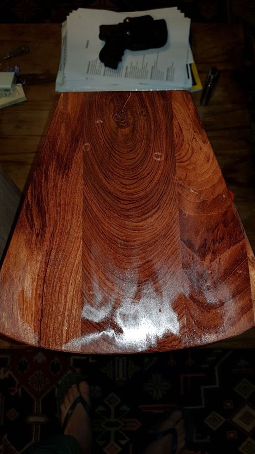

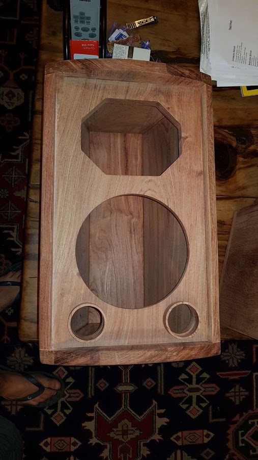

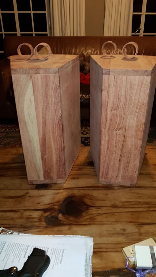

Progress...and a question. Would it be possible for the port to exend to the outside? We got ports cut in wood because that would look better. But the angles prevent it from going full length. So now we thought...wat if we go 2cm outside?
