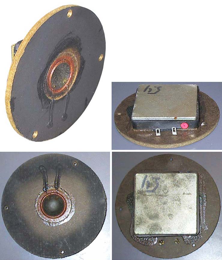

frugal-phile™
Joined 2001
Paper cone EPI tweeter
dave
