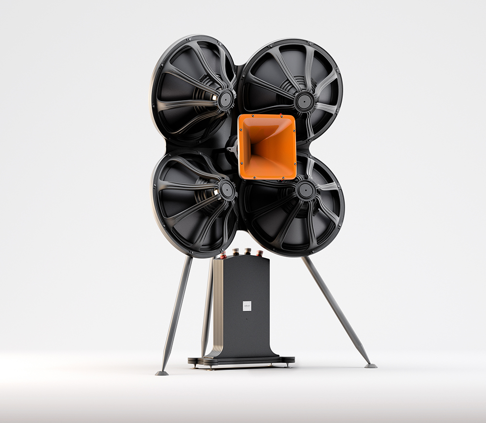

This has been done before but for the life of me I cannot find the speaker online.

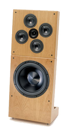

Here's something similar but sealed box. A diyer tried a similar arrangement here and loved the results.
DNA Sequence Speakers dipole open baffle woofer high efficiency point source array midrange tweeter treble loudspeaker
His white paper is interesting.

The audio would come from a source that is maybe fifteen inches wide (four 6" drivers spaced several inches apart) below the crossover frequency, and only about an inch wide above it.Any experience or thoughts on these configurations?
This means you have an enormous jump in sound dispersion pattern as you transition through the crossover frequency. The sound is tightly beamed below the crossover, and widely dispersed above it.
This is the sort of thing that ruins stereo image and the size of the "sweet spot" for listening. IMO it would be a real shame to pay a lot of money for a good tweeter, and then ruin its good sound dispersion properties by engineering a speaker design like this.
Though Beyma suggests a crossover frequency of "1 kHz or higher" ( Beyma TPL-150 pleated diaphragm tweeter - Beyma TPL-150 - Beyma TPL-150 high frequency tweeter. Beyma TPL-150 high frequency tweeter is available here at US Speaker. Beyma TPL-150 speaker components. ), the published frequency response suggests a crossover above 2 kHz would be better.
Severe beaming occurs if the driver diameter is much larger than a half-wavelength of the highest frequency being emitted.
By 2 kHz, a 15" wide woofer (or cluster of four woofers) will suffer from a lot of treble beaming, because the half-wavelength of a 2 kHz tone is only about 3.5 inches, which is much smaller than 15 inches.
This is the reason why 3-way speakers were invented, with a midrange driver that is much smaller than the woofer, and therefore able to provide good treble dispersion all the way up to its tweeter crossover frequency. Meantime, the woofer-midrange crossover frequency is much lower, so that the big woofer still provides good dispersion all the way up to the frequency when it hands over to the midrange driver.
Back to your idea, if you must use multiple drivers driven from the same signal (i.e. operating over the same range of frequencies), stringing them all in one vertical line is "less-bad" than an arrangement that spreads them out horizontally.
This vertical-in-line driver arrangement causes less-bad beaming in the horizontal direction (than the vertical). Less-bad dispersion in the horizontal direction is at least a tiny step in the right direction, because our ears are spaced apart horizontally, not vertically, our stereo speakers are spaced apart horizontally, not vertically, and because we ourselves are more likely to move about horizontally than vertically.

DNA guys could not make their minds either and went for the oblique
yes; similar idea
by inverting the drivers and using concave placement, they are trying to avoid beaming. Q is how effective is this?
if it helps beaming, what about lobing? (C to C distance vs. CO frequency)
my idea is similar; keep the MTM front firing and add two more inverted Ms.

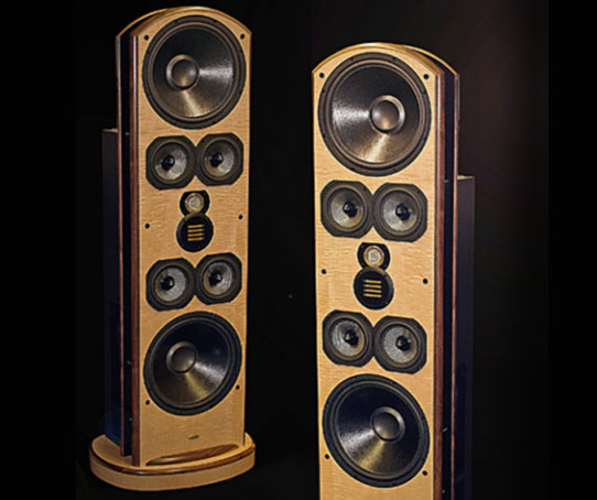

-Gnobuddy
yes, a larger driver starts beaming at a lower freq
however, diameter is not the only determinant; concave shape of the diaphragm also contributes, ie shallower cones beam less
in that sense the dispersion of 2x adjacent 6" drivers is probably not the same as a single 12"
furthermore, inverted cone drivers are omnipolar between certain freqs
thus my original question:
can we arrange 4 cone midrange drivers (2 inverted) in such a way that the dispersion is much better than a single 12-15" (and not worse than 6" MTM)
True. There is a specific amount of beaming determined by the physics of a flat diaphragm, and the frequency of the sound.however, diameter is not the only determinant; concave shape of the diaphragm also contributes, ie shallower cones beam less
You can make a speaker beam worse than a flat disc by using a cone instead of a flat disc. But, very importantly you cannot make it beam less.
In real life, woofer cone shape is to provide mechanical strength to the cone, not really to control dispersion.
We can get a rough idea how important the cone shape is by comparing the depth of the cone to the wavelength of the reproduced sound. If the woofer were to cross over to the tweeter at, say, 2 kHz, the wavelength is about 17.15 centimetres, or 6.75 inches.
The depth of the cone is probably less than an inch - a lot less than the wavelength of the highest frequency the woofer will be asked to reproduce.
Things that are much smaller than the acoustic wavelength have little effect on the dispersion. The depth of the cone will not have much effect on the sound dispersion pattern within the frequency range of the woofer.
The diameter of the woofer cone (probably about 5"), on the other hand, is nearly equal to the wavelength (6.75"), so we can expect considerable treble beaming due to the size of the woofer cones.
If four adjacent 6" drivers are mounted with edges touching, and axes all pointed in the same direction, they behave very similarly to a single circle with a 12" diameter. (Not exactly the same, because four 6" circles in a four-leaved-clover shape is not exactly the same shape as a circle.) That's what the physics says.in that sense the dispersion of 2x adjacent 6" drivers is probably not the same as a single 12"
The claim that the dispersion of four 6" closely spaced drivers is better than a single roughly 15" one would be easy to prove - we can believe it when someone shows us trustworthy (i.e. not faked) polar frequency response plots of both setups made under the same conditions, showing the improved performance. Until then, be extremely suspicious of the claim.
This doesn't compute - the front and back of a speaker behave pretty much identically, except for the magnet and basket blocking some of the treble radiation from the rear.furthermore, inverted cone drivers are omnipolar between certain freqs
Therefore radiation from the back of a speaker at bass frequencies is very similar to radiation from the front. There is no radiation directly to the sides, so no omni-polar radiation. What you get is the well-known dipole radiation pattern - sound to front and rear, nothing directly to the sides.
The whole idea of inverting two woofers doesn't make a lot of sense to me. They have to be wired electrically out of phase, otherwise the bass would cancel out. Once they're wired out of phase, and pointed in opposite directions, they behave pretty much identically at low frequencies - all four cones move in the same direction at the same instant - so there is no benefit (at low frequencies) to pointing two of them backwards.
But at higher frequencies, where the speaker magnet and basket assembly block some of the treble coming off the back of the speaker cone, there will be a difference. The two inverted speakers will individually do a better job of radiating treble (not bass) to the rear. Collectively - both together - they will suffer from the same problem as before, of behaving roughly like one 15" x 6" elliptical-shaped driver, i.e., dispersion will be worse in one plane than the other.
In short, pointing two woofers backwards is presumably to provide more treble to the rear of the speaker, and has nothing to do with improved bass in any direction.
Arranged in a single straight line, they are no worse than one single driver in one axis (but much worse in the other axis). Any other pattern almost certainly makes things worse than a single 6" driver.thus my original question:
If you must use multiple drivers all covering the same frequency range, and of a size comparable to a half-wavelength of the highest frequency they produce, then putting them all in one straight vertical line is less-bad than any other shape.
This is only because we humans tend to remain upright (and so have our two ears spaced apart horizontally), move mostly in the horizontal direction (we don't climb walls well), and so, are likely to be more tolerant of poor vertical dispersion than poor horizontal dispersion.
Again, polar frequency plots will tell the truth, one way or the other. Without proof in the form of those plots, be skeptical.
-Gnobuddy
"If you must use multiple drivers all covering the same frequency range, and of a size comparable to a half-wavelength of the highest frequency they produce, then putting them all in one straight vertical line is less-bad than any other shape."
What's wrong with this arrangement?
- Has anyone tried these MMTMM configurations?
