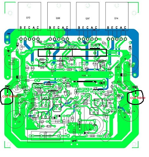

I would apreciate if Harry points out what is wrong with this layout, and I can make next one better.
dado
Hi Dado,
You may have spotted earlier that I mentioned that layout issues hurt my brain more than I would like. Figuring out if you have a problem is usually not hard*; the head-hurty bit is trying to figure out how to solve the problem! The bad news is that with your TT amp layout, I have done (some of) the easy bit in that I can confirm there are issues with it. On the image below, I have traced the current pathway for current from the +ve decoupling capacitor. Note how the loop area is large and that the loop partly encloses the front-end of the amplifier; not good!
Now you've got to do the hard bit, which is figure out how to make those issues go away. Have another look at my "improved layout" image which hopefully will help; start by bringing the power connection in at the horizontal midpoint between the PNP and NPN devices at the top of your board, together with the ground.
* To see if there are problems, trace out the current loops for tracks that will be carrying large currents. Remember when you do this that current always travels in complete loops; it can't just suddenly stop or start at a point (on the current path illustrated above, the loop is completed via the loudspeaker). Also, identify any tracks on the circuit that connect to a high-impedance node and try to keep these as small/short as possible, preferably protected by a reference plane or track nearby.

Dadod,
see the little bit of unused space between the leads of the two middle output devices.
Separate the output devices slightly, maybe an extra 5mm.
Now use that space to insert: the +ve supply, the -ve supply, the Power Ground and the Decoupling Ground (particularly the HF decoupling).
If possible the Zobel ground should also come into that area.
This brings all the high current routes to meet in that one small area and also helps reduce trace lengths.
Move the R//L off the PCB.
This operates just as well when located in the cable pair feeding the output terminals.
This remote location removes/attenuates the effect that the inductor may have on nearby PCB circuitry.

Thanks to all for your help,
As this PCB is already produced I can't change to much. Here is what I think could help. I will cut(look the picture) main grounds(GND) from were it go around input stage and take from new GND by wires to the star ground. I removed the coil from the PCB too. Were to place the coil could be a problem. Often loudspeakers terminal are quite close and if the coils are fixded to the terminals there we have a cross talk.
For the next Layout I'll try to implement "all" (its not easy task) what was suggested here.
dado

Hi Dado
If you feed V+ and V- in at the middle of the output transistors as Andrew T and Harry recommend then you can run the feeds to the collectors out and return the current from the emitters back on the other layer directly on top. This is what I recommended to Harry earlier - I don't see how the loop can be made any smaller than this, it is effectively only the thickness of the board.
