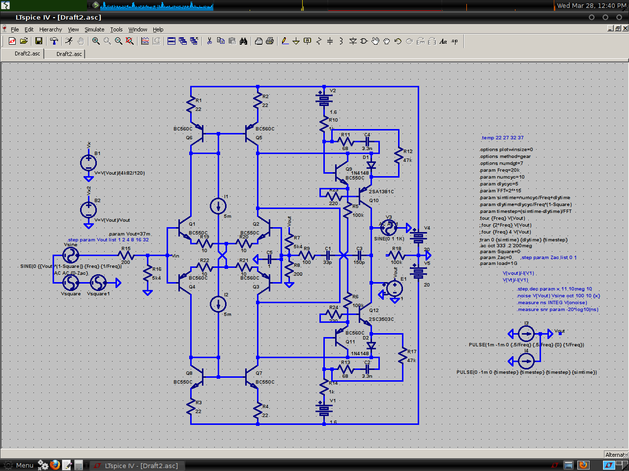

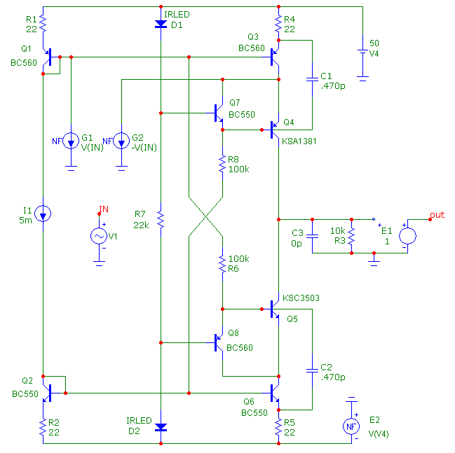

I found your capacitor trick to be entirely ineffective at curing oscillation in simulation, and it caused problems of it's own. This cascode has VERY specific needs. Specs are not as great after compensation, but this is a necessity.
Attached is what I came up with to stabilize the Baxandall cascode. This gets it stable, and with more extreme values it can be made unconditionally stable. I don't know if it can be stable any other way. The simulator suggests it has stability as-is, but I doubt it works like that in real life. Unfortunately this causes signal loss through the bias generator, but it's not too much at audio frequencies.
The diode is included to get the Baxandall driver out of quasi-saturation. Leakage between the base and collector (Early, w/e) decreases max output impedance (we control this specifically with the 47k resistor, which helps stability), so quasi-saturation is good to avoid. I'm not sure but I think it's necessary in real life. The 47k resistor is placed so there is no DC bias across it. May not matter, but why not?
Increasing the 1k resistor decreases the effectiveness of the cascode since it sort of degenerates the driver through the base. 1k was a good compromise, as far as cascode performance, but increasing it decreases signal loss through it and that may be more important.
If no one else has stabilized the Baxandall, let it be known that I was first!!!

Adding a diode to the emitter of Q10 and Q11 would get the Baxandall drivers out of danger of quasi-saturation, but I don't know if this would bring any benefits to the circuit. Maybe better PSRR. Using a Widlar or other suitable current mirror to increase the Vce of the current mirrors may bring an improvement in current balance for the same reason.
To a certain extent I share your concern about quasi saturation (I wish I had better models). On the other hand, I've seen many circuits with transistors operating at Vce ~= 0.6V. But if it works, I prefer it this way, as one of objectives was a near rail to rail output swing. This is because I hate using an elevated and/or separate PSU for the front-end.

Other people have reported instabilities as well, but I haven't encountered them yet. Dimitri Danyuk has built similar circuits (see his AES paper), but no mention about instability (BTW, the Baxandall transistors in his circuit operate at 0.6V). I have also simmed the circuit with other transistor models (2N5401, 2N5551, 2SA1407 & 2SC3601) but no sign of instability. So what's going on? Has it something to do with the spice models?

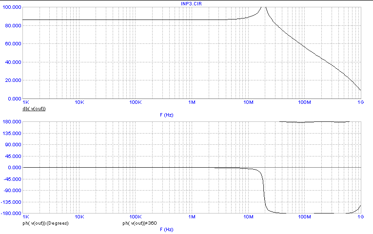

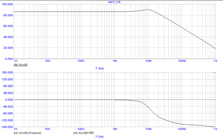

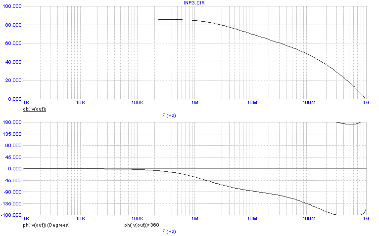

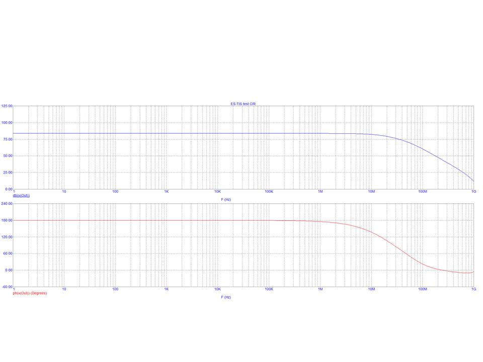

As for the capacitor trick (470pF), these caps do have an effect according the test circuit as shown below, fig.1.
Fig. 2: C1 = C2 = C3 = 0. It peaks at 19MHz.
Fig. 3: C1 = C2 = 470pF, C3 = 0
Fig. 4: C1 = C2 = 0, C3 = 10pF
As you see, no sign of instability with either of these caps.
Anyhow, can you give me the models of your transistors (in spice format, no LT format, please)? Maybe it will provide a clue.
BTW, the 100k bias resistors are wrong connected (not a fatal error, I think).

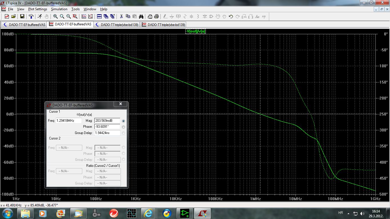

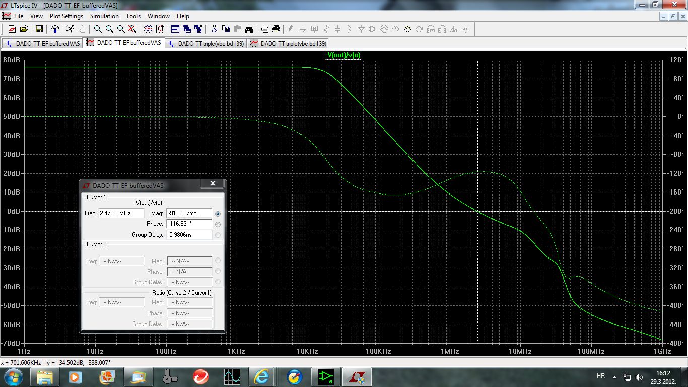

Here are two feedback loop gain plots. First one with TMC resistor connected after the probe, and second one is with TMC resistor connected to the output. I tried before to simulate the internal Miller loop but with very strange result and I think I am doing it wrongly.
cheers dado
E.

It is believable that there would not be stability problems at low Vce, if the BC junction had more leakage than the 47k resistors in my schematic. As I recall a normal BJT CCS can have 100k impedance just from C-B leakage, regardless of the emitter current feedback loop. The cascodes may not be operating in full capacity. SPICE may also be pessimistic. I found it was unstable, but would not oscillate, with 100k resistors which is why I increased them to 22k, so I could look at how to stabilize the circuit. Another reason to increase these resistors is to have higher slew rate.
In looking for instability you are looking in the wrong place. It will not occur as a kind of peaking in response. It is internal to the cascode current loop and occurs at much higher frequencies; to me it appears as a resonance or extreme phase shift around 100MHZ. It is easiest to observe if you hang a 1F cap to ground from the feedback point so the TIS operates open-loop at high frequencies. It is a kind of parasitic instability, but it grows until it throws the cascode into repeated saturation. If uncompensated, you may get away with it but the peaking will probably still be there, and the circuit may have anomalous problems.
Now I must read the new replies...
By "undonditionally stable" I mean it will be stable with any impedance load. Many circuits are stable without peaking normally but will oscillate into certain reactive loads.
The Baxandall cascodes seem to like to oscillate with 10u inductors at their output. A feedback loop can emulate inductances, and for this reason the cascode may not behave like a normal common-emitter circuit.
Hi Keane,
So it's an 'internal affair'. Therefore I've put a Tian gain probe at one of the Baxandall loops (circuit of post 44). Without any caps the phase/gain response is indeed problematic, on the verge of instability, but again at 19MHz, not 100MHz.
With a tiny cap at the output (10pF or so) the loop is stable (a gain margin of about 12dB).
