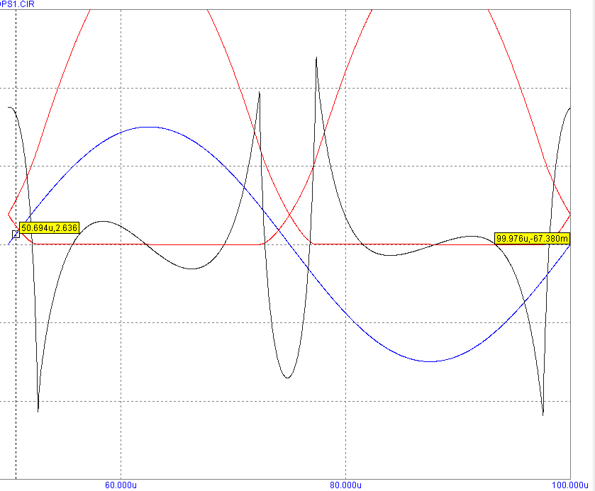

Has anyone seen this front-end before?
the device output , in common drain ,
exhibit a exponential or power law , i didnt check exactly at this time ,
at level from 0 to 0.1V Vgs.
It's a power. The standard mosfet model in Spice doesn't have any provisions for modelling the subthreshold region.
The Renesas devices have only 1S transconductance. You need no less than 5 pairs to match the transconductance of a K1530/J201 verticals and about 10 pairs to match the typical transconductance of a IRFP240/9240 pair. It is unlikely you could use the Renesas laterals to feed 4 ohm loads, if you also consider the load impedance dips.
Edmond, I would be very glad to have any realistic models for FETS you know of, obsolete or not, and I ask you put them here or link to their source. The EXC10N16/10P16 models from Exicon have very smooth crossover behavior, so I thought they were faulty, but now I am not sure.
.MODEL ECX10N16 NMOS (LEVEL=1 VTO=-66.415M KP=20U L=2U W=76.3794M GAMMA=0 PHI=600M LAMBDA=3.44617M RD=244.181M RS=178.517M IS=10F CGSO=100P CGDO=100P TOX=0 NSUB=0 TPG=1 UO=600 KAPPA=200M RG=367.902 RDS=16.0012K )
.MODEL ECX10P16 PMOS (LEVEL=1 VTO=56.1959M KP=20U L=2U W=49.9039M GAMMA=0 PHI=600M LAMBDA=16.6941M RD=458.28M RS=214.674M CBD=1.00674N IS=10F CGSO=100P CGDO=100P TOX=0 NSUB=0 TPG=1 UO=600 KAPPA=200M RG=35.8793 RDS=1MEG )
Hi Keane,
You will find them here and here.
Notice that the syntax of these models has been adapted to MicroCap rules. For the LTspice syntax see Andy's models.
As long as one can buy these FETs, I wouldn't call the models 'obsolete'.
[models]
I'm sorry to say so, but they are simple level1 models, which don't support sub-threshold conduction. The picture below (black curve) shows the effect on the distortion residual. Around X-over you clearly see the large spikes, which shouldn't be there.
E.
