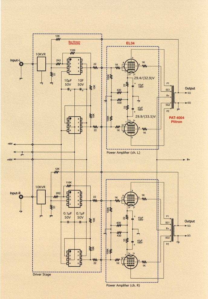

Has anyone played around with this as an amp front end?
Another one has seen the light.
One little red driver board + 2 big Fuji mosfets + two unsuspecting output tubes = big power and low distortion.
The "low distortion" part is the one that surprises me... I expected to see more nastiness, but at least with what I've looked at so far, it's pretty nice!
I'm probably working almost an order of magnitude lower in power than you are, though :cool:

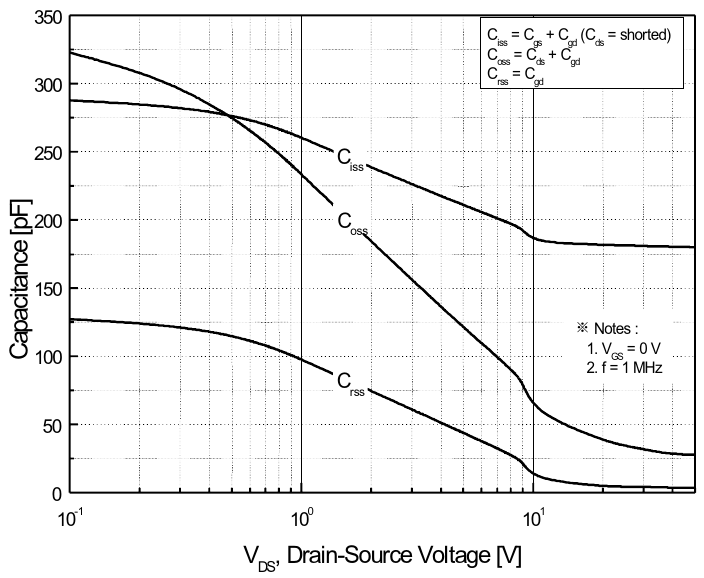

It shouldn't. If you get that Vds up (attached) internal capacitance isn't a problem. In follower operation, the input capacitance problem goes away as the gate and source are at nearly the same potential, greatly reducing the current through Cgs.
Distortions aren't created equal. The very low output impedance, much lower than for any hollow state device (low single figures for Rd(on) ) goes a long way to get rid of a lot of distortion when taking any VT into Class *2 operation. The 1624 spec sheet gives some impressive THD figures, but with the provision that driver Zo not exceed 500R. That's quite an order for hollow state, but easily attainable with a source follower. Even slapping around screen grids is NBD for a MOSFET. Whatever distortion the MOSFET produces due to parametric frequency multiplication is of much less importance.
