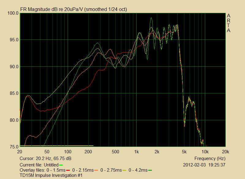

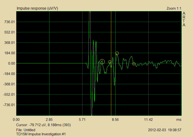

Okay, here comes some data. This post: impulse, with frequency responses at various gate times. The key on the freq. response plots also corresponds to the circles on the impulse response. The peak before each gate time is one that makes a significant difference. I only included new gates and responses for the peaks that make a significant difference in response. Time zero referenced on the response plots is the start of the impulse, not the time zero shown on the impulse. The next post will show time windows after the start of the impulse, as requested.
Between gates 1 and 2 in the impulse is the blip that is not a consistent feature. It is something with my cabinets that I should be able to fix.

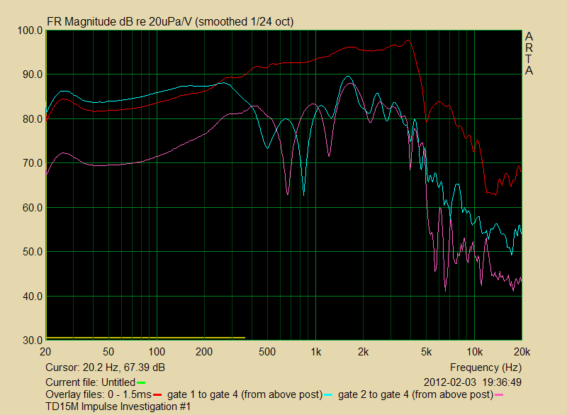

Here are two responses from time windows restricted to the area of interest. Sorry I had to change the magnitude scale from above. All gates are uniform here and above, btw - no hanning taper. The pink one (I think) is the real subject here, while the blue one includes the cabinet-related thing I should be able to figure out on my own.
I hope you can interpret how this refers to the previous post - it is hard to make this easy to follow!

I'm not sure I understand what you're saying - you realize the 2.45ms cannot be any normal reflection, right? If you're saying there's too much other stuff going on to examine the 2.45ms issue, I may need to use a measurement without the 1.7-2.0ms reflection instead of just trying to start the gate after it. I'll give that a try next.It looks like reflections are getting in once the gate moves past about 2.5ms, as the question about the 2.45ms issue would suggest?? Are you sure you're reflection free more than 1m in all directions?

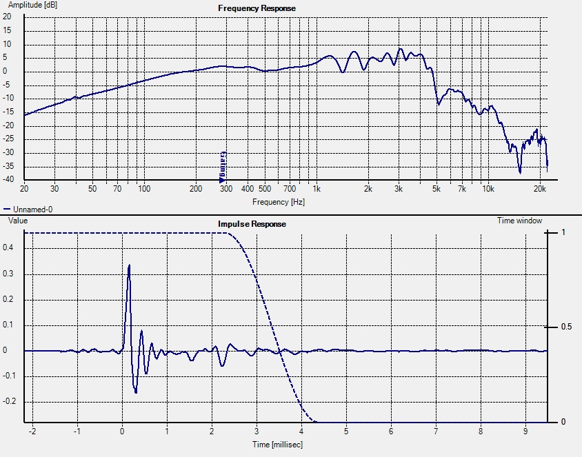

Here's a measurement in HOLMImpulse, for a different look at the same thing (it decided to call the main issue 2.25ms). I'm not sure why HOLM is giving me this junk before the impulse right now, but arta is not and gives the exact same response (if the same gate is set), so I wouldn't worry about that.
I thought there was something else to eliminate before 2ms, but now I'm not so sure about that because I can't do anything that reveals a separate effect from what happens most dramatically at 2.45.
No, because it appears with no baffle too. The 2.45ms thing, as I have been calling it, cannot be any sort of diffraction/reflection unless it comes directly from the woofer. The discussion linked above concludes that it's multiple resonances. The questions now, as best as I understand, are:could it be a baffle edge diffraction effect?
1. Is there anything else in these measurements that should be dealt with? Or, can we even tell?
2. What the heck part of this data should I use to sim/design my crossover? (see gating comparisons above, although I'll have to go back to measuring from farther away).
3. Is it remotely possible to do anything about this in the crossover? I'm just not sure how to figure that out. I think I understand that if I use a hard cutoff gate to isolate it in the impulse, that would direct me, but ARTA won't let me gate so few samples, and HOLM seems to only do hanning tapers, so I guess I need a third software option to do that.

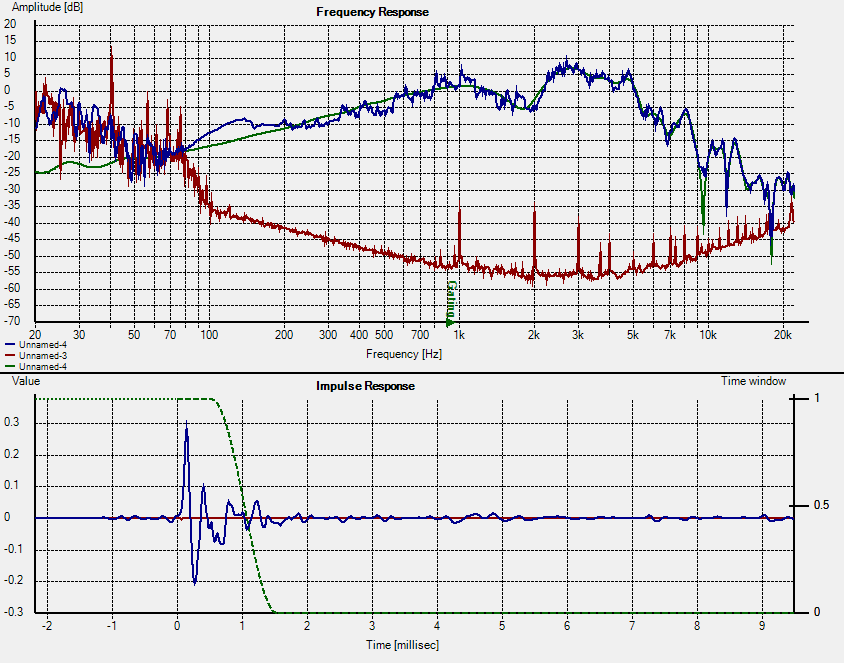

1audiohack's requested sanity check attached. Measurement is not of the driver being discussed, but rather a Weber Signature 10" ceramic guitar driver.
red = measurement of room. No, I do not know what's going in the bass, but obviously that isn't real.
blue = driver, ungated, log sweep starting at 100Hz
green = driver with gate shown
