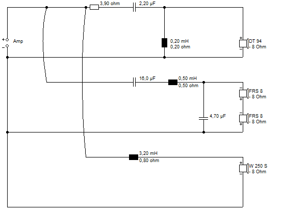

What good is a thread without a picture here?
I always thought the Wharfedale E70 was a terrific speaker. The E stood for efficiency and it was much better than the old BBC style bextrene designs that defined the seventies up till then.
I would compare it to the 15" Tannoy, which had similar slam and detail. The twin mids is a good trick too. That became more familiar in later D'Appolito designs. Doubled drivers project better, to give a PA type sound.
I can't say what the filter was exactly, but BW3 I'd expect. I think if I ever build a three way, it will be like this.

There is nothing particularly complex with regard to the original E70 crossovers. They do have selector switches which insert attenuating resistors into the mid and treble driver circuits and I wonder if that is where at least part of your problem lies.My doubts about it now centre on the fact that they (the crossovers) are much more complex than the Wharfedale ones shown on an old circuit sheet I discovered.
I may dig out the simplified crossover circuit, minus the switches, which accompanied the kit version of the E70, to let you see how it compares with the circuits that you have mentioned.
If you could post a photograph of your crossover board and, indeed, of your drivers and enclosure, we may be able to relieve you of your befuddlement.
P.S. I see Steve has shown his version of the crossover in post #32.
I have compared the Wharfedale Speakercraft kit version of the E70 crossover with the one Steve showed in post #32.
The differences are minimal. Wharfedale shows the tweeter resistor to be 2.2ohm and the woofer inductor to be 2.0mH.
Just for reference, the parts numbers for the Speakercraft drivers were:
Tweeter: ET/02/1
Mid (x2): EM/10/1
Woofer: EB/25/1
Tweeter: ET/02/1
Mid (x2): EM/10/1
Woofer: EB/25/1
