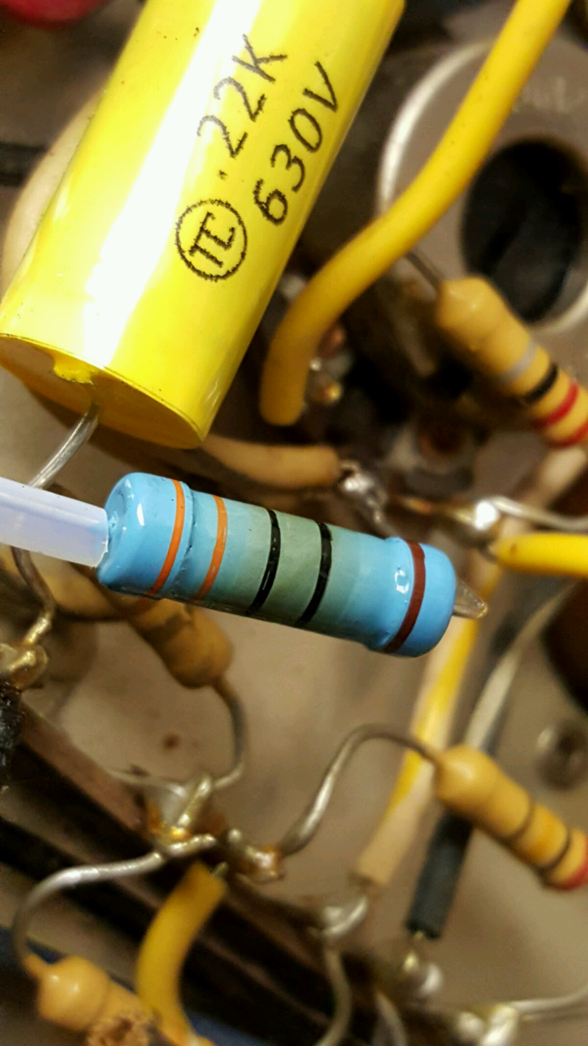

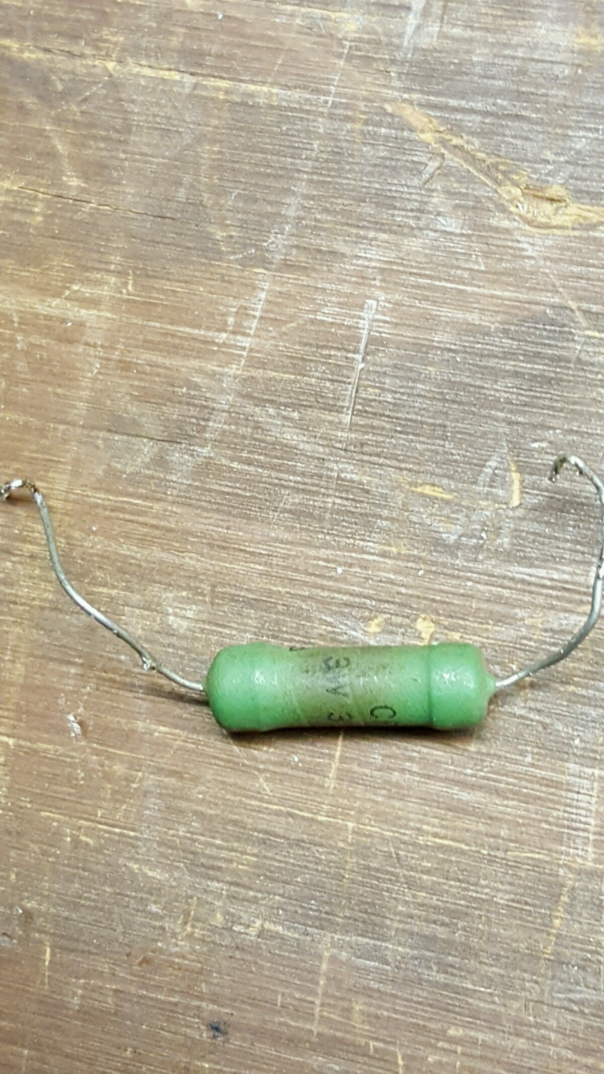

Chris replaced the output cathode 330 ohm 3W output catode resistor with metal film. You know that metal film is warm just by the smell of the coating cooking. Can't help but think the original green resistor is more robust?
Hi Bob,
That resistor is already discoloured? Wow. There is supposed to be 106 mA running through it, meaning that you are dissipating 3.7 watts of heat. That should have been a 10 watt resistor. The old part is looking toasted pretty well also. What does the resistor in the other channel look like?
Normally a 3W resistor would be dissipating 1 to 1.5 watts maximum, so that would be about 18 volts across that resistor (1 watt). You're not far off from double that amount! I can't believe that they messed up that design so badly. It's even off from 1.5 watts (would be 22 volts in that case). Is there anywhere you can check to see if that 35 volts is really what they want there?
I normally use metal oxide resistors for high dissipation positions, and wire wound for anything 5 watts and higher.

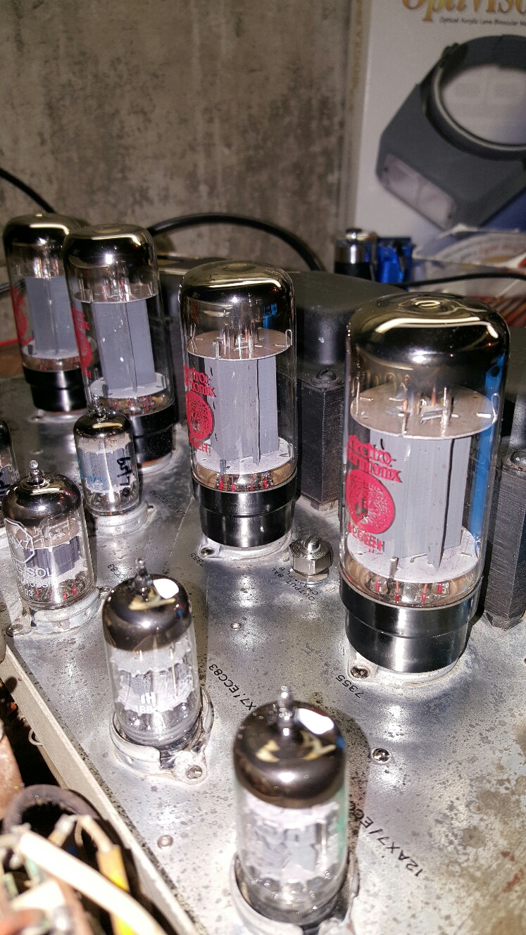

I recently was gifted a Harman Kardon A50K integrated that seems to be in pretty good shape, by that I mean it is very clean inside and there are no signs of any hack work being done, the outside cleaned up really well with a clean chassis it has all the preamp subes but I need to purchase power tubes I found some Electro- Harmonix 7591A tube at Upscale Audio near my house. I am not having great luck finding 7533's . What needs to be done to use the 7591A's ? Thanks
I used the 7591A tubes in my Eico ST70, and normally use Electroharmonix for design work and my servicing business.
I found a manual for an A500 that uses 7355 outputs. They are a beam power tube, the 7591A is a Pentode. So first blush, I would be looking at something like a 6L6GC, but more careful examination of the characteristics between them is required. First check heater current to rule tubes out that draw too much (over 800 mA). The plate is rated for 18 watts dissipation, so a 5881A is closer at 23 watts, but still a 900mA heater current draw.
The grids and cathode pins need to be rewired to use the 5881A or 6L6GC types, and the bias network may need to be adjusted for the proper current (cathode resistor values). The extra 400 mA heater current may or may not be okay depending on the transformer. Replacing the #47 lamps with LEDs may help a little bit.
Absolute minimum service will be to replace coupling caps, and I would change the filter caps for sure. Use CE manufacturing for those (www.tubesandmore.com). If you replace any resistors, don't use the old carbon composition types, but you must look at the voltage rating specs for new resistors! You cannot "cheap out" by leaving the original coupling caps, that may cost you output transformers, power transformers and output tubes.
