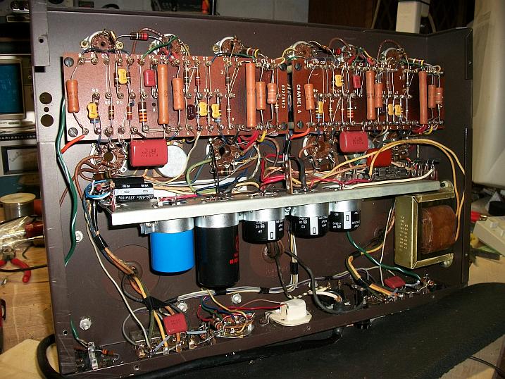

I recently finished rebuilding a HK Citation II amplifier using parts supplied by Jim McShane. The only thing I don't like about the Citation II is that it is so freaking heavy at 70 pounds...
Here is a photo of the underside with Jim McShane parts.
Sal
Sal
