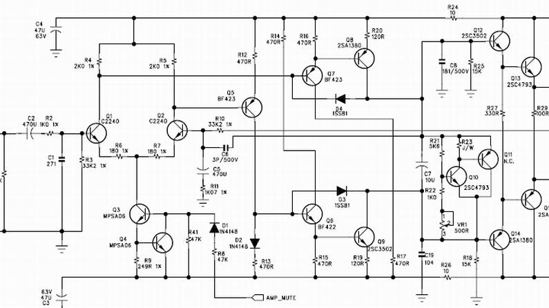

I have already made the comparison with Symassym
The HK630 circuit was assembled and compared.
Symassym win in bass extension, also in dinamics, had almost the same voices with sligth advantage to Symassym 4, and the model 4 lost in hi frequency extension and quality to high end.
Symassym 5 was listened but not compared....i think it will win the Harman... and with a very good advantage...but...i did not made the comparison of this unit with the Sym 5.
The HK distorted diferent, very nice, and produced more brigth in the trebles....this was perceived, my subjective point of view, in A to B comparison made monthes ago.
Comparing those two amplifiers..i think you will decide to keep both near you.
I made the comparison last January, and i have used the same transistors used in Symassym....as i use to do, not to be fooled by different transistors.
The Amplifier was dismounted because the parts, but really i am thinking to construct it once again....also the 430 sound very good, and with more details...even better, despite older.
Now i am thinking in the 670....i think i will assemble the baby monster.....80 watts over 8 ohms with a very small distortion and the dinamic headroom easy goes to 120 watts rms.
The Harman Kardon is a hell good unit, and Symassym is hardly guaranteed.

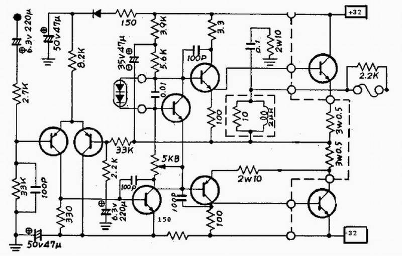

I am feeling passion for this one..... very similar....topologie is the same as HK670..... a more modern amplifier.....near the new century, this time we are living.

I have used in this schematic:
2N5401 for differential...gain 120...from Fairchild
2SC1819 for voltage amplifier, gain 70, from Mitsubishi or Matsushita...not sure...the three diamonds painted.
BD139 was used for voltage amplifier, gain 100, from Philips
2SC4793 and 2SA1837, drivers from Fairchild, gain was 80
2SC5200, big output from Toshiba was used ...gain 90
Driver`s capacitors were removed.
Voltage amplifier capacitor reduced to 22pf, silver mica
The series diode, in the positive rail, received a switch to by pass the unit....so...it was tested with diode working and diode bypassed....i suggest you to keep the diode.
