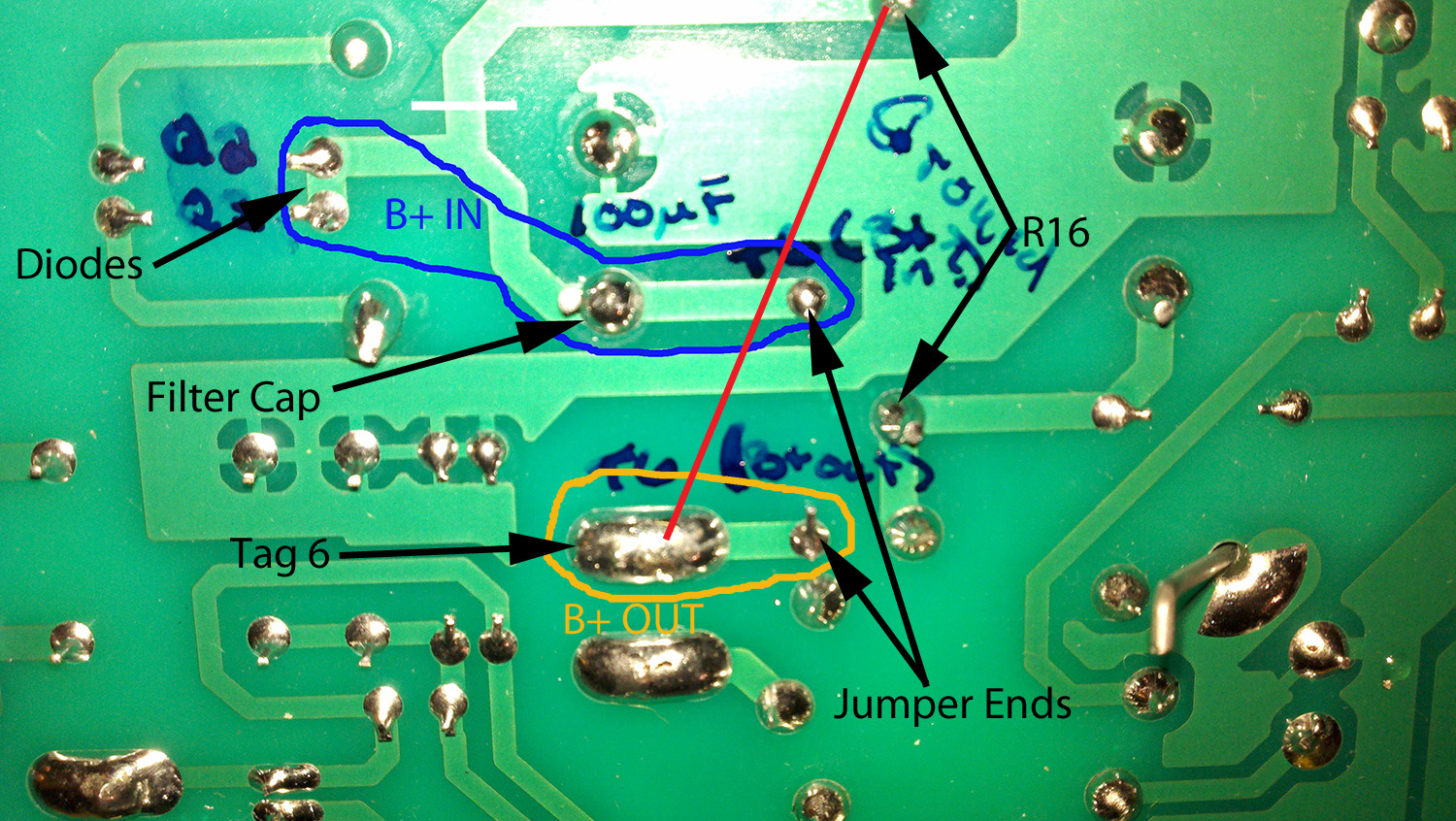

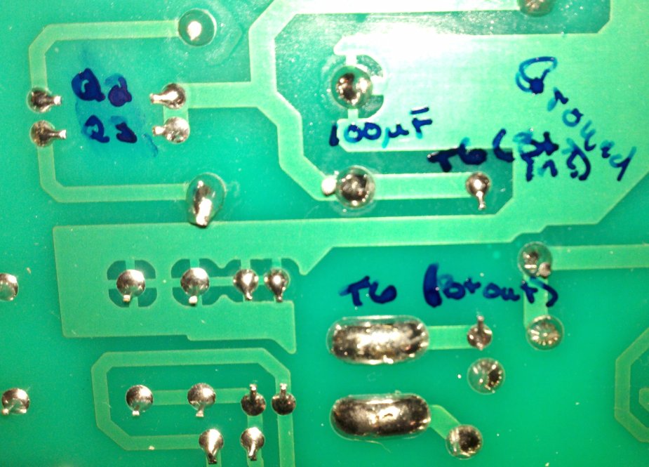

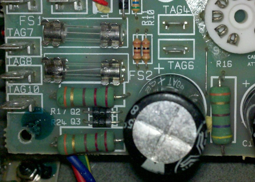

Okay, so I located the relevant part of the circuit board and I think I have an idea of where to solder in the VVR. If you look at the of the front of the board, the lug labeled "Tag 6" is the spot where the wire from the OT primary attaches. ("Tag 4" is the other end of the primary that runs to the anode of the EL84.) There's a jumper from the T6 lug to the node shared by R16, Q2, Q3 and the 100 uf cap. In the photo of the back of the board I have the lug side of that jumper labeled "T6 (B+ out)" and the other end of the jumper labeled "T6 (B+ in?)" I also labeled the locations of the two diodes and the big cap for reference.
Can I take the jumper out, and wire in the VVR in its place?

Nevermind... I see that that would put R16 on the wrong side of the VVR. So...on the photo of the back of the board, the solder connection in the upper right corner is one side of R16.
What if I drill a hole just to the left of that R16 solder joint. Then I remove the jumper that's there (between the points I have labeled as B+ in and B+ out) and instead jump from the T6 lug to the new hole next to R16, then solder the B+ out right to the T6 lug? Then I cut the trace to the left of the hole I drilled and use the point labeled as"T6 (B+ in?)" for B+ in?
Or is it okay/better to disconnect the end of R16 from the board and solder a jumper right to the free end of R16 and to the lug at T6 and solder the B+ out to the same lug?

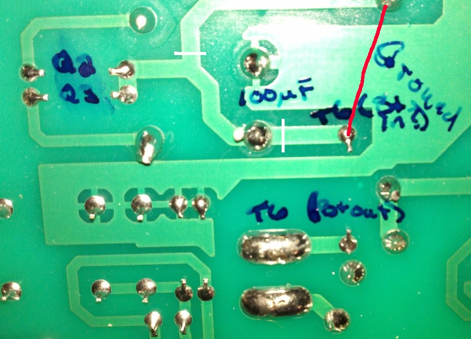

Vincenz - since you said you were having a little trouble registering on sewatt.com, here's a pic of the mod the way I did it, and what I posted on the forum:
I've attached a photo of the front of the board for reference and a photo of the back of the board that's marked up with my proposed installation. This is what I'm planning to do:
1) Remove the jumper that connects Tag 6 to the trace connecting the diodes, the first filter cap, and R16.
2) Make a cut in the trace at the white line just above the diodes.
3) Connect a jumper (red line) from R16 to "Tag 6."
This should divide what was previously one node (the diode output/OT input trace) into two separate nodes for B+ OUT and B+ IN as I have them marked in my photo. It also leaves two vacant holes in the PCB that can be used to solder in the VVR.
It's working fine.
