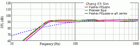

Getting back to the original question, will the B20 produce more bass because of its higher Q in the same box? I would imagine they would hit a similar SPL level because the Fostex would be 3 db louder per watt, but the B20 has double the excursion capability.

Since the Changs are all BR cabinets at heart, I'm going to guess that the B20 will have a pretty good sized peak in the bass if put in the same cabinet. Having a higher Qts, the B20 wants a bigger box volume. Of course, in WinISD, even with DiYer measured specks, if put into an "optimal" BR box, the B20 will be pretty flat down into the 30s. Put a big vent or two on that size enclosure, and you're going get big and deep sound. Of course, we've got at least one Chang builder using B20 and maybe a couple who have built Half Changs for their B20s, so you might want to hunt around for their comments and impressions.

No, the B20 will exhibit a touch less bass (gain) actually. See attached. Not half bad though. Supposed to be a lovely driver for the money. Wish they didn't cost such a daft amount in Europe or I'd have bought a pair before now to play with.
Yeah, I did similar things myself a while back (on paper / screen). Lots of interesting combinations available. :)
