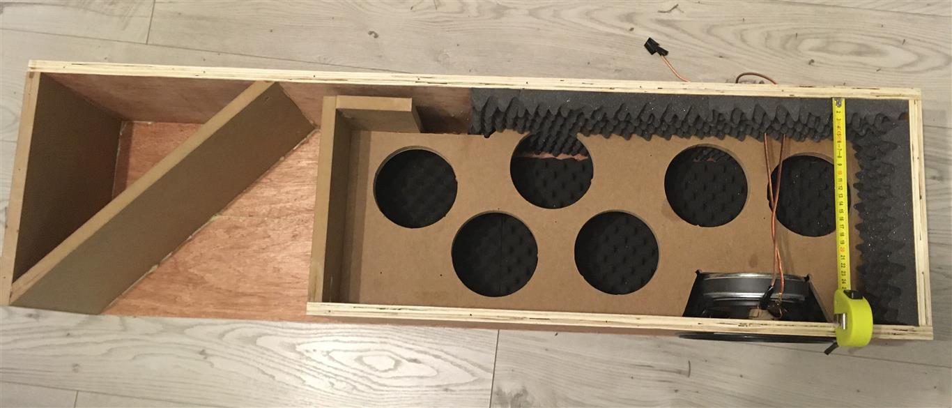

I finally assembled my Half Changs. Not yet finally sealed, just with a coulpe of wood screws. First listening impression was too much HF. Then with 3.6R in series much better.
Acoustic instruments and female vocals sound awsome!
The only concern I have is quite poor bass, which I have expected to be more solid and simply stronger. I don't need to rumble my house walls, just would like to hear a solid drum foot or bass guitar.

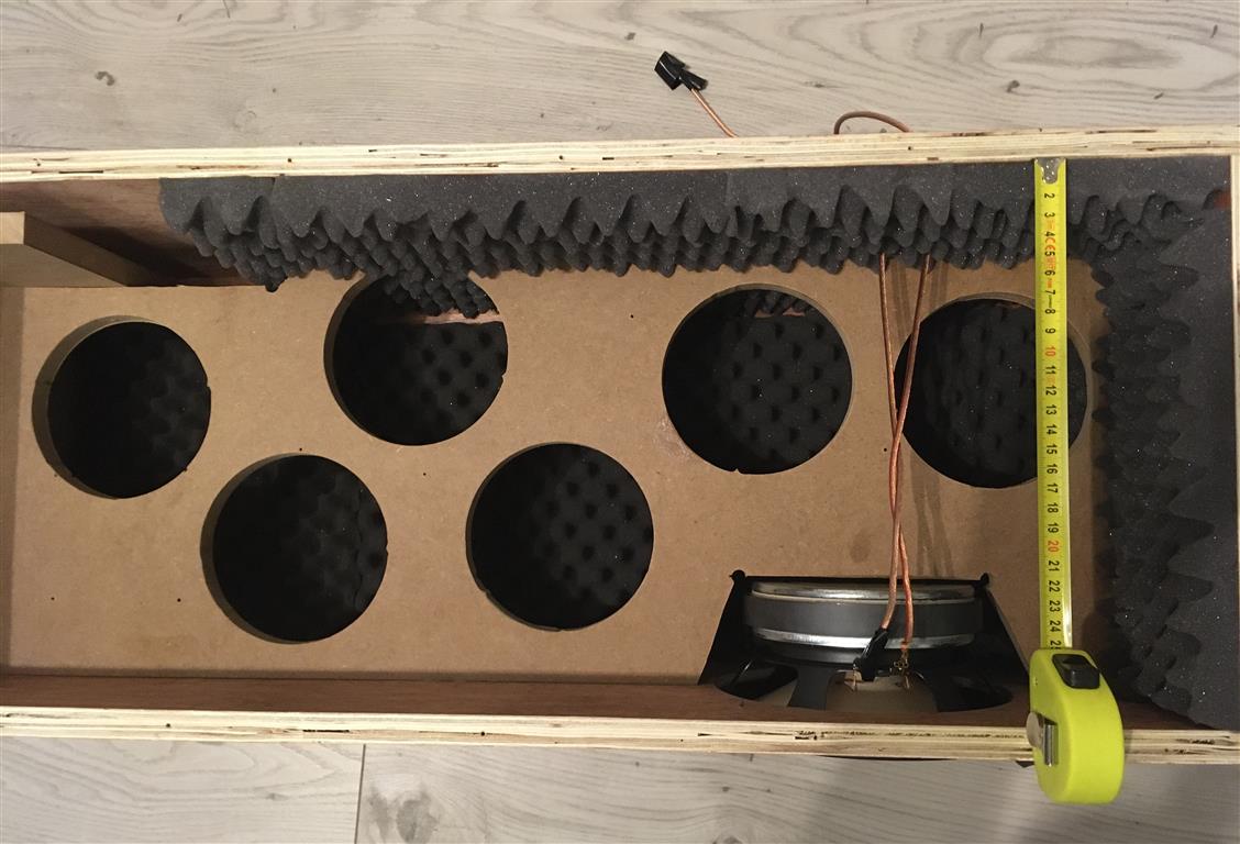

The cabinet is lined by egg crate foam - top, back and one side, as recommended.
The foam is one inch thick.
Please have a look at the pictures and advise.

I would like you just validate the lining, before I finally glue them.

Foam does not work well… the 1st thing is to replace it.
dave

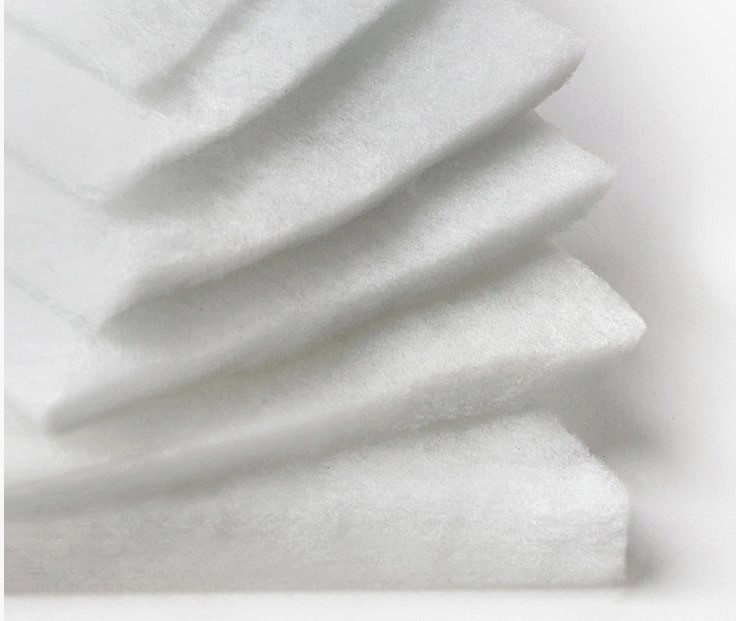

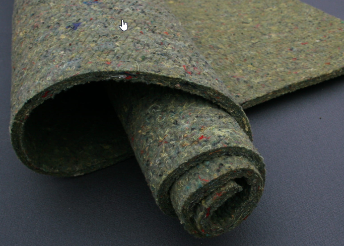

I don't recall ever recommending grey egg-crate acoustic foam. Most of my designs specifically recommend not using it. As a material it has its place, but I generally avoid it. Acoustic fibreglass or natural fibre materials (jute, cotton felt / wool felt, Ultratouch recycled denim etc.) tend to work better for this application.
Will the felt 10mm thick and density 1000g/sqare meter do?

Instead of a felt I can also obtain polyester low density wad (250g/sqare meter), like on the picture.

So the natural felt 10mm thick and density 1000g/sqare meter will work better?
I haven't permanently attached the last side yet, as I want to solve the lining issue before. For a test the side was attached with a dozen or so of a wood screws.
Finally I intend to attach it with a polyurethane glue, which will also seal the slits.
