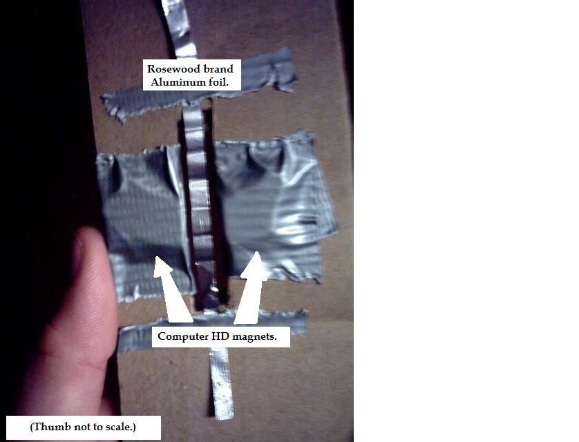

Here is an only slightly related picture of this afternoon's sonic folley. Proving to myself that ribbon speakers actually work.
Note: the T/S parameters are outstanding. Also that i could melt holes in the aluminum with my amp cranked...
