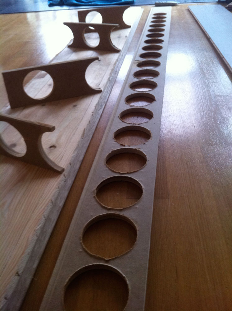

I have made one front baffle, drilled 20x 76mm (3") holes, trial fitted 20x Vifa, and drilled 80x 2,5mm (3/32") for the mounting screws.

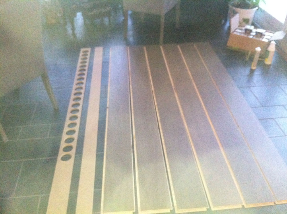

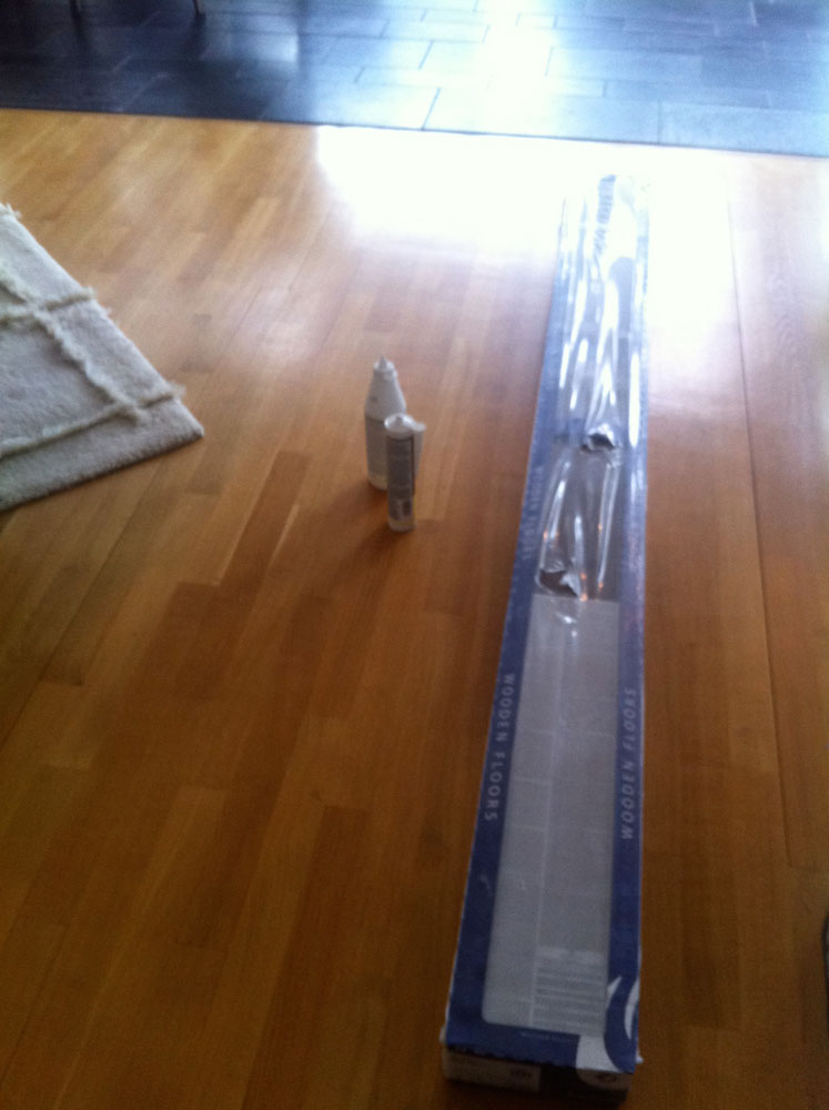

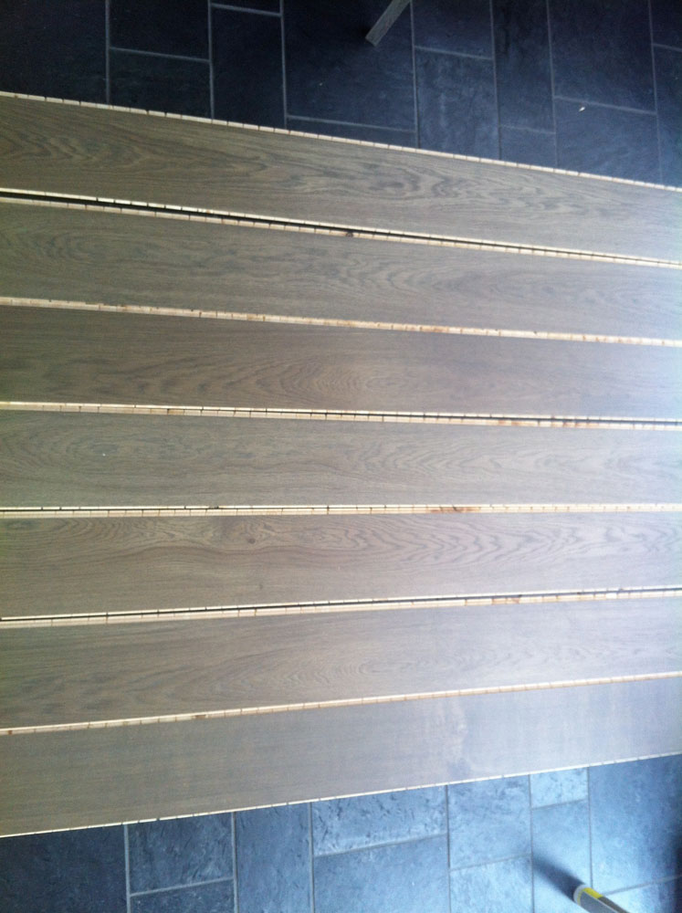

1 - Just home after purchasing wood flooring, these will serve as the cabinet sides.
2 - Wood flooring and TC9´s
3 - Slight color variations between the different floor boards

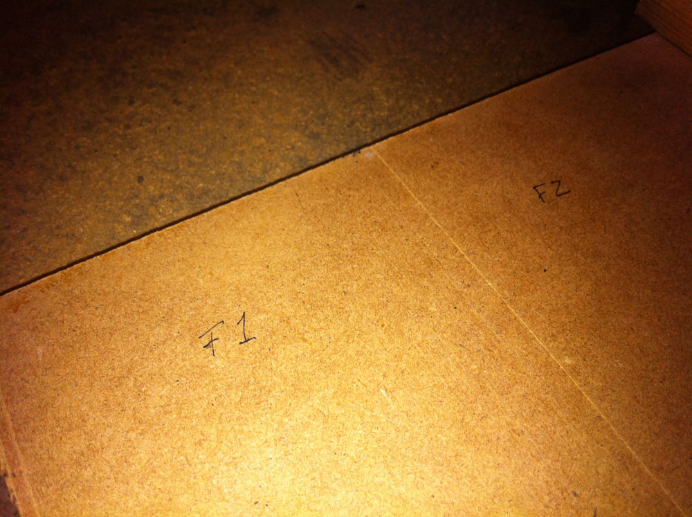

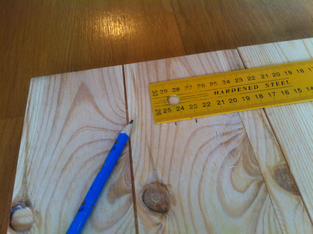

4 - Cutting guide and MDF underneath
5 - Cutting lines for front baffle 1 & 2
I really would like a better and more precise circular saw - and a cutting table! :)

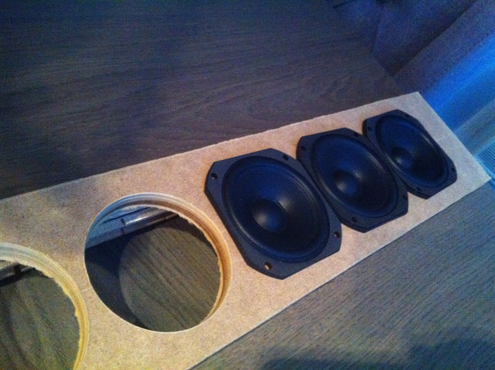

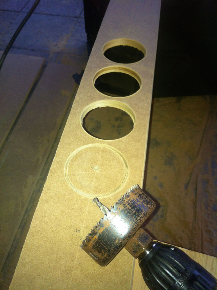

6 - Once the baffle is cut to correct width holes are about to get made...

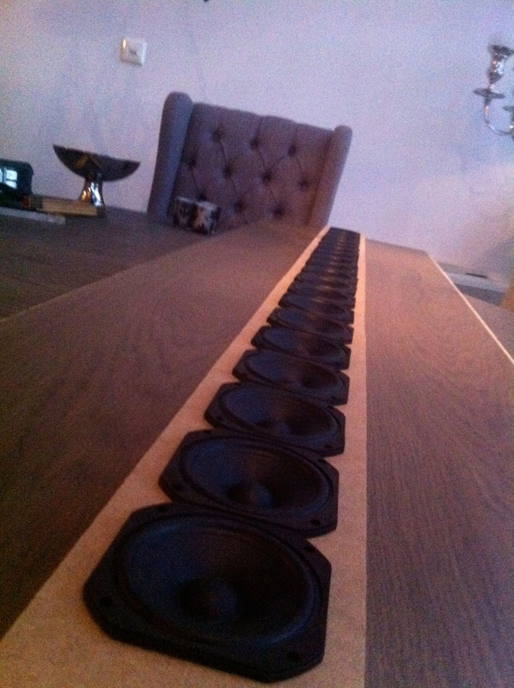

7 - This is what 20 of those look like :)
8 - Holes about to be filled - Will my spacing allow the drivers to fit?
9 - All 20 fit, sigh of relief from my end. I could have chosen 84mm spacing and still gotten away with it, each driver now have about 1mm separation.

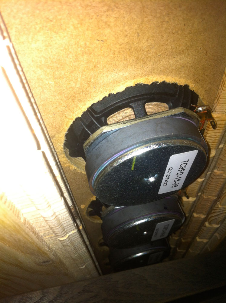

10 - Underside, holes are 76mm and the drivers fit nicely, the underside of the baffle will be chamfered allowing the drivers to breath better.

11 - Front baffle, internal baffle and cabinet sides still unglued.
12- Front baffle have had drivers aligned and mounting holes drilled

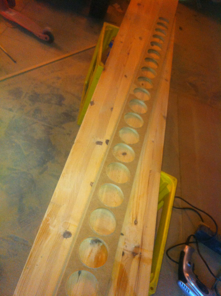

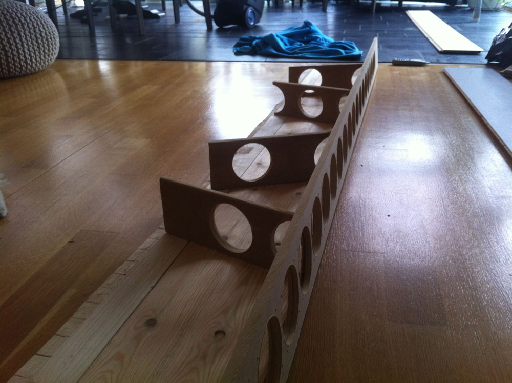

13 - Two pre glued floor tiles are being prepared for rough cut and grooves

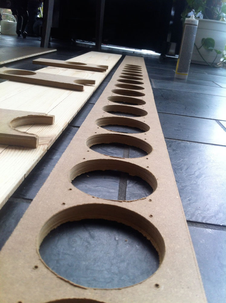

14 - Parts lined up, the internal bracing will be glued unparallell to each other. this will reduce chance for standing waves and also provide stiffness to the structure. Mounting flange shown
15 - Front baffle on flange with bracing in place, dry fit

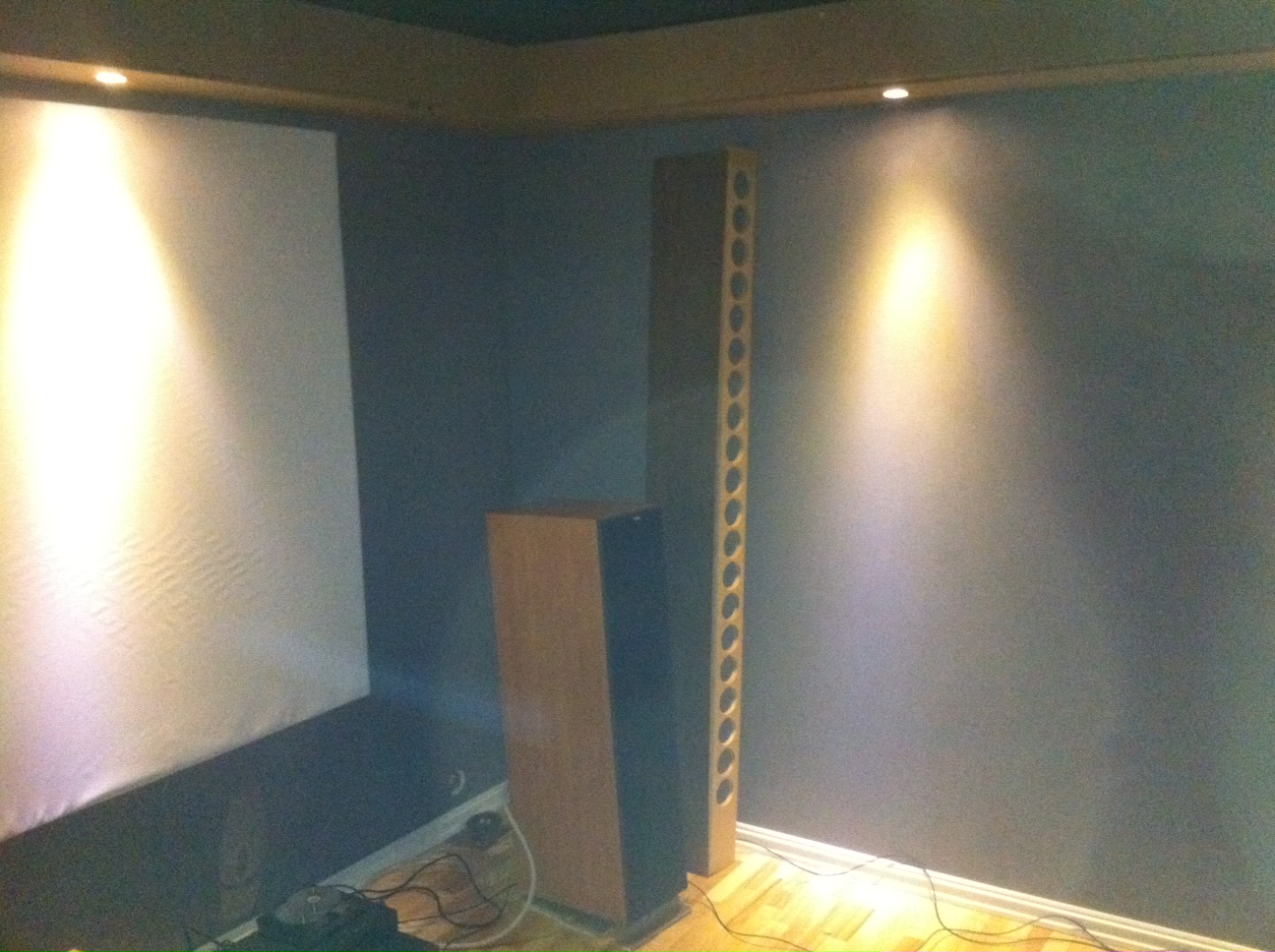

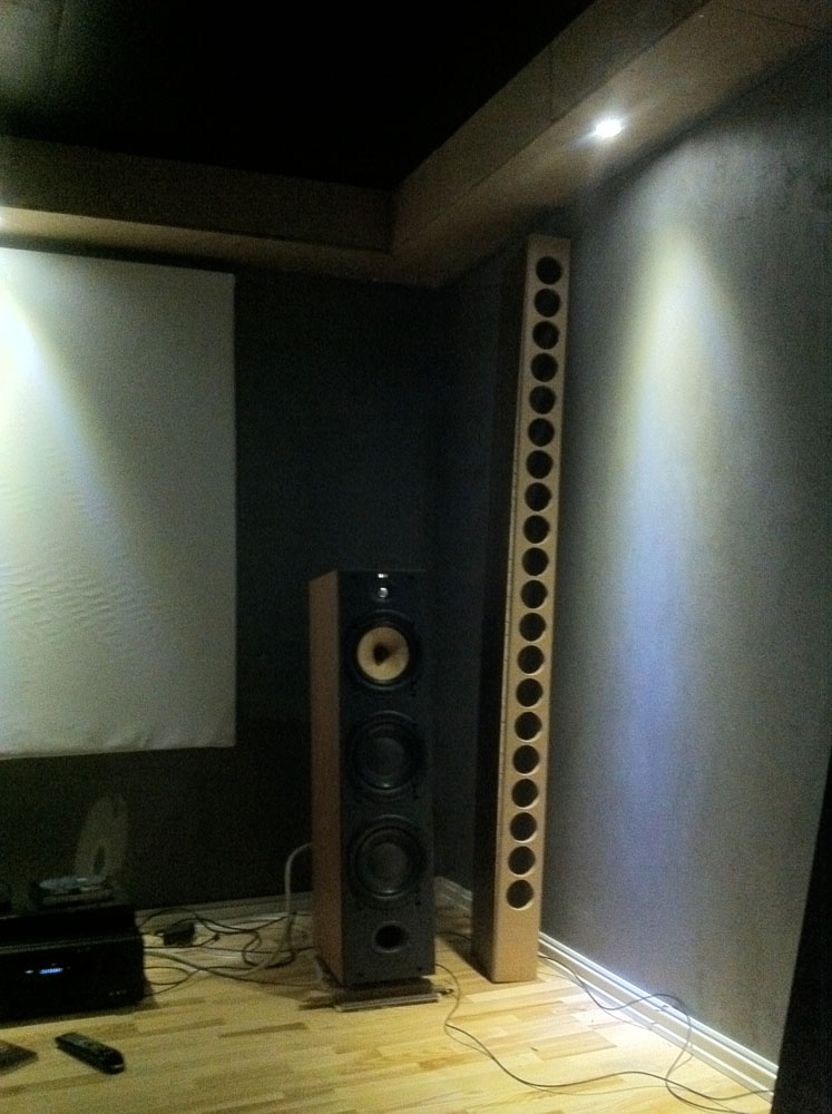

16 - Size comparison... :D Yes, they do go in under the soffits :)

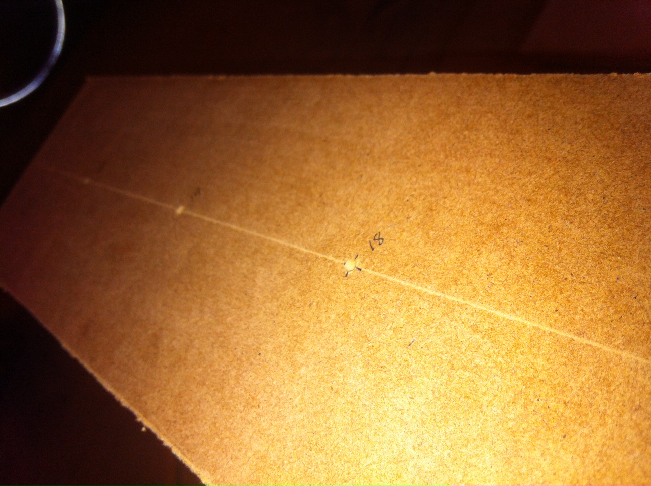

One of my concerns regarding a long line of identical drivers was to have them line up perfectly. In a long line the odd one will always stick out! Since I do not have a 2000x500mm CNC.machine in my garage I had to resort to low tech solutions... :p
After the front baffle was cut to correct width I scribed a thin line down the middle, used an aluminum straightedge and then a smaller aluminum ruler to pinpoint the 85mm center-center spacing. These were then predrilled with a 1,5mm drill bit (~1/16")
Once that was done the 76mm (3") holes were done. This worked out pretty well :D
The subsequent loose fit of all 20 units showed excellent uniformity and with the long straightedge tapped gently on the side of the drivers they lined up perfectly. At that point the mounting holes were marked and drilled once the drivers were removed.
Last picture again show size comparison vs the B&W DM604 (height =1m)
The Column isnt gluet yet, just resting up against the wall.
