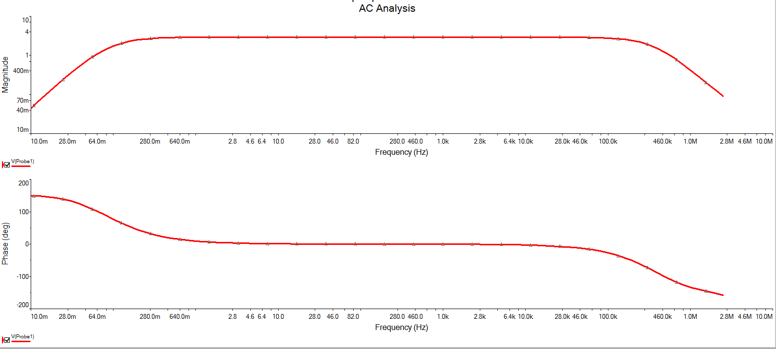

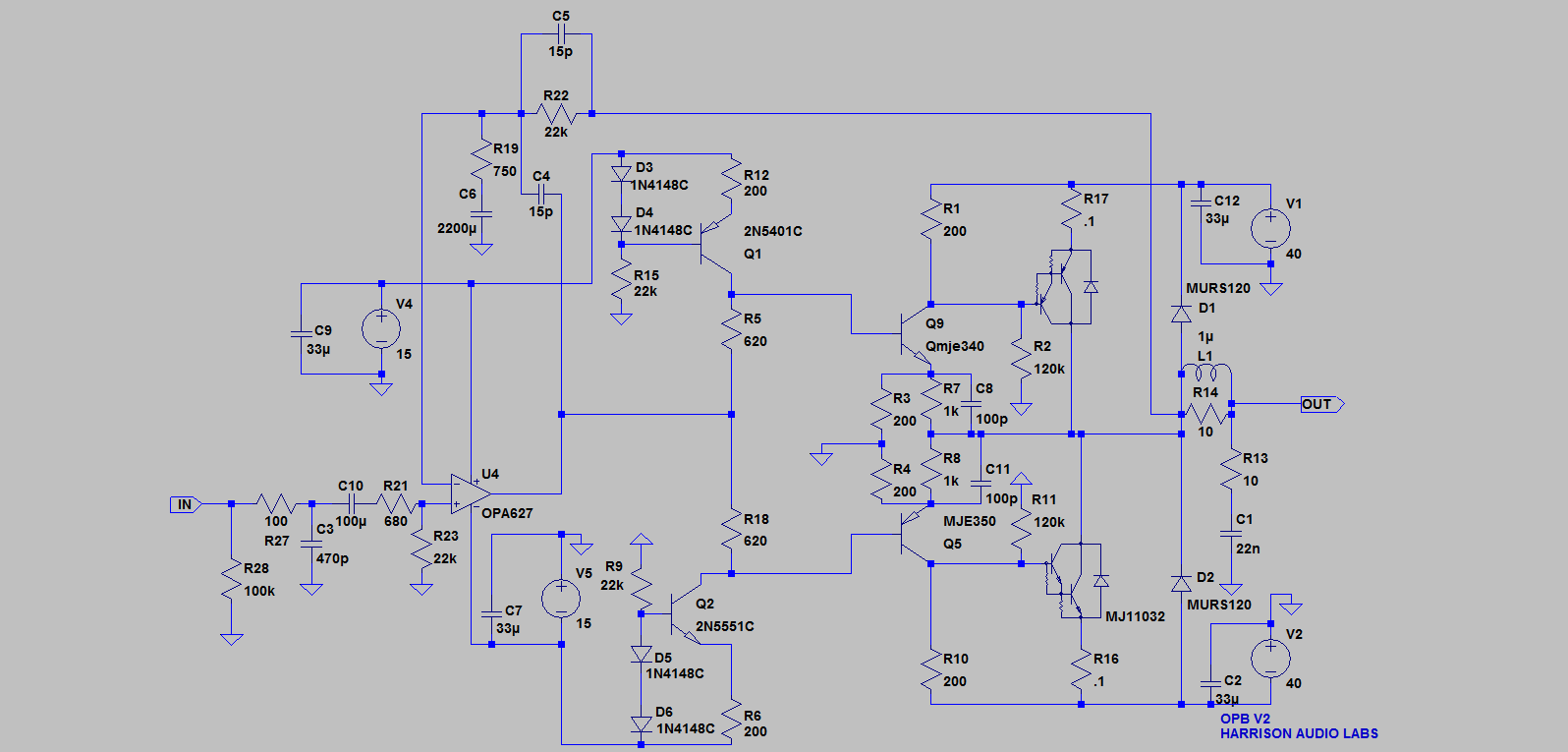

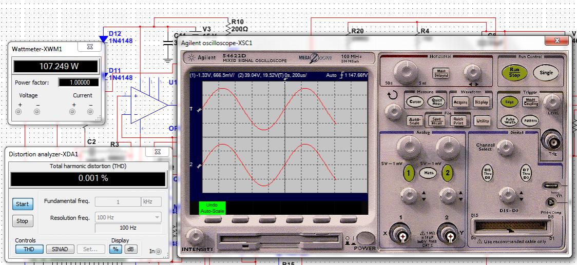

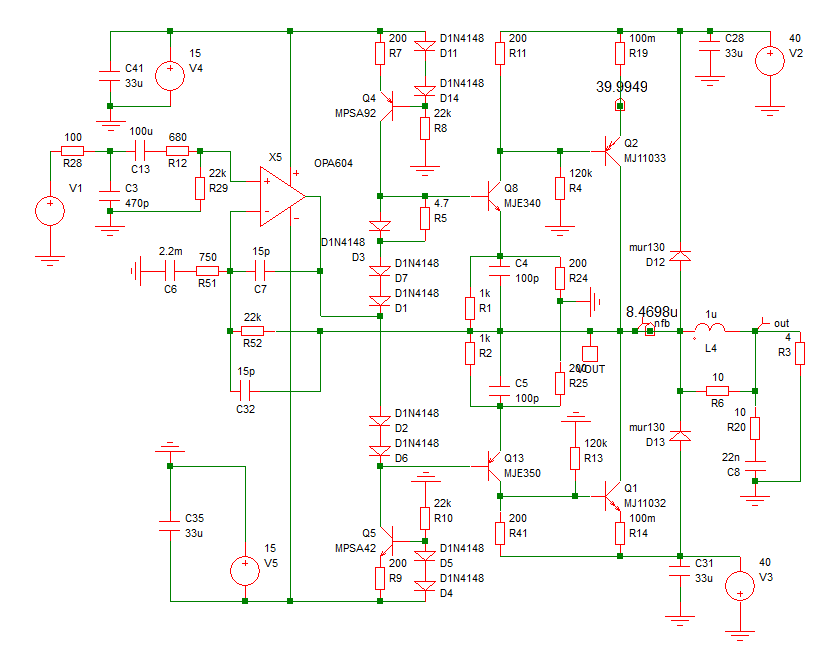

HAL OPB amplifier
Heres one of the toys in the lab ;)
30k builders needed
This is another product of the formula ;) . Data is required. Once you build the amplifier, simply post your findings in this thread. The formula indicates you will like it. Did you ? If you are looking for adventure and love to work with amps you are encouraged to join this thread, contribute by building the amplifier and posting your pictures and comments. Contribute to the state of the art :nod::nod::nod:
