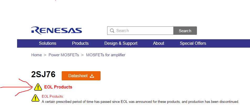

Is there a reliable source for new or even used output devices for people
who don't want to redo a Hafler?
I've heard that the more recent sources have stopped production.
that's a good question.
Magnatec says theirs are still available: TT electronics Semelab Limited - Magnatec Datasheets
Exicon says theirs are still avilable: Lateral MOSFET | Profusion Audio Design and Exicon Lateral MOSFETS
I've heard nothing back (yet) from Renesas, the grandadddy of all, whose website claims they are still "In Mass Production", but who knows if that's real https://www.renesas.com/en-us/products/power-mosfets/mosfets-for-amplifier.html
mlloyd1

Thanks mlloyd1, this is what it says at their site:
For the relevant types 2SK1056/1057/1058 and 2SJ160/161/162 (TO3p replacements for the Hitachis used in Hafler DH-120/200/220) their site still states mass production. Also Profusion/Exicon offer the laterals in different cases (TO-3, TO247, TO-264) as single or double die version, even as selected parts.
So all possibilites are open for a direct replacement of the PC-6/PC-19 pcbs in the Hafler or a complete new design of pcb. For me the free wiring of the FETs in the DHs was a little suspicious, a bettter way will be to integrate the output stage on a pcb.

Please keep me posted as to availability, since I want to update that kind of information in my second edition.
Bob
renesas are showing all six of 2sk1056/7/8 & 2sj160/1/2 as being in mass production.
https://www.renesas.com/en-us/products/power-mosfets/mosfets-for-amplifier/device/2SJ161.html
