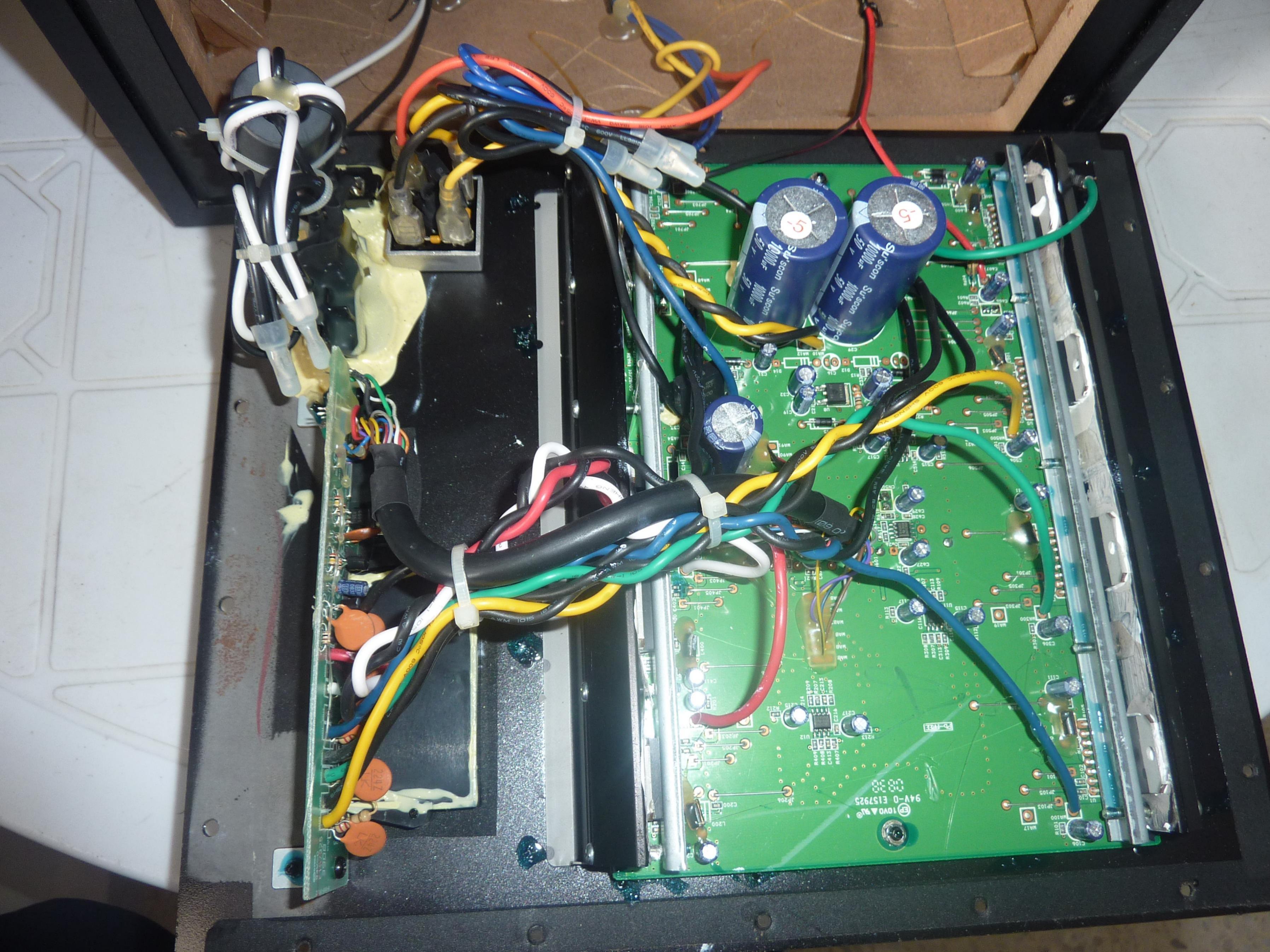

I recently bought a spring Type Z5500 subwoofer only with all the electronics inside. Problem is, the toroidal transformer cables were cut and there are no clear pictures to show proper wiring, nor there are any schematics.
This is what I've managed to figure out, though I could be totally wrong!
Toroidal transformer has 7 wires, black/white are 120v ac.
Yellow/black/Orange - yellow and orange go to the bridge rectifier, right? with the black wire being ground? Does this make sense?
Blue/blue - I have no idea where these go, there is a small bridge rectifier on the main board, where a blue wire goes... there is also a black wire, but... I have no idea where the other blue wire goes?
Any help would be much appreciated, as I want to resurrect this beauty!

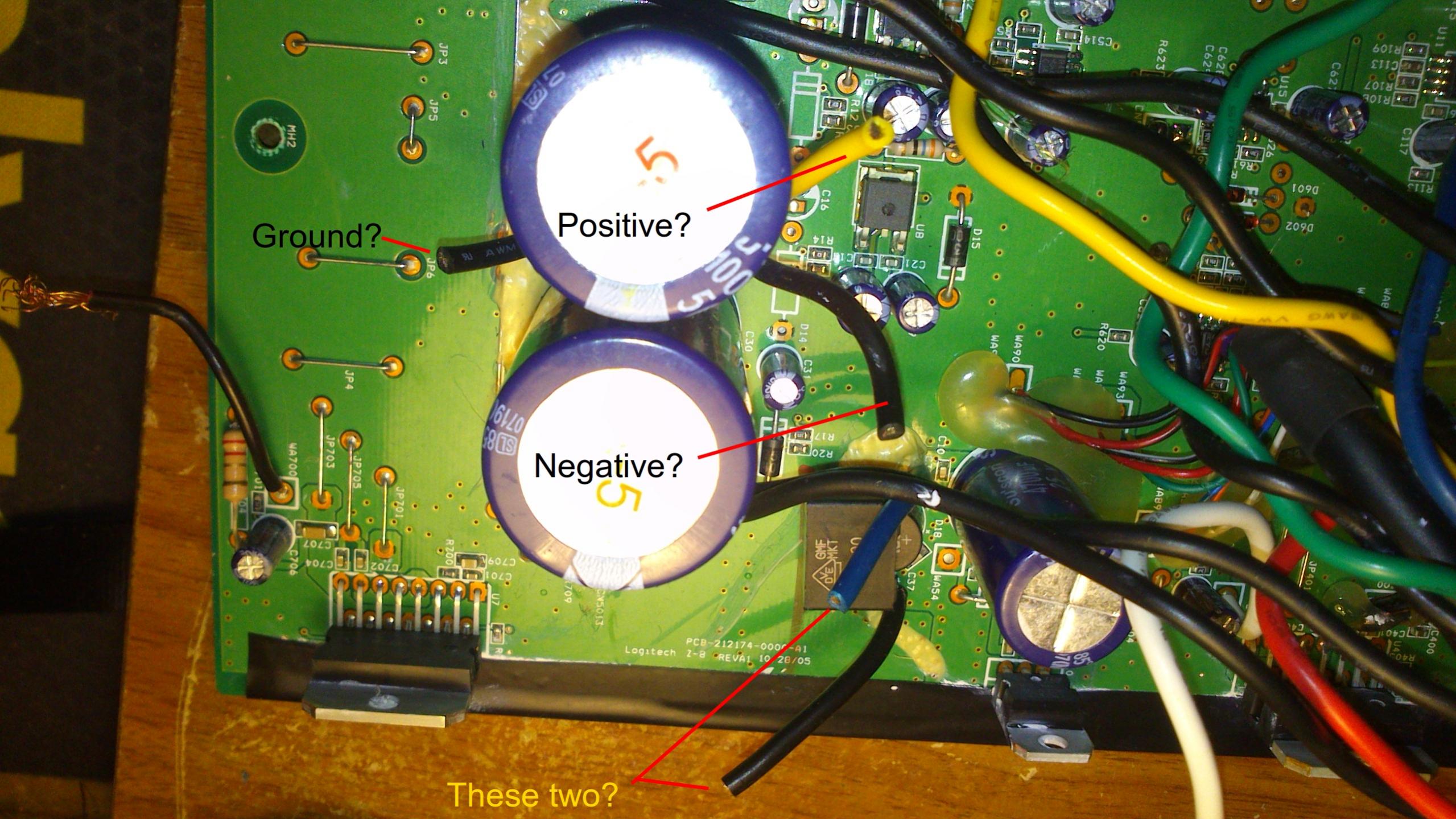

I think I found something about the wiring
Okay, I think I found a picture I can work with, picture is not mine, so I'm borrowing it from rjaii.
As far as I can see, the two blue wires coming from the toroidal transformer are connected to the two blue and black wires from the board (small bridge rectifier) via a couple of bell cap connectors, is this right?
The only question I might have is... the black wire is ground? I probably need to look at some power supply schematics to get the info on that one...
Any comments? :)

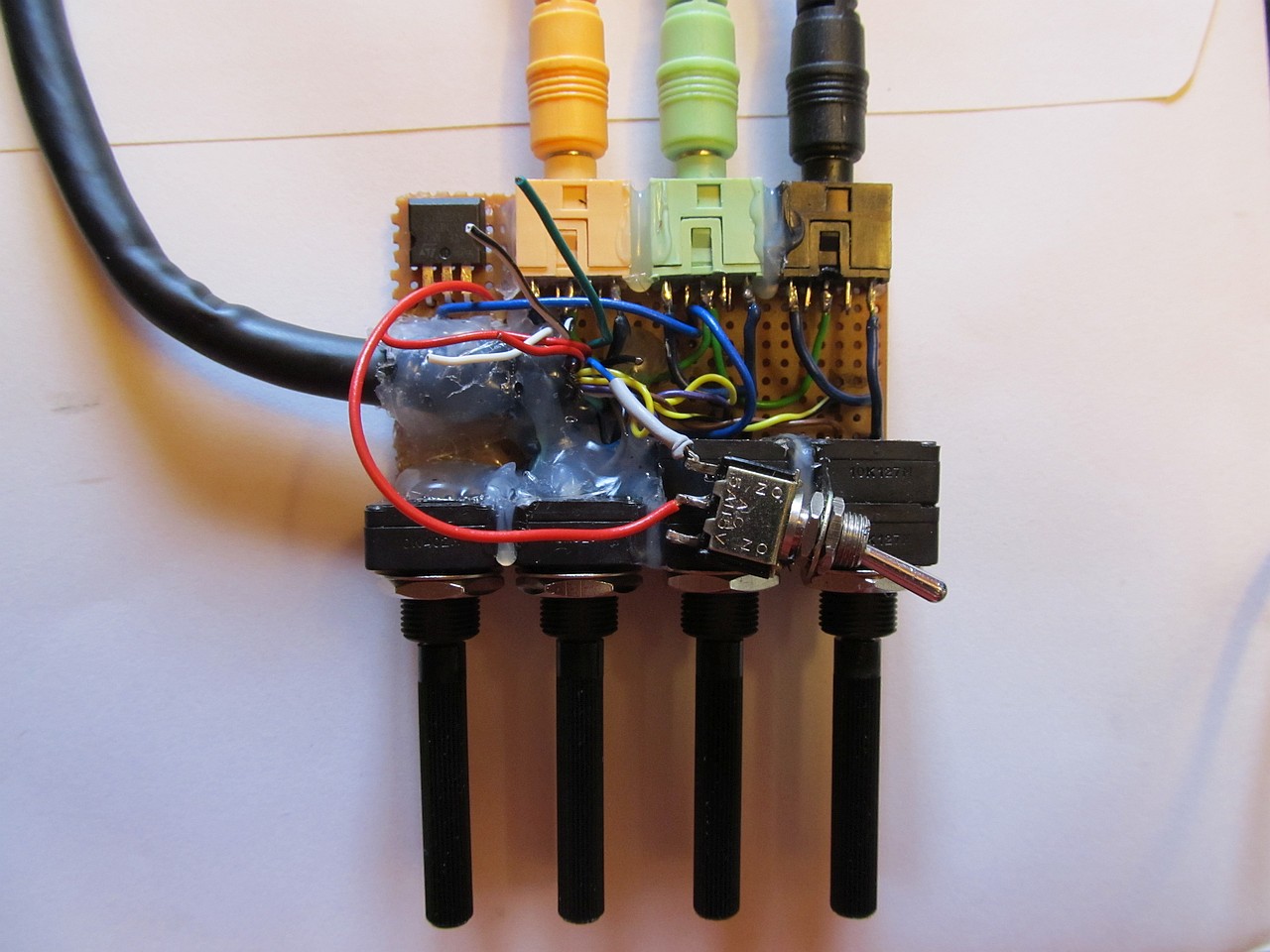

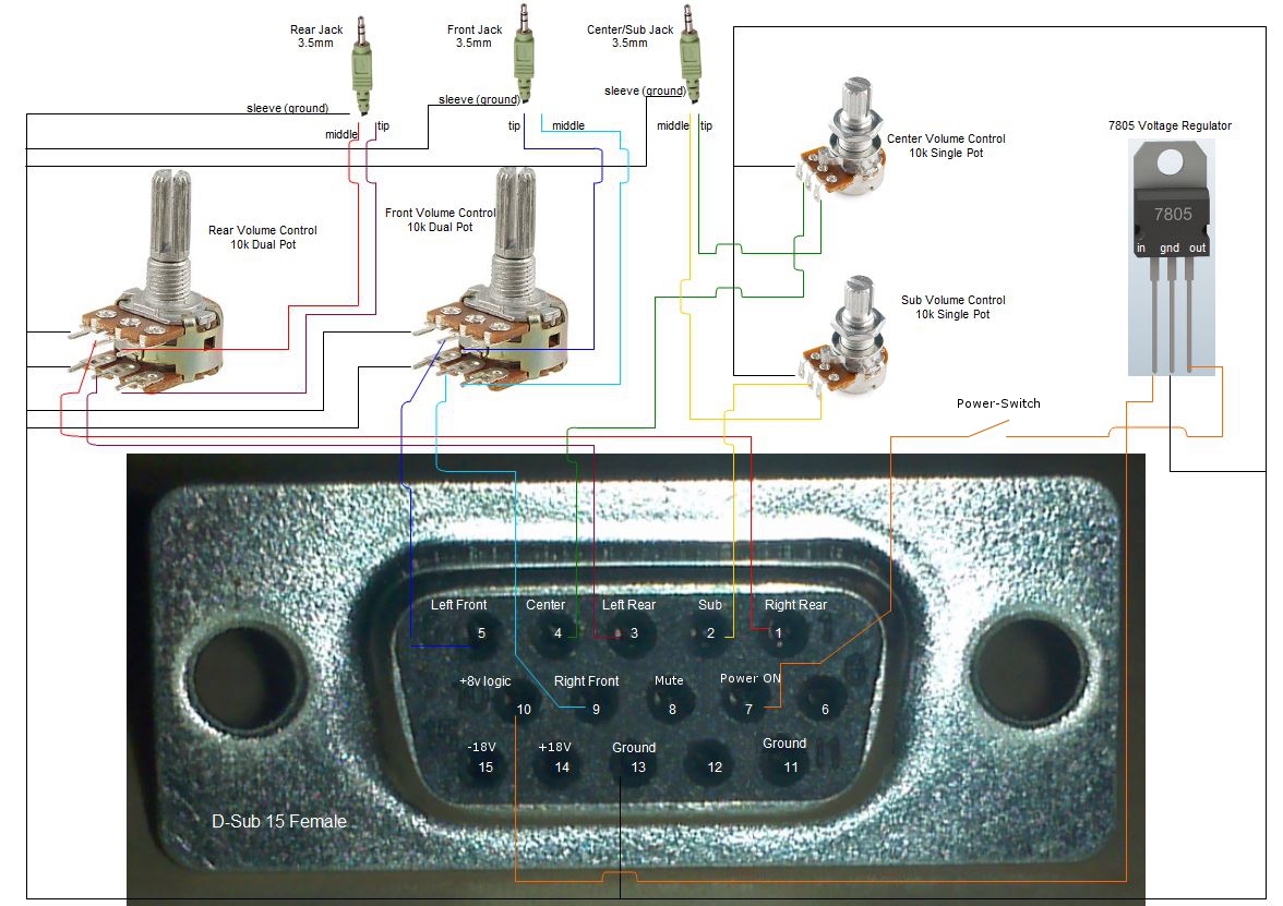

Thank you EVERYBODY for you contributions to this thread since 2007. Truly inspirational!
I too have a pre-636, spring-clip version Z5500 with dead control pod. My goal was to create a bypass cable going from my computer sound card straight to the sub, with no internal sub mod, and still having 5.1 surround, yes all six speakers working, including center and sub working perfectly, and independently, just like they should.
The posts that helped me the most were knexkid, Toffmonster, fluxarc , Sstevensn72 , and the final big puzzle piece, foodbag, the key being the 7805 voltage regulator, and not directly grounding pin 8. Thank you all for your help!
My bypass works perfectly, all six speakers. Front Left, Front Right, Rear Left, Rear Right, Center, and Sub all working, tested independantly using Realtek test screen where you can select each speaker and hear it play. I also added pots to control volume, just as everyone else recommended. I recommend too, as it is very loud. Here is youtube video of my bypass in action.
The only thing that I noticed was my D-Sub female connector numbering is backwards from what this forum suggests. I've attached my schematics for both no-pot, and with-pots. You can see my D-Sub connector with embossed numbers. They are definitely backwards, but this works great!
I hope this post helps someone like all of the others did for me. Good Luck!

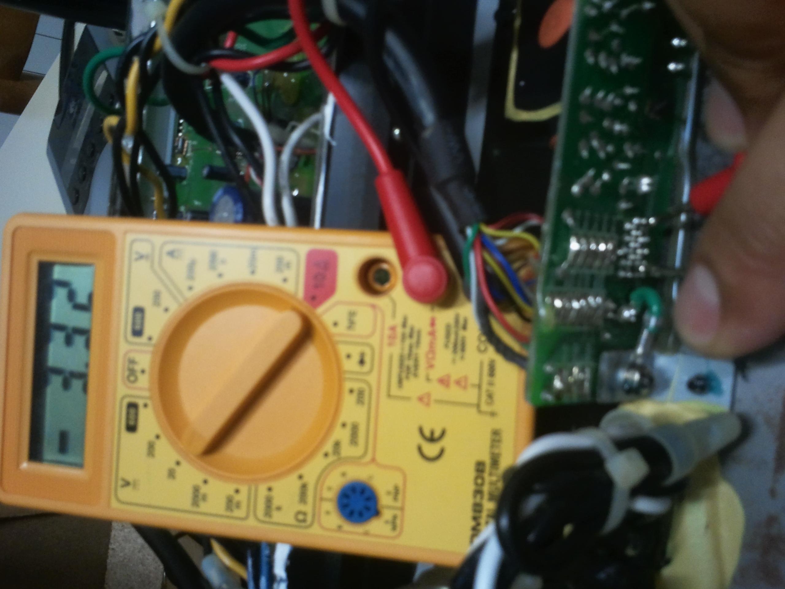

POD K.O. & pin 10 doesn't suply 8v

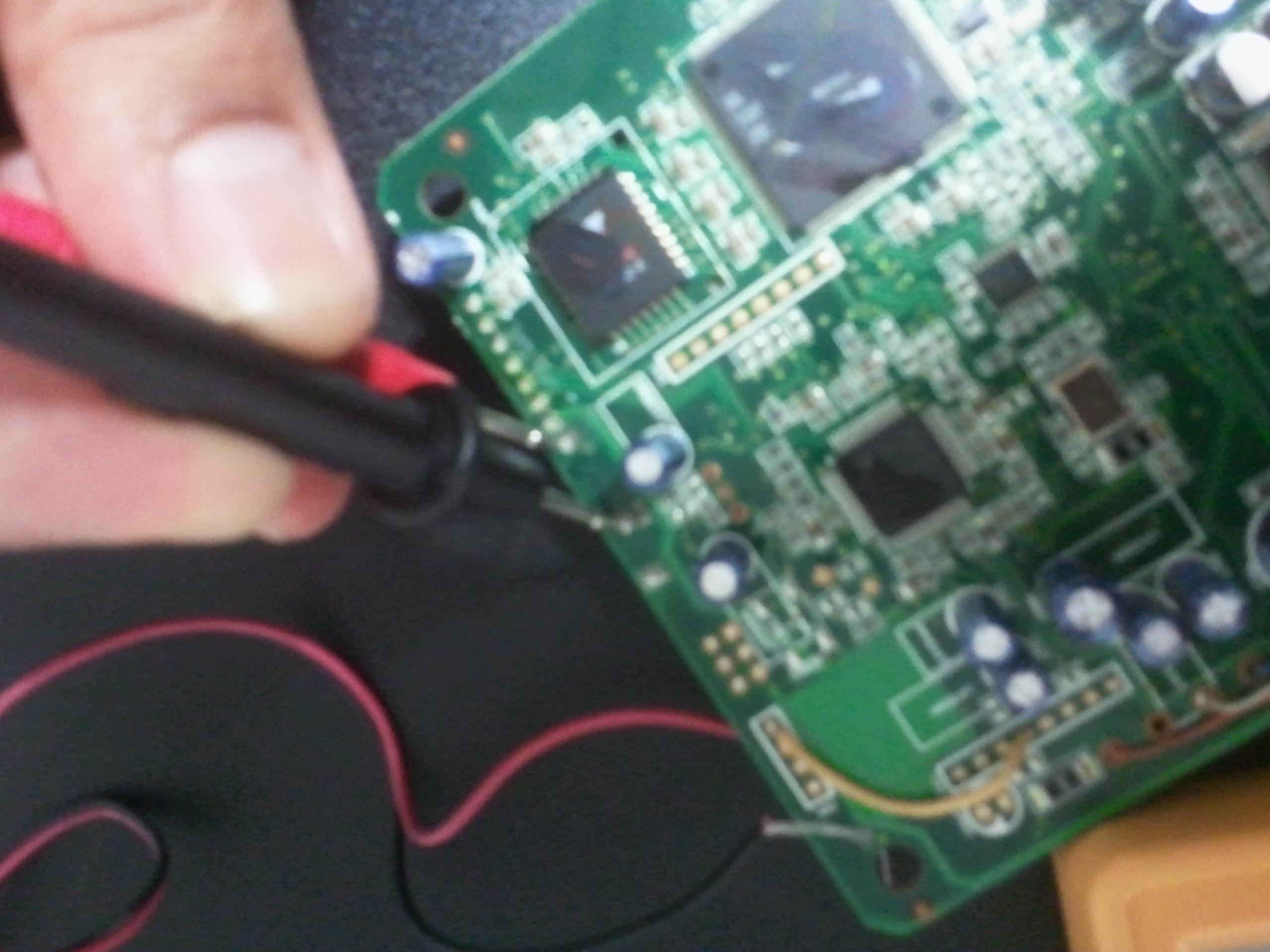

Hi, two days ago my loved z 5500 said good-bye :sad:. it happened restarting when i turned on the system. well, It seemed was a temperature problem, so i install a fan, like it can see in some webs. For that, i soldered fan as we can see in the image (ok, is not image there, xD but as can see in the 4 image, there i soldered the fan). the voltage at this moment was 7,8 aprox. Well, 0ne day gone on that invention. Now, the POD is dead, and the voltage fan is 0. I has wanted to test the voltage in the sub and pin 10 don't suply 8 v, now 3.4 aprox.
i don't know what happend, but i want to know if it's possible to do the bypass even though the voltage in pin 10 is weird.
i hope so, i like so much my z5500 :)
thanks for all! (and sorry for my english xDD)

Edit. yeah! i spend some time probing the system (only sub and central) and at this moment, sub works properly xD, besides, i has been reading this post and i have to say: thanks a lot for your works and feedbacks, really now is easy to make the work.
my system's a R714, i think i don't need to use +-5v for ground, so my problem with low v in pin 10 has desapeared... maybe. in some days i'll recive new wires and other stuff, i think i buy too some pots and make a POD mod with the old case.

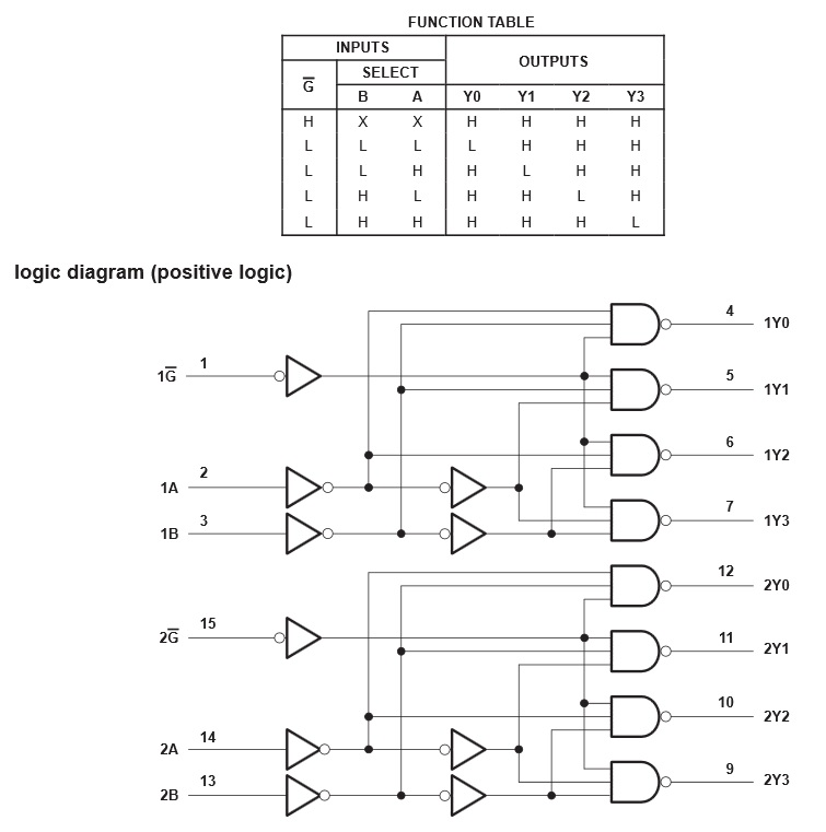

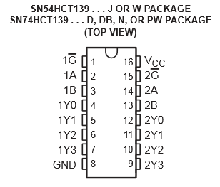

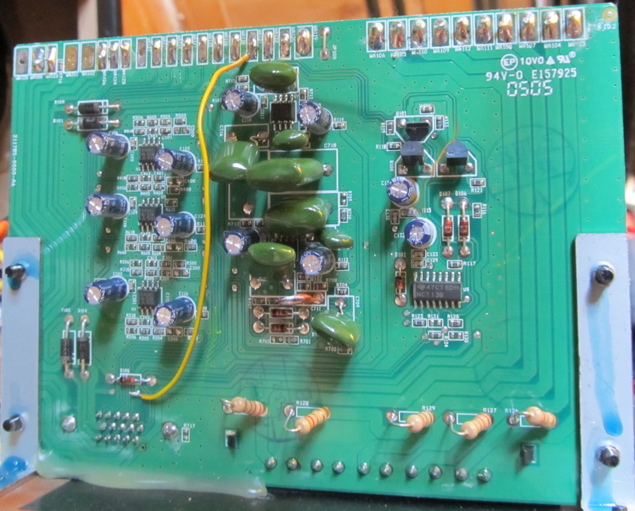

After investing another 3 hours and studying the logic of the HTC139, I was able to fix some of my previous problems. Opposed to previous solutions for my PID 512 I had to hook up pin 7 to +5V and not connect pin 8 at all. This way, amplification is normal and no distortion occurs on the front channels. The only thing I didn't manage to get working without a workaround was the center channel. So I still had to connect +8V to center enable on the subwoofer board. I also added a switch between +5V and pin 7. I'll also add a LED before and after the switch to display main power and "power on".
Pin 7 and pin 8 are connected to 1A and 1B of the HTC139. 1G is always low. Y1 and Y3 are controlling "power on" and "center on". So with the right combination of signals on pin 7 and pin 8 you're able to switch on the amp. Feel free to hook up +5 or GND to those pins to experiment. Due to the HTC139 you won't do no harm.
The pin-out of my amp is:
1: Rear Right (brown)
2: Subwoofer (grey)
3: Left Right (yellow-black)
4: Center (blue-black)
5: Left Front (yellow)
6: not connected
7: Power ON (blue)
8: Mute (white)
9: Right Front (violett)
10: +8V (red)
11: ground (green)
12: ? (white-black)
13: ground (green)
14: +18V (red-black)
15: -18V (black)

Neuweiler,
I'm planning on building this pod bypass and I like the changes you've made. They look like they make sense for my system with PID R533. Question, when you say
did you fix this with the yellow jumper you show in one of your images? Also, I seem to remember some posters mentioning grounding or ungrounding pin 6 to mute the system. Have you looked into that?
One more thing, will you be posting your LED additions here too (please)?
Thanks,
Rick
P.S. Glad someone is still keeping this thread alive :)
Question, when you say did you fix this with the yellow jumper you show in one of your images?
Yes, the yellow cable in the picture on the left is used to enable the center speaker.
I couldn't locate any wire in the original cable which connects to pin 6. But I think pin 8 is mute and if grounded or connected to 5V will mute the system.

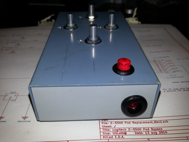

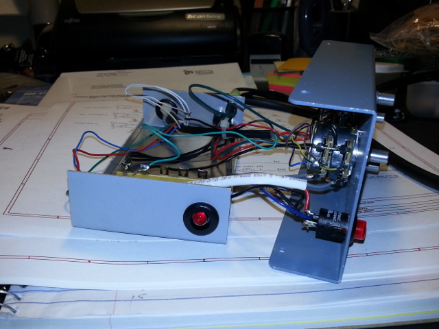

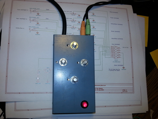

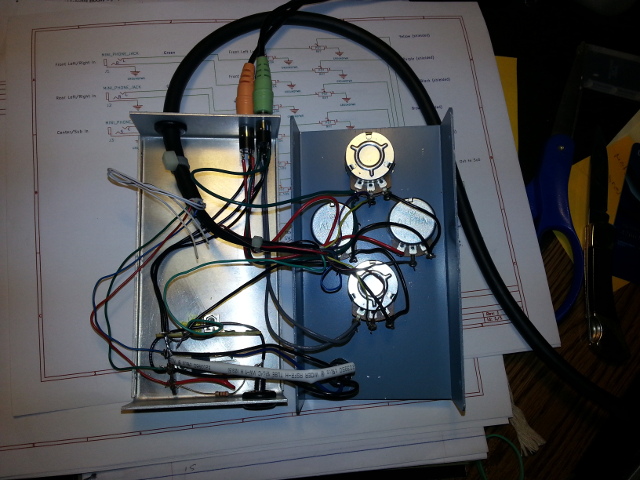

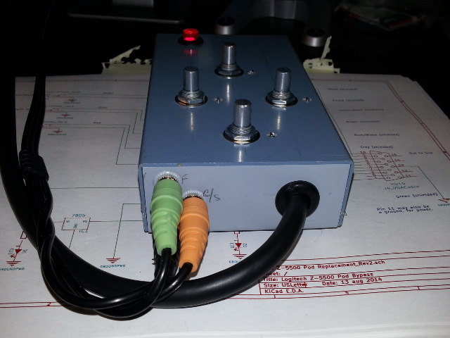

Project Completed. Almost. Still a couple of things I plan on adding. I think I can add a mute function by simply connecting pin 8 to 5v+ through a switch. This worked in testing by touching the pin 8 lead to the 5v+ on pin 7 (also on the 8v+ supply on pin 10). I would also like to add a master volume control, but my current project box isn't quite large enough to hold a 6 gang pot. Another thing I would like to add is a headphone jack that will mute the speakers when a headset is plugged in, but I haven't figured that one out. Yet.
  • Z-5500 Pod Replacement.pdf

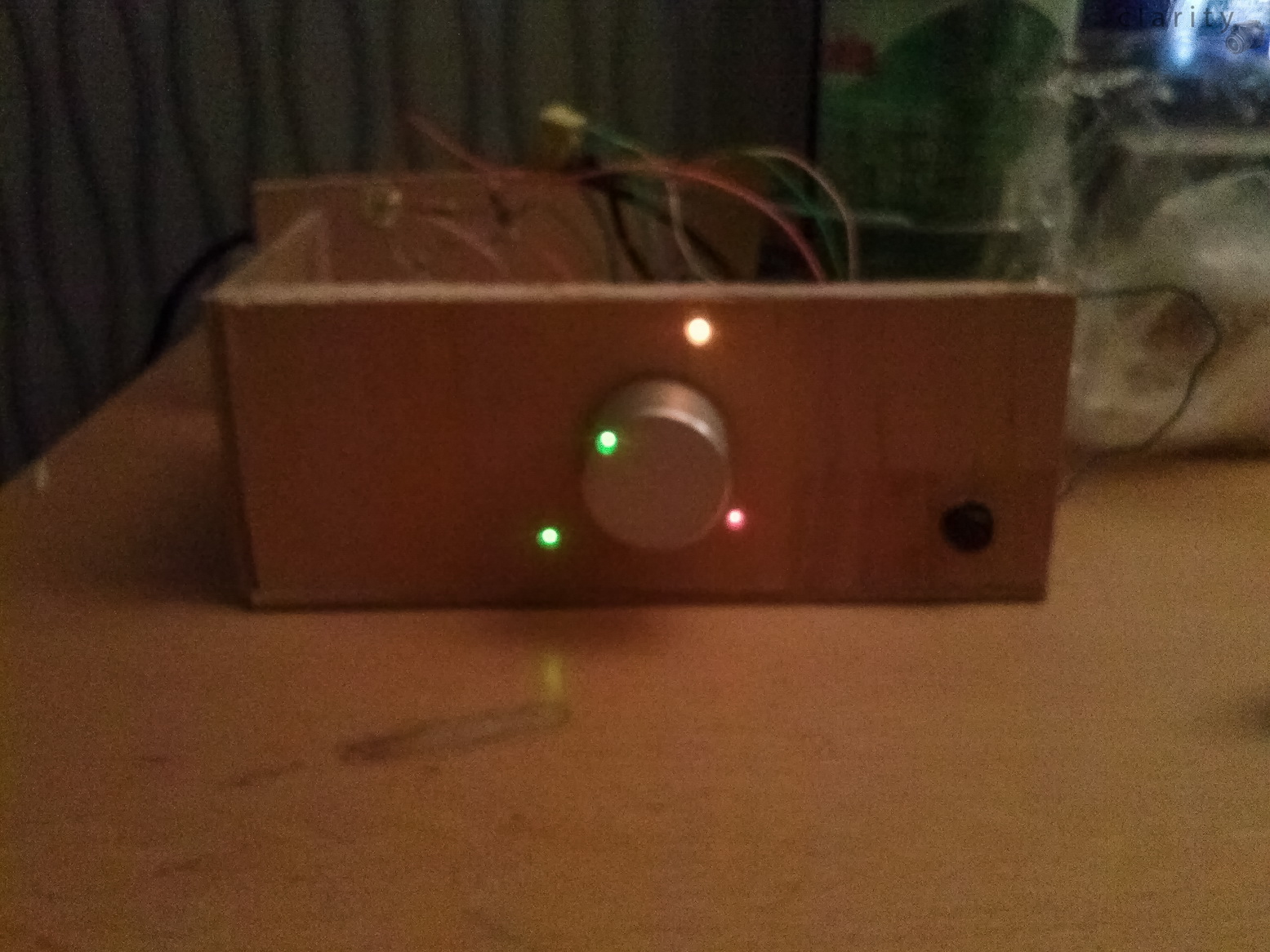

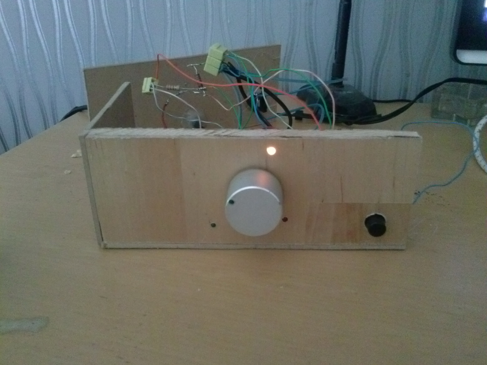

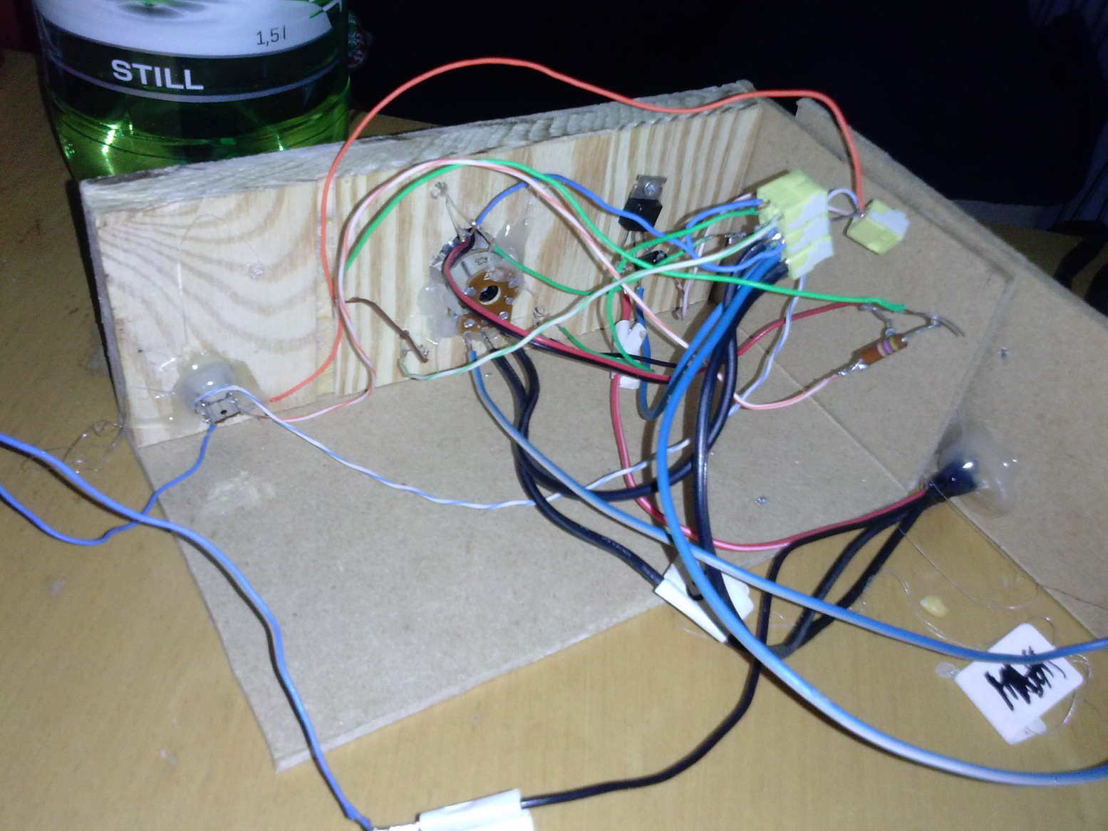

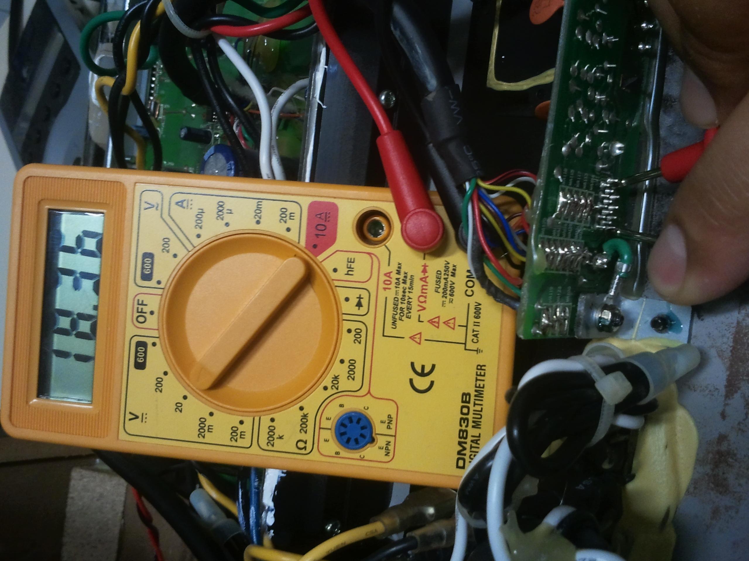

Hello all the people,
I wanted to share my experience with z5500 without control pod. I stumbled upon logitech z 5500 sub without satellites or control pod. i searched online and immediately stumbled upon this beautiful forum and thread. I found the picture for a bypass cable with pots and vga adapter, lm7805, but all you know this very well. So i made one, and it fired up the sub on my first attempt. It was working perfectly. So i wanted to build like a box for potentiometer and on/off button, led's, so i did. As you can see in pictures...i have to close it but it is finished. Now all is working....but i noticed that when i turn on the sub there is this popping noise you know like POP, the speaker is not protected there are no relays like in ordinary power amps and so on...so this was like a DC pulse, in happens, but it was annoying. Maybe its not good for the speaker maybe it is, i don't know but it was annoying. So i wanted to solve it. Now,
pin 7 and pin 8 are very important for this. pin 7 is Amp on so it turns the amp on and pin 8 is mute. From the diagram mentioned when you get 8v to lm7805 and pin 6 pin 7 and pin 13 are connected to ground as in diagram, lm7805 fires up the amp and the mute is off at the same time so a pulse goes through the speaker and there it is a POP. First i tried connecting capacitors across lm7805 to suck up the spikes but that didn't work. The basic idea is that when pin 7 gets the ground, so to speak, the mute should be active all ready so no pops or whatever on speaker. I noticed that when i connect a resistor and a LED to ground directly from lm7805, pin 7 somehow through this resistor gets grounded and amp is on and +5v to pin 8 makes mute on so no POPs on on or off. Its hard to explain but i will post a diagram. Basically all you need is a resistor from lm7805 directly to ground and amp is on and mute is on and no pops. so then through a switch you can turn off +5v to pin 8 mute is off and speaker is on completely silent. i will post a diagram shortly. But the main idea is to turn on the amp before mute is off. And that happened when i put a resistor directly from +5v on lm7805 directly to ground .
cheers!

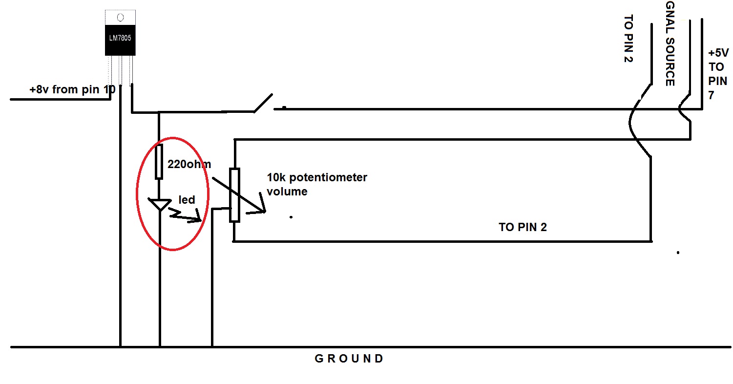

Me again,
here is the diagram...i left out all the other led's but they are simple to connect. That thing circled in red grounded pin 7 and amp turns on , but at the same time mute is on through pin 8. You can af course lose that LED which is in red circle and leave only the resistor. I can now "this thing in red" connect through a switch so there are 2 switches, one amp on, the other the black one is all ready mute on/off. I don't know why this happened, but now are amp on and mute separated, and there are no POPs on on/off. I think its something in amplifier control board that through a resistor pin7 gets grounded, on other picture mute is on but notice the led...amp is on..:))...hopes this helps someone..please feel free to ask questions if there are any...
all the best
in diagram in right corner there is written +5v to pin 7 ,,,thats actually +5v to pin 8, sorry for that...on vga sub connector pin 6 pin 7 and pin 13 are all connected together
