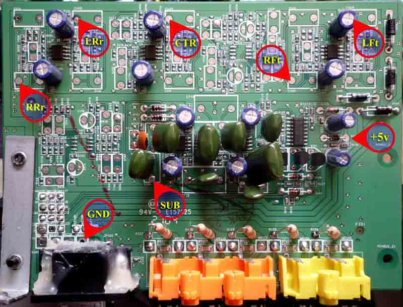

Hello!
Just as the poster above me, wanted to thank everyone in this thread for sharing all this information, thanks to you my Z5500 are now back from the dead and work perfectly.
Here's the info about my system:
PID: R512
Type: Spring-clip
First thing I did was bying a bypass cable off Ebay (because I'm lazy like that). The seller confirmed the cable follows this schematics (grounding version).
Unfortunately, just as I feared, the cable didn't work on my pre-636 system, the amps were still off.
So I decided to give the +5V version a try.
My wiring seems to be the same as the one xavijs has.
This (white) wire indeed turned the amps on. I fed +5V to it from the place undertone marked in this post of his.
With the amps turned on but without the cable (still the same one from Ebay) attached to the sub the speakers produced this "buuuu" sound xavijs was talking about. But with the cable connected everything was normal.
So I thought that was it and my speakers were all working, but when I started testing them I noticed that my center speaker didn't work. Same problem as Bastien had.
I had to experiment a little and found out that feeding +5V to the orange cable turns my center speaker on. There's one condition though: orange and white wires must not be connected with each other otherwise the amps turn off. So I had to connect to the other side of that control logic's +5V which was pretty hard to do due to its miniature size. If you can't connect there without accidentally burning the smaller components I believe you can alternatively feed +8V to the orange wire that also turns the center on.
So in the end I use the cable with the grounding schematics, while separately feeding +5V to white and orange cables.
Everything works as it should.
Hope this helps.

Hello Toff,
Thanks for your help!
So, you're getting the +5v for the amp from the place marked in this photo?
I think it's too small for me to solder anything in that place.. Is there any other alternative? Maybe getting the +5v externally...
soflip
Yes, I managed to solder two wires there from both sides. It's important because when I tried feeding +5V from the same place (thus connecting orange wire with white) the amps turned off.
Alternatively you can get +8V from pin 10. +8V also turns the amps on, as someone said they expect anything above 3.5V, but I'm not sure how safe giving them higher voltage would be in the long-term perspective.
Of course, my PCB revision looks quite different from undertone's, mine is similar to the one xavijs has. I marked everything in this picture (did it by memory, hope I didn't mess up):

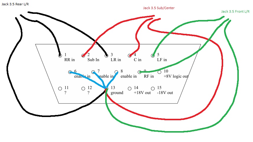

d-sub 15 pin to stereo jack
Hi everyone,
i am trying to get my z5500 to work with a d-sub 15 pin to stereo jack.
My z5500 controller panel died. I tested the z5500 with another control panel.
With the other control panel (of a friend) it works fine.
I found this Thread and with the pic of knexkid i tryed to find
a way to get it working with a stereo jack.
I have no receiver and as i read here somewhere i dont need one...
I took a d-sub 15 pin, 3 row connector and try this:
PIN 6, 7 and 8 are connected to 13 and there is a wire to ground of the stereo jack.
PIN 2, 3 and 5 are my Left Channel and
PIN 1, 4 and 9 are my Right Channel.
Ok i connected it with a Laptop and a media Player and it does nothing at all.
Would be cool if anyone could give hints.
Sorry for my bad english.
Greetings
Oli

I have just tried it and it works just fine! (ofc i used pin 2 and not 3 )

Ok i tryed it and its not working... So it seems to be more than giving 5V between
Pin 6 and Pin 13... I dont hear anything. I dont see what i am doing wrong.

Yes, that's spring-clip. Please, also check the PID number of your system, should be on a sticker at the bottom of your sub. It's important to know this because it seems like it's mostly (if not all) post-636 systems that turn on with the pins grounded, older systems use +5V for that.So I guess this is a "spring-clip" edition.
If you read some of my previous posts you'll see I fed +5V directly to the PCB inside the sub instead of the pins. To me it had to be white wire to turn the amps on (it probably leads to pin 8, though I'm not sure) and orange wire to turn the centre on (no idea what pin it is, didn't bother checking).Ok sounds good...do you know which pins? pin 6,7,8? or all of them?
Also note that I use a pre-made cable with pins 6-7-8-to-13-to-ground scheme with my setup.
Clueless about the amperage, but I believe both 4.5V and 6V would be okay. Feeding 8V from pin 10 also works. Someone here said it has to be more than 3.5V.Is 4,5V or 6v and 300mA ok? Or more/less?

According to this it's +3V to pins 7, 8 and... 2? People in this thread also discovered that either pin 7 or 8 should be Mute, and the other one should be Power.Under normal operation what is the feed voltage that switches the amps on and where does it come from?
