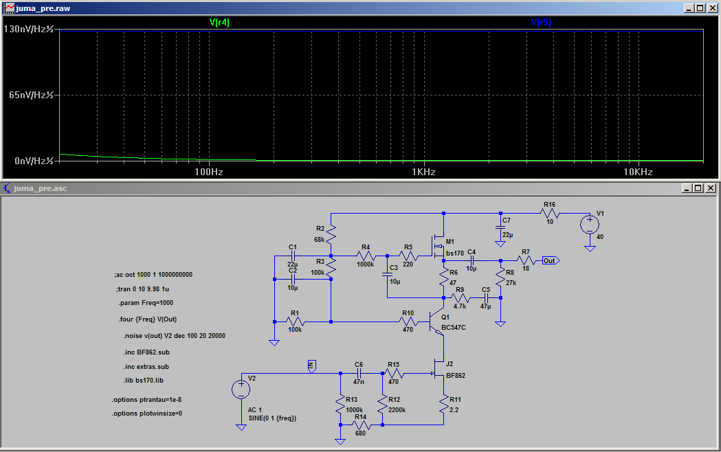

:up: good that the sim pointed you in the right direction (the sim itself indicated the gate stopper rather than the 1M which is interesting (and I found a bit odd due to the low value of the gatestopper). Shown below.
I guess if the 1M's were particularly noisy it would be being fed directly to the gate of the BS170. Great finding and may help someone else if they have noise problems as well! :)

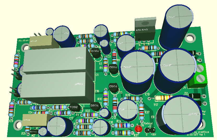

I ordered some prototype pcb's for layout in post #116. Attached is a 3D view, which shows both Silmic2 and large film caps for the output, but it can accommodate smaller 47nF MKC caps. There are not many "vacant lots" left on the 110 x 60mm pcb.;) The BF862's will be on adapter boards to fit the TO92 pinout. I also ordered a new preamp enclosure to put the first one in, so that I will have a good working preamp to use when I modify the existing preamp that I am using now. I plan to do several changes to my existing one, especially to the remote control section, which might take time. I will get the prototype verified in the first preamp in a reasonable time.

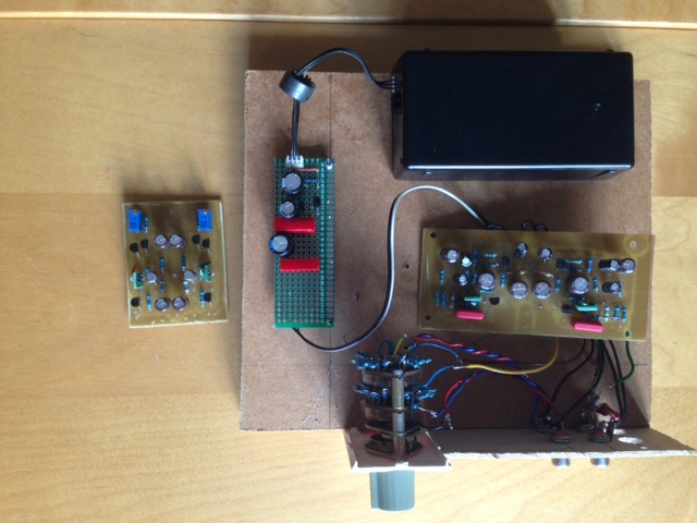

Hi Propitious,
It looks good.

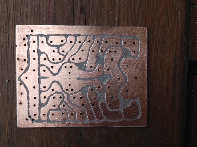

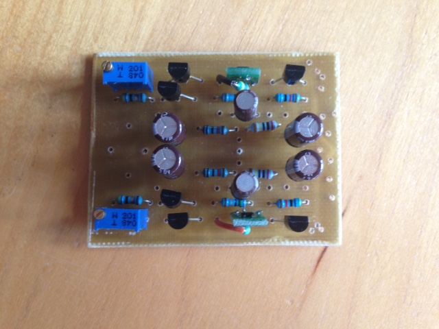

I attach a few pictures of my humble prototype/final version of the preamp from the current thread (noise free!!! that is the one on a piece of mdf; notice I seem to have the same volume control as Juma). Next to it the partially populated buffer with bf862 and cascode (suggested to me by Juma) and my humble made pcb for it (I have noticed that a Dremel tool is great for small PCBs; faster than etching!)

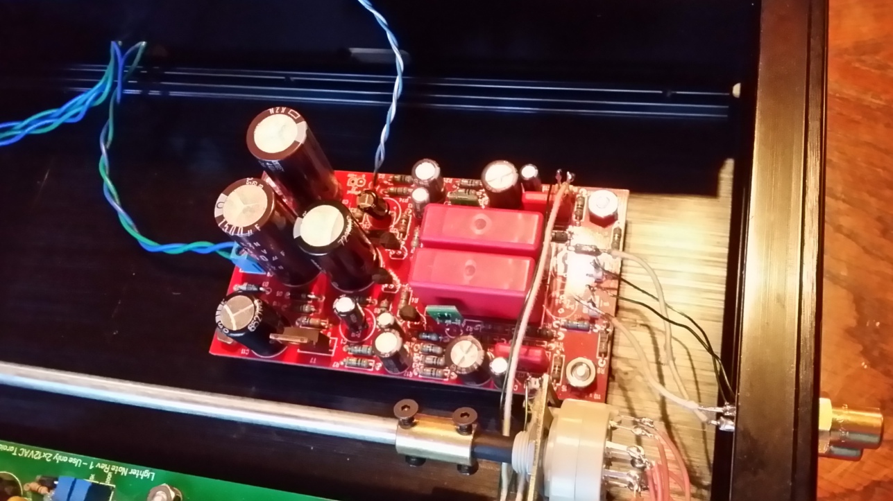

Joined 2012

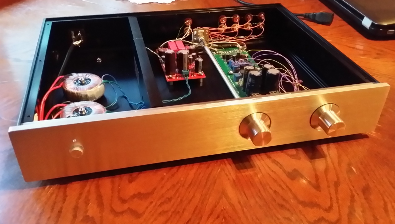

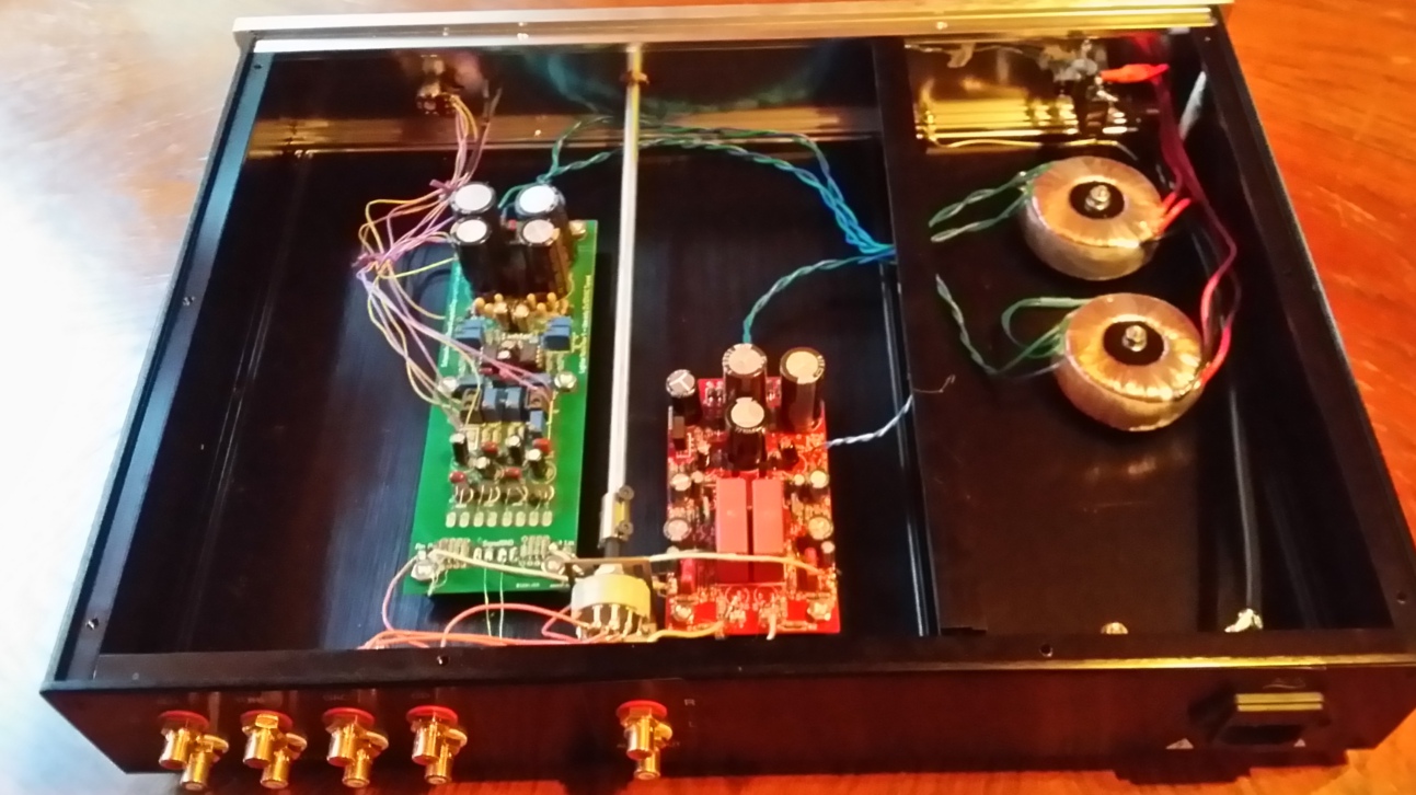

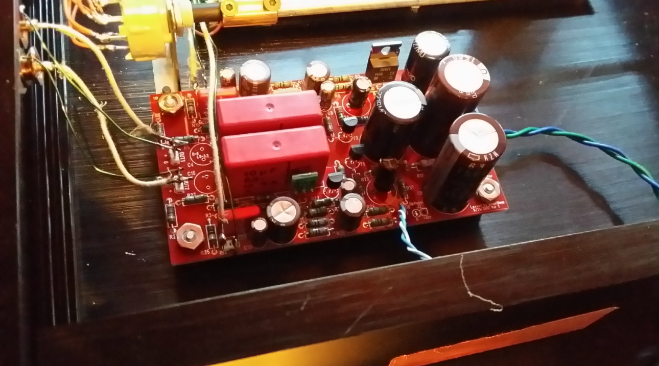

I wanted to make a 2nd preamp that was mobile for trying out new builds. It has my version 2 pcb layout from post 116 and I used a LDR, Lighter Note volume control from buildanamp.com (his site shows that he now has a later version). For this build I had a pair of Wima 10 uF MKC caps that screamed "Pick me!" (like when we were kids trying to get one of captians to choose me for a basketball game at the schoolyard court) so I used them. Not sure if it sounds better or worse than using 10 uF Silmic2 and small MKC. I burned it in a few days. With R17 set to 240R, the rail voltage is 38.5 VDC and my DMM set to AC shows about 0.3 mV AC ripple. Nothing gets warm. The Antek 10 VAC with 2 x 18 VAC sec. is plenty.
By itself the Lighter Note sounds very good and surprisingly enough gain going to Cubie3 amp on most media. When I also went through the Son ZV9 v2, it also sounded very good but there was a new white noise when I held my ear close to the woofer or tweeter (equal loudness in both and in both channels). I could not hear the noise a meter away from the speakers. My cheap scope did not reveal any clues. The volume of the noise does not change when I turn the volume control up or down. I lowered gain by lowering R11 (post 116) from 4.7K to 3K but no difference in noise. I know Greg found the cause of his white noise when he changed out the 1M R7 going to gatestopper of BS170. I was doubtful that was my cause because I used Takman MF which are very quiet resistors. At a loss, I changed those 1M to low noise Vishay, but there was no change in noise. At the moment, I am not sure what to try next. The slight white noise does not bother my setup, but I have 87 dB/W speakers. I am not sure it the white noise would be annoying on 97 dB/W speakers.

Looks cool Propitious!
Interesting that you are reporting noise as well. I am curious whether you can lower it even more. In my setup there is some residual noise close the the tweeter (not comparable with what it used to be with the dodgy 1M resistor), but I am not bothered by it anymore in my listening position.
Meanwhile, I have literally yesterday finished the prototype of the buffer suggested to me by juma. I do not think I should pollute this thread with that buffer. I will just report that it sounds very nice. It has some "effortlessness" about it. This is always a good sign.
I have some issues with the volume control (get hum at low settings) though. So now I listen at high settings (above 12o'clock, not a problem as there is no gain) and control the volume from the computer. I need to investigate that.
Propitious, try if C7=1u and R13=100k (re. sch. in post #116) bring a change. See what's the Vds on BF862 (few volts is to be expected). R7 can be lowered down to 100k with no consequences - try that too. JFETs can be from noisy series, gate on MOSFET can be leaky, etc...
