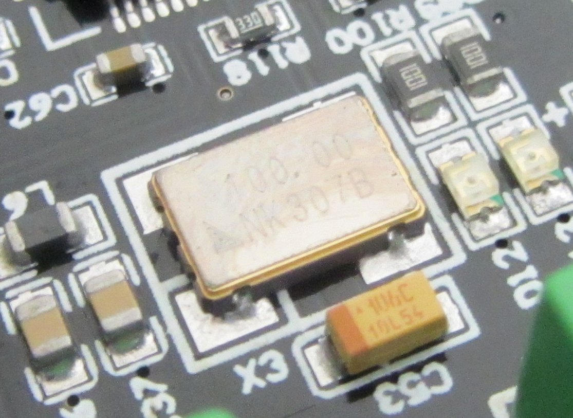

Hi, I bought one quite recently. It is very nicely built and sound great to my ears. Very detailed and transparent. I have not tried any DSD material yet. PCM up to 24/384 works well. Mine has a 100Mhz clock in it although the ebay pictures show 80Mhz. I modified it with a LL1674 OPT in 4:1 stepdown.
Hi, I bought one from doukmall on ebay.co.uk. Sold from UK, fast delivery, no customs etc.
Mine has 100 MHz clock too. Very nicely built.

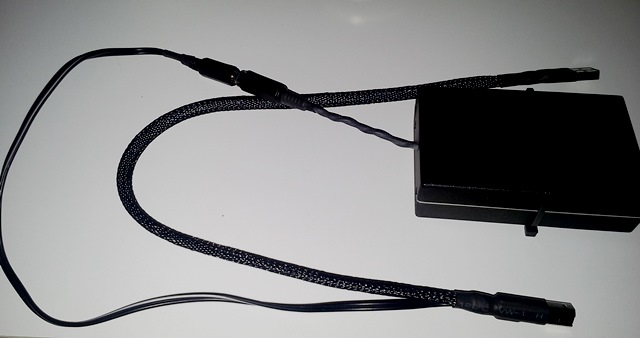

I am very satisfied with the sound... and i really don*t know if i will modified it. Although i mod all i have at home i will think twice with modding. First thing that i will don is doing sepparate 5V usb supply because it is feeding from source, PC. I have made sepparate supply
diy silver cable with 4 batteries supply. Sound is more analogue, fuller, very good.

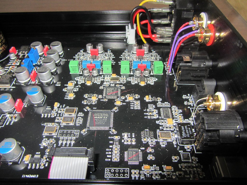

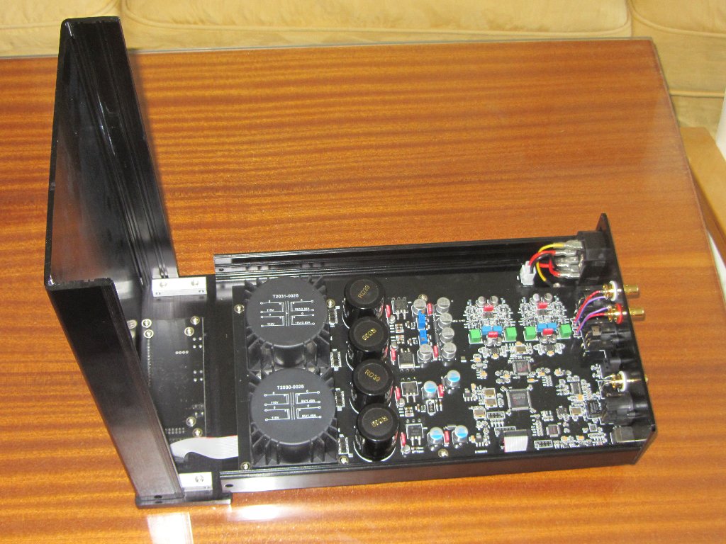

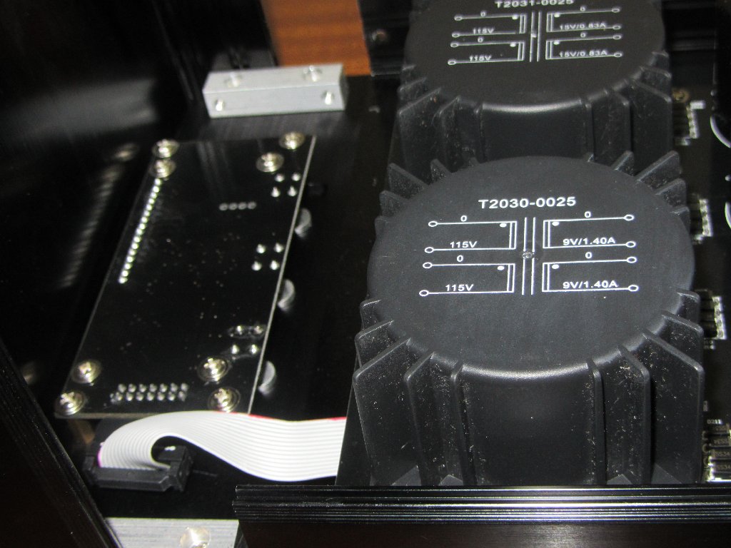

I have opened the dac. Try to measure and see how it is implemented.
Must say it is well done for that money.

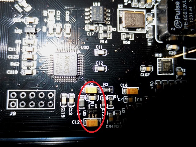

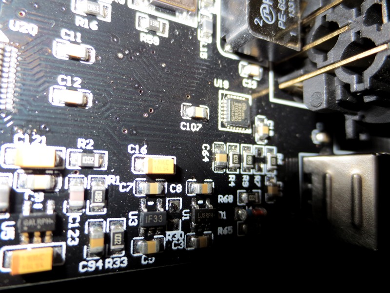

I take a look inside the dac. Xmos is feeded from internall 5v ams3117 preregulator followed adp151 regulators. Only USB3118 transceiver is powered from externall usb 5v. It can be redesigned that is powered from dac but some mods must be done...left one diode out and connect one resistor.
But then the magic of using output supply is out. USB3118 has no regulator so the sound difference can be expected. I also replaced rca for coax input to neutrik 75ohm BNC input because i have bnc cables for spdif.

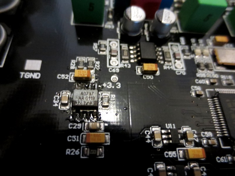

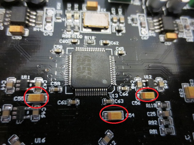

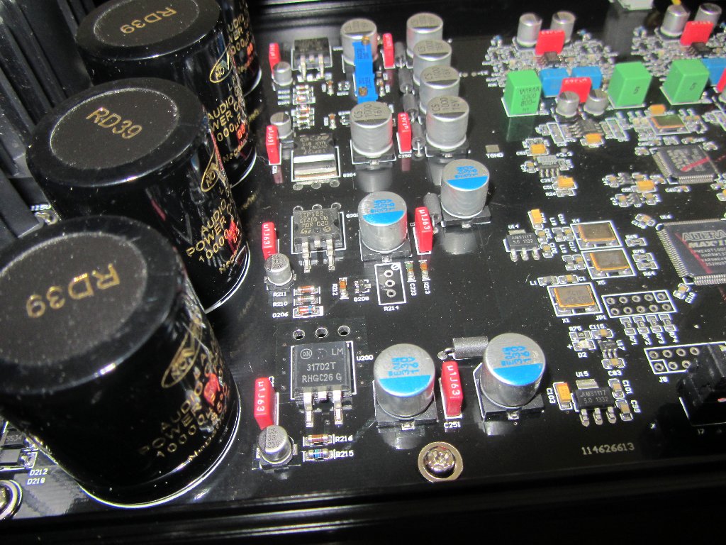

Some mesurement was done. 1 Preregulator oscillated heavy.. the most problematic is regulator U5 GAL RPH i am not sure if it is analog devices. Decoupling solve 95% of ripple, but 10uf ceramics on ams3117 100% defeat ripple but sound becomes harsh, bright ,artiffical, with one for my ears unpleasant musical note that is present all the time at listening... neutrality is gone... simmila as it is powered from external pc (normal usb connection)... I think that ams3117 don*t like ceramics on output.
Measuring all other supplies were clean. I replaced 3 tantals after adp151...for smd panasonic sp cap.
The FINAL question... ADA797 AVCC regulator is, or it is not the best choice-sollution? I tried 100Uf Silmic 2 at output and sound become to hard, I replaced it with 10uf SAL-RPM as Black gate replacement and its ok. A little more sub bass energy and highs have a little more microdetails. Fine.
So members ... any idea or experimenting with ad797.
Have any sense replacing AD797ar with AD797br?
Any sense putting 50pf between pins 6 and 8.
Any sense putting transistor on output?
From datasheet power consumption is about 60mA for AVCCL and AVCCR when clock is 100mhz. And AD797 maximal output is 50mA. When i tuch it is warm, not extremely hot. Voltage is about 3,36V so everything seems good.
